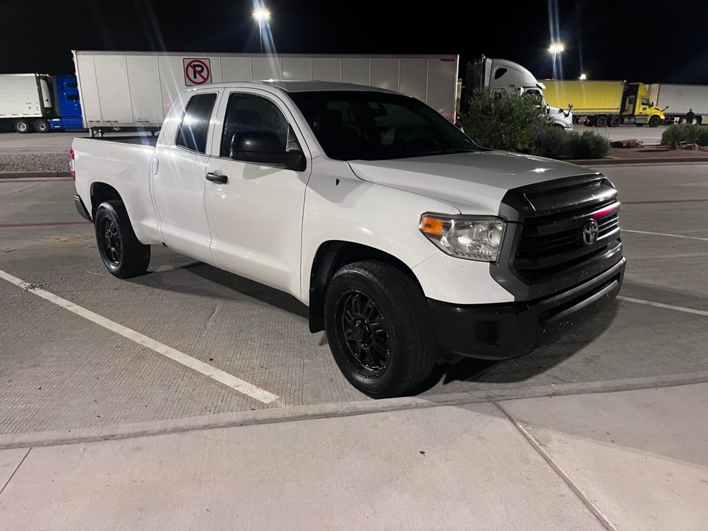

    Hello Everyone,
    I'm new here after buying a total loss 2016 Tundra 4.8L SR in Texas, and driving it home to CA. The truck was rear ended and the seller replaced the bed and tail lights. So far I've replaced a broken brake line, re-clamped the leaf springs, and replaced some tail light wiring.
    I'm hoping this community can help me save money by not needing as much information from the mechanic. Thanks in advance!

    Thank you, Koditten. Awesome that you have the skills to fix these trucks. I do basic repairs to save money (brakes, lights, cylinders...), but I don't have the skills or the space for extensive work. You must be a major contributor to this site because I recognize your name and boat pic from another thread already.
    This truck was rear ended and declared a total loss, but the seller replaced the bed and the truck runs. The mystery I'm trying to solve is a ticking noise that I hear when the truck starts rolling out of the driveway. The ticking is faster with increased speed. Then about 30 seconds after driving, the ABS and Traction Control lights come on, which stops the ticking noise.
    I drove it like this to Yosemite and back, but now that I'm reading more I'm worried about further damaging something. The guy who smogged the truck said he noticed I had a problem with the differential... I feel like I should go back to him and ask what he saw/heard, because I can't see anything unusual while poking my head around underneath.
    The truck is beautiful and rust-free besides a few issues. 100k miles.

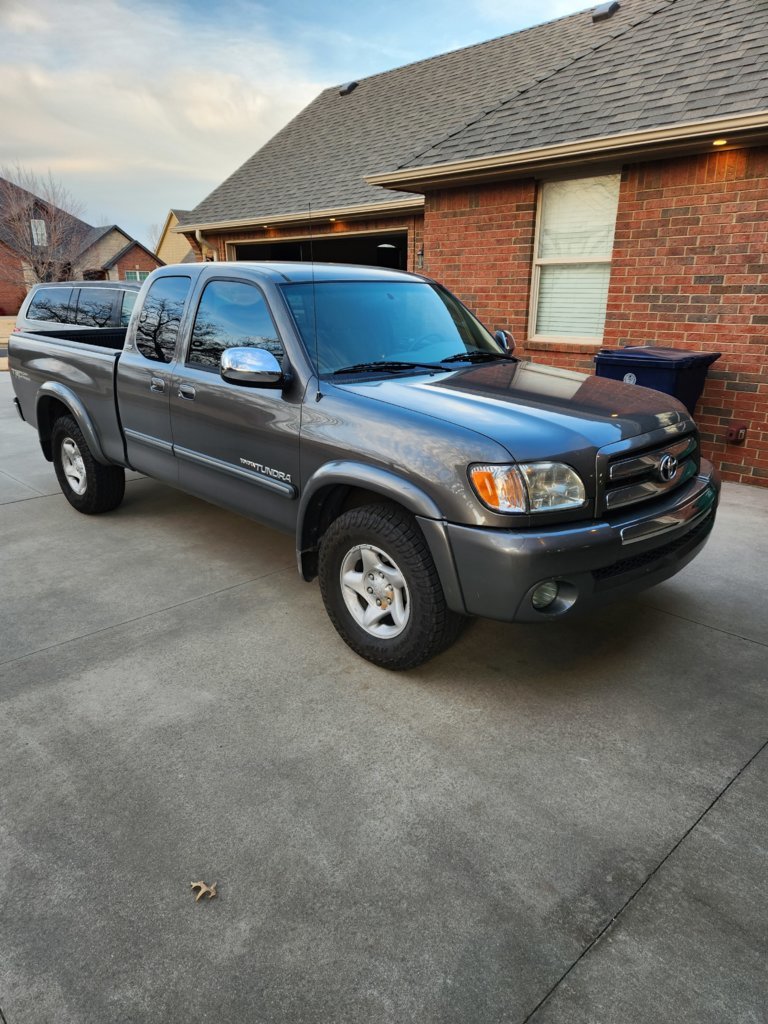

    This is my second rebuild but plan on keeping this one. I carry only liability on these old ones and can park closer to the door at stores and not worry about dings.40140644_Image_4.jpg 20250125_173011.jpg
