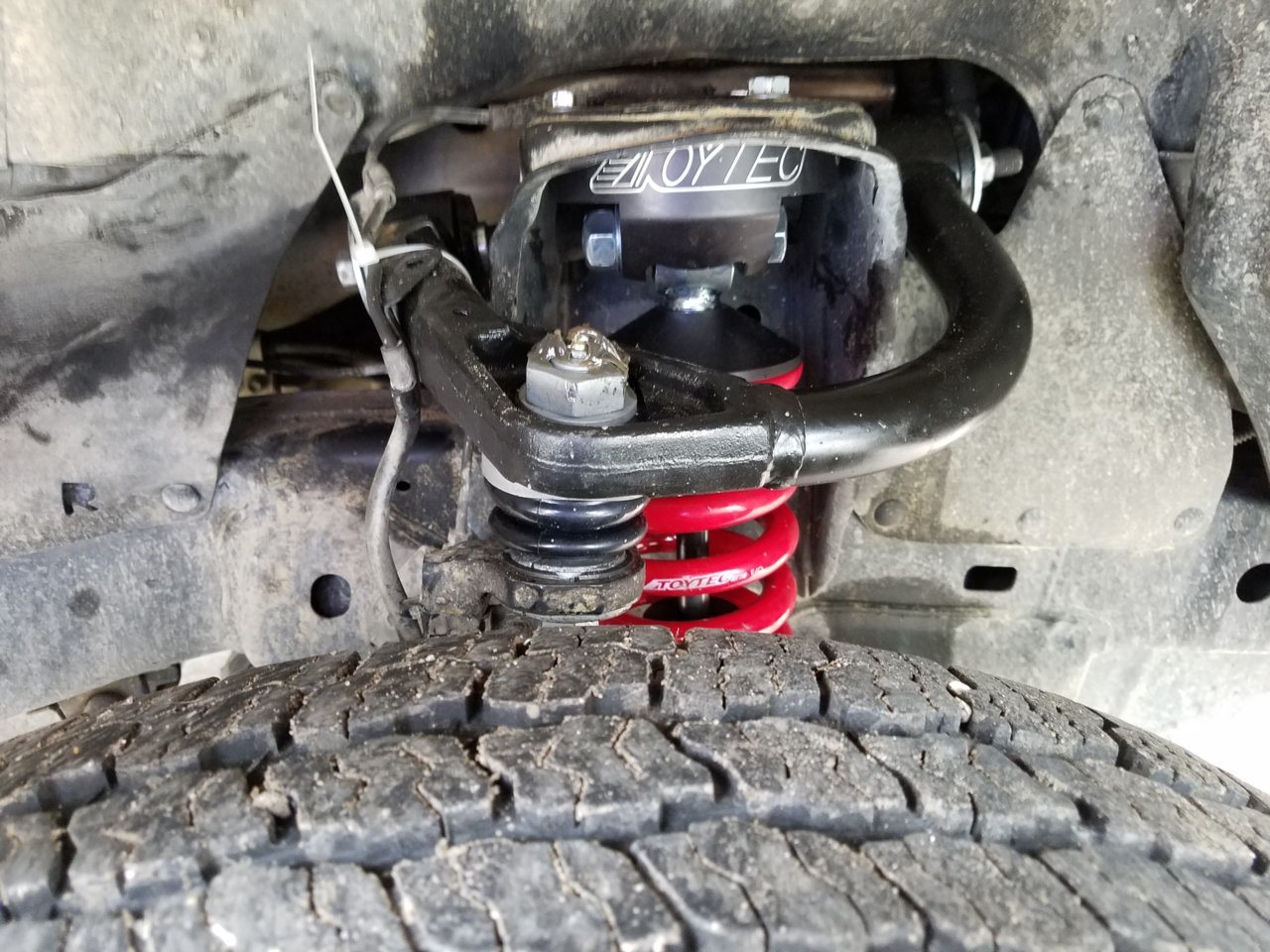

    That's the exact set up I have had on my 06 for the last year. I like it. It did really well the time I took it to the off road park too.
    Don't mind the ziptie, was just temporary to hold the brake line because I misplaced the screw lol
    Btw I would wait til black Friday to buy all this stuff. I bought mine last BF and saved like $300
