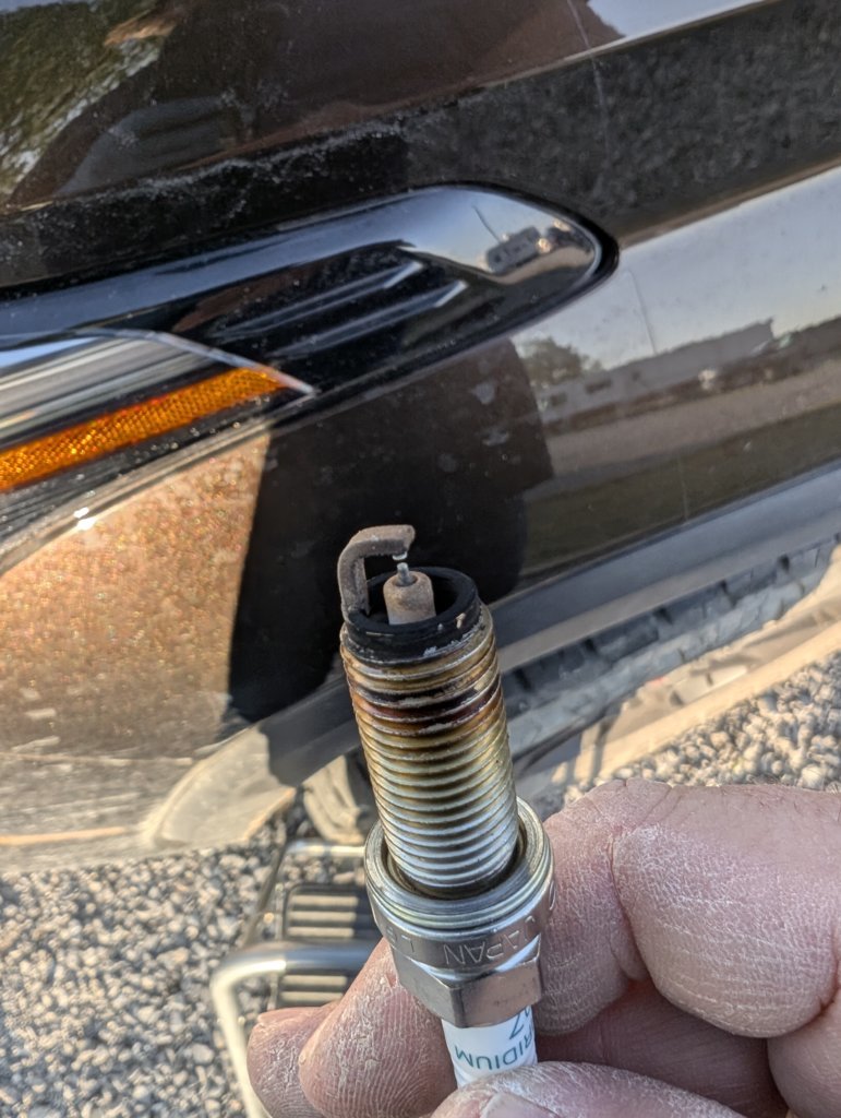

    I changed the plugs last night thinking the same thing and noticed the coolant was way below the low mark ( I look Everytime I change the oil). All the plugs like similar to the one below. After changing the plugs it still doesn't run any better.
    About the coolant, I started/ran the truck today for about 1 min and it had a lot of pressure in the coolant container. I am thinking we got a failed head gasket

    OK, oil isn't milky. Notice white smoke from the exhaust? The coolant has to be going somewhere.
