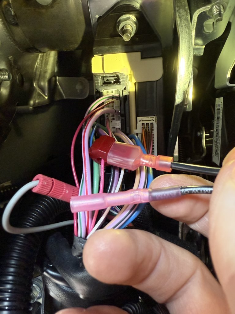

    I recently bought a set of Boost Auto tow mirrors for my 2019 Tundra Limited. I would like to wire the Aux Reverse light for the mirrors into the cargo light switch on the dash. Not sure which wire to tap into. Any help would be appreciated.

    I was able to figure it out. It is a pink wire see the attached photo. I spliced into the wire. The reverse lights now come on when the vehicle is unlocked and can be shut off or turned on by the cargo light switch.

    THANKS for this post!!! I just installed new tow mirrors with reverse lights and wanted it set up just like yours (cargo light switch). Install went great. Everything was just plug and play. But.... I could not find the cargo light wire to tap. I searched the internet all over and finally came across your post on this forum. Many videos out there, but none had the correct wire location or color for my Tundra. I am surprised at the differences in wiring harnesses just from 1 year to the next. I found videos for 2017, 18, 19, 20. All different. If I had only come here first!
