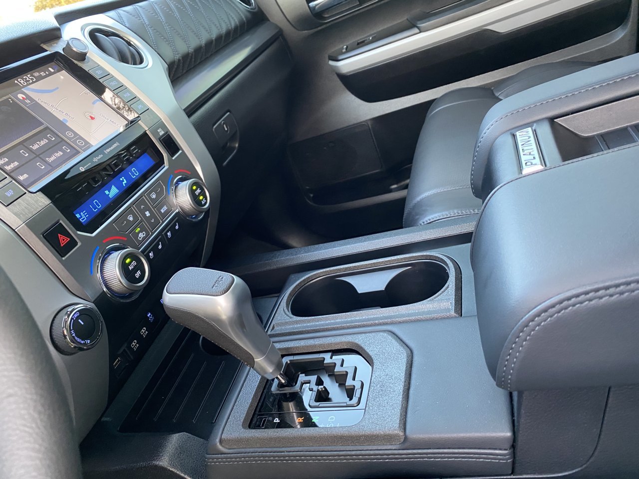

    Center console chrome delete..Started off painting the cup holder with color match silver paint but it was clear it was not going to last. Like a couple other guys on the forum, I opted for the rattle cancan Dupli-Color bed liner cover. Matches well and very durable! I didn’t have the balls to drill out the plastic welds on the shift gate so I used the AJT Design shift gate cover.

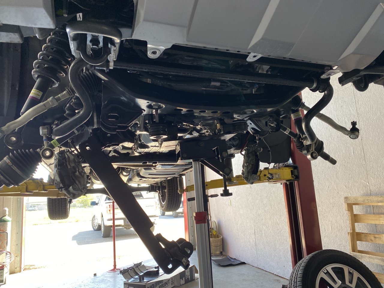

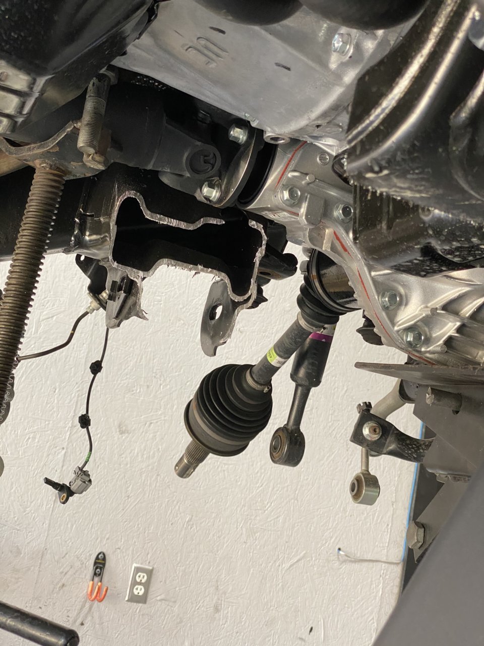

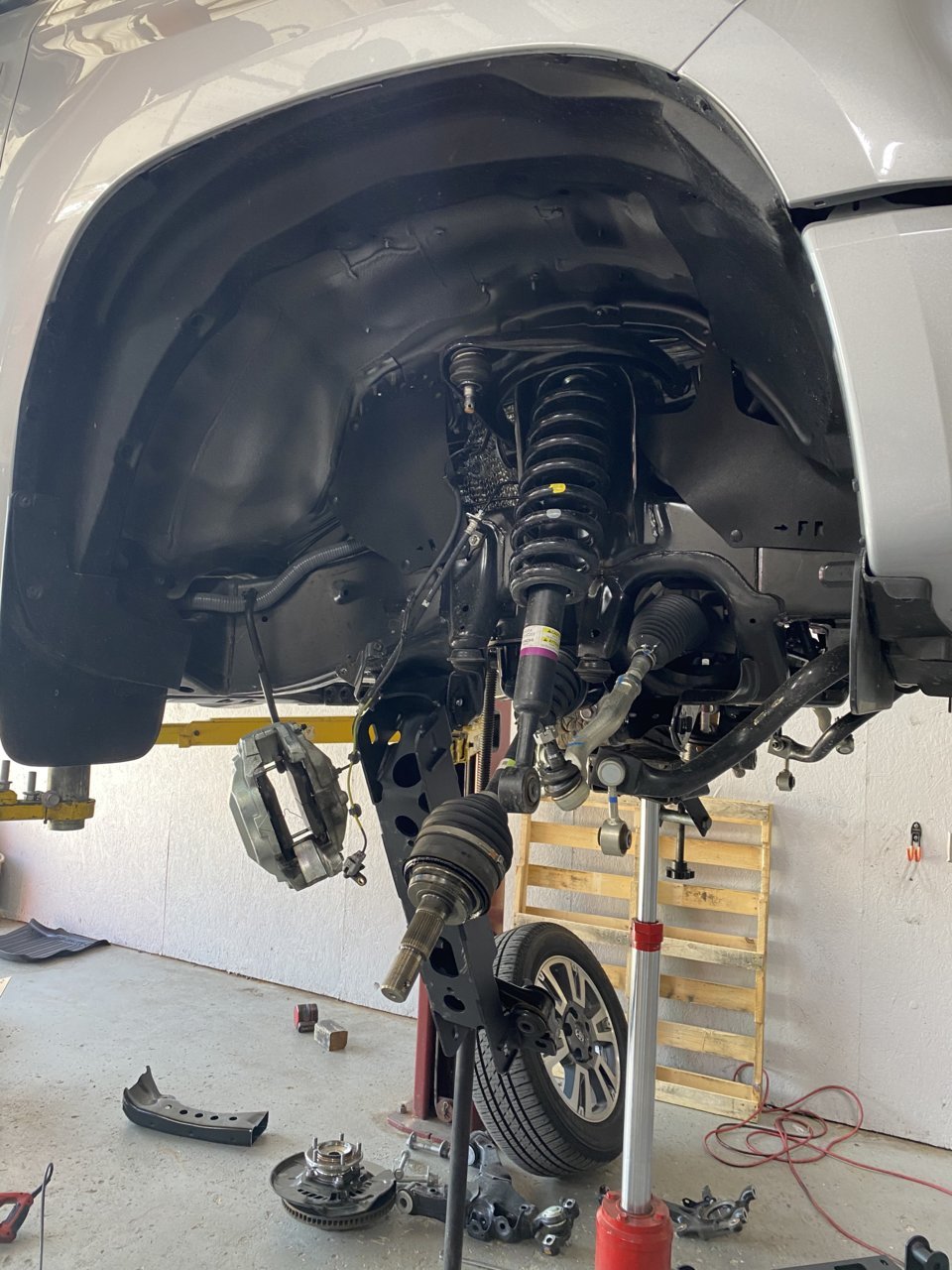

    This Wednesday 10-7, I had my boys at AllOut off-road in Stafford, TX install a 4.5” BDS Lift, Non Coil Over (For Now), Amp research running boards, 20x9 Fuel Trophy Wheels with a +1 offset, 35x12.5r20 BFG Ko2s and a Hyper Tech spedo Cal. They also did a carrier Bering drop. Need to take it back so they can do a Body Mount Chop because its just barley rubbing at full lock.
    Here are some shots of the instal. Can’t say I was not uneasy when they cut the cross member :eek2::eek2::eek2::eek2:

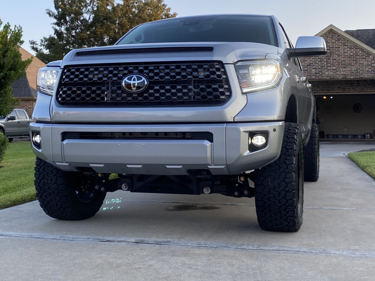

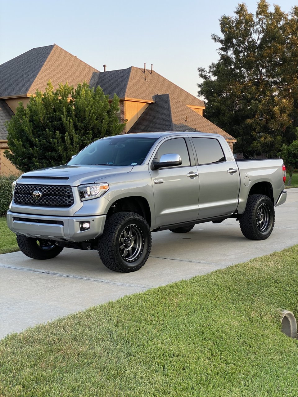

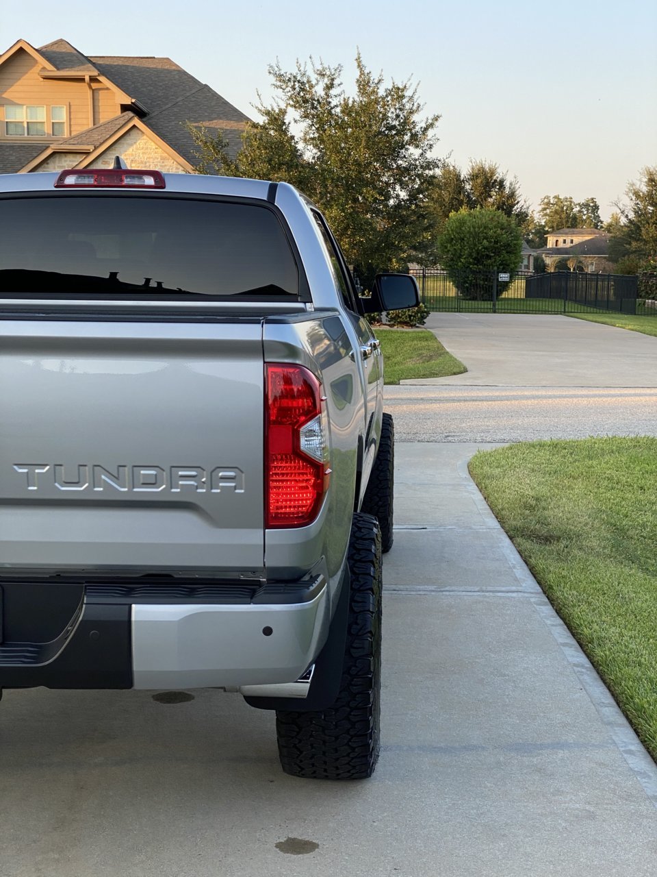

    Me and my boy spent the day cleaning the truck up today after the lift. I’m really happy with the results!
