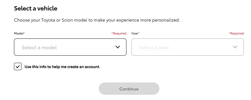

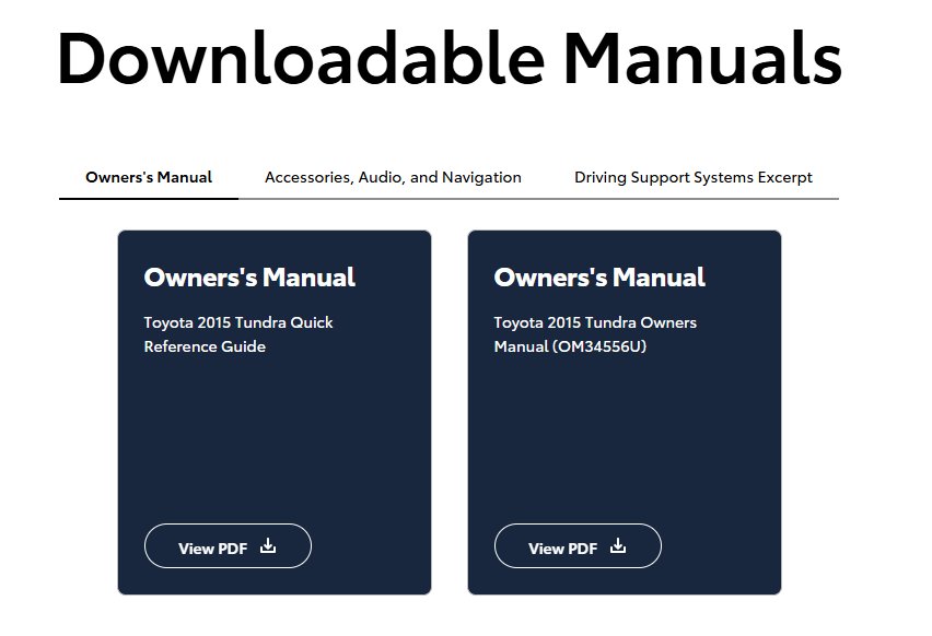

    Thank you il remember that. And I was looking for it but I guess the previous owner lost it as I couldn’t find it anywhere.

    Should be available online, from the dealership, or in the Toyota app if your vehicle is new enough.

    Oh didn’t think of that, il look it up online. I just got this 2015 TRD pro like a couple days ago lol
