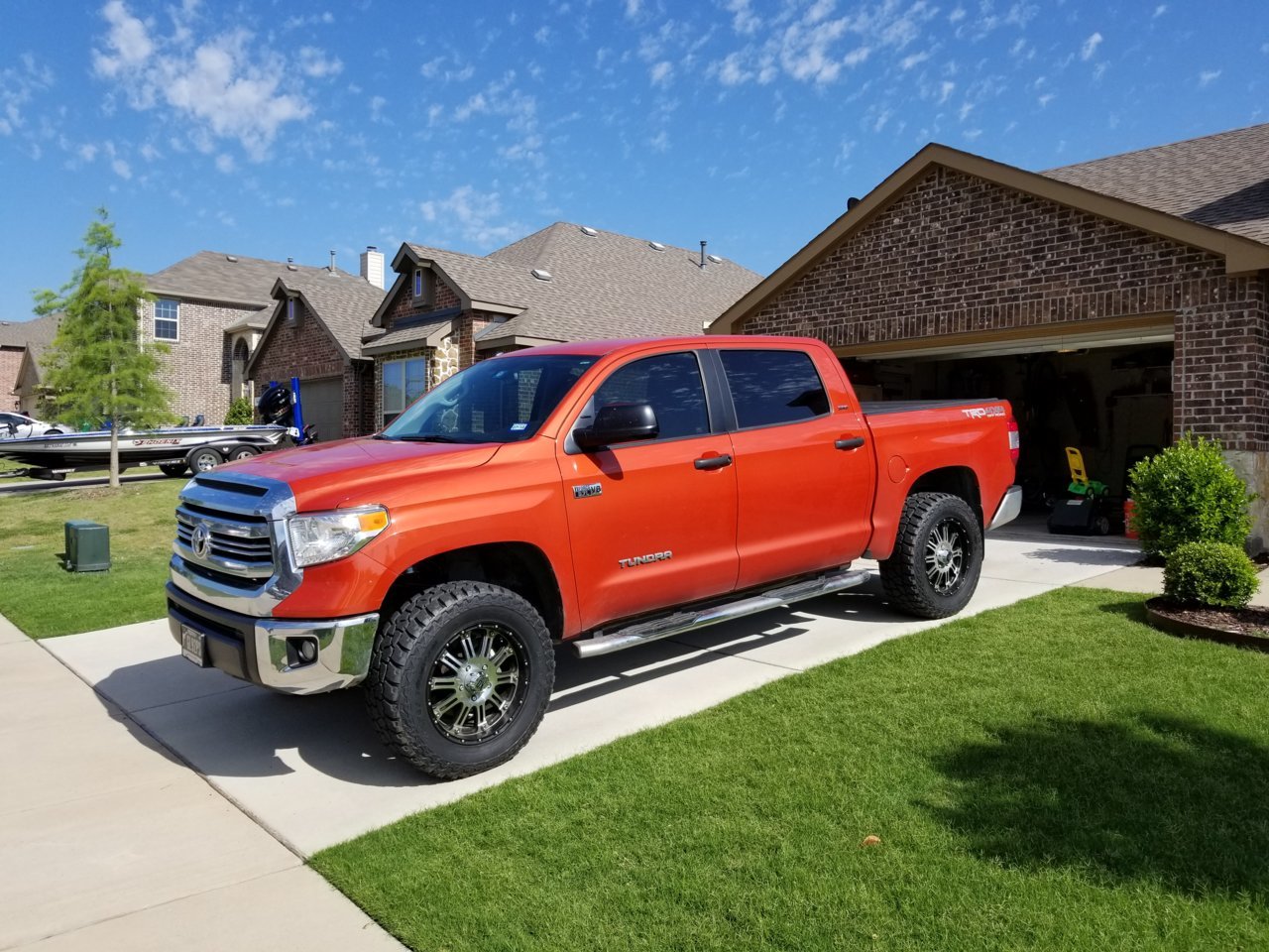

    Turns out I wont need one with the 30mm offset. Just some typical wheel well trimming and skid plate trimming.

    You have any pics of the tires clearance?
