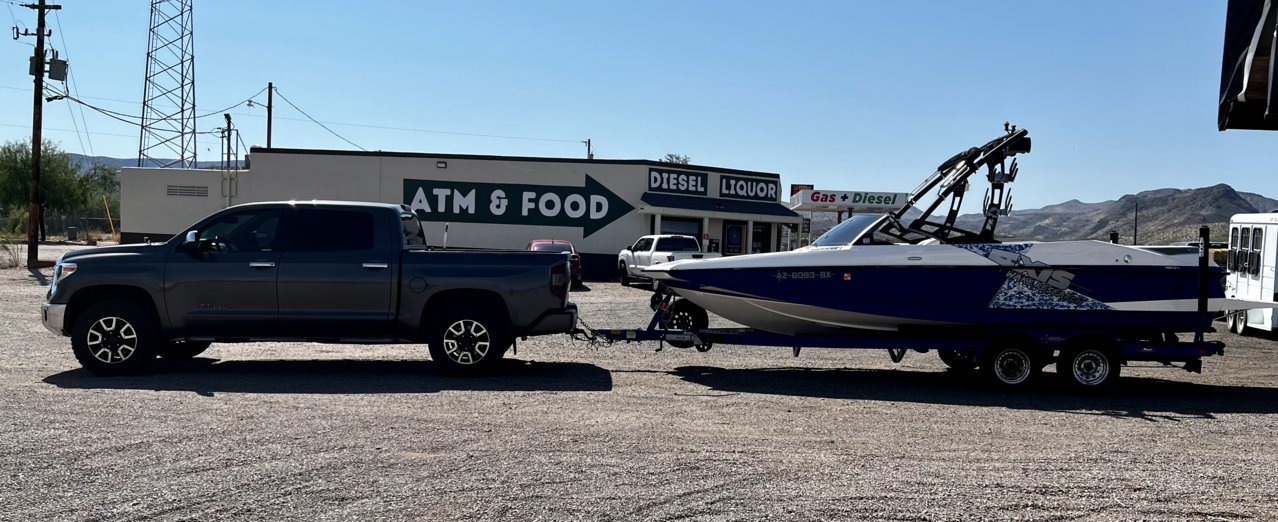

    I’m shocked if it is really that heavy. I’m towing a 22’ wake boat and am about 6,000-6,500 loaded on trailer.
    FWIW, I see a Tundra towing a X46 all the time at my lake and it doesn’t seem overloaded or struggling.
    ETA the tongue weight on the big wake boats is usually under 10% so they don’t seem to squat nearly as bad as other trailers. A big v8 hanging behind the axles helps.

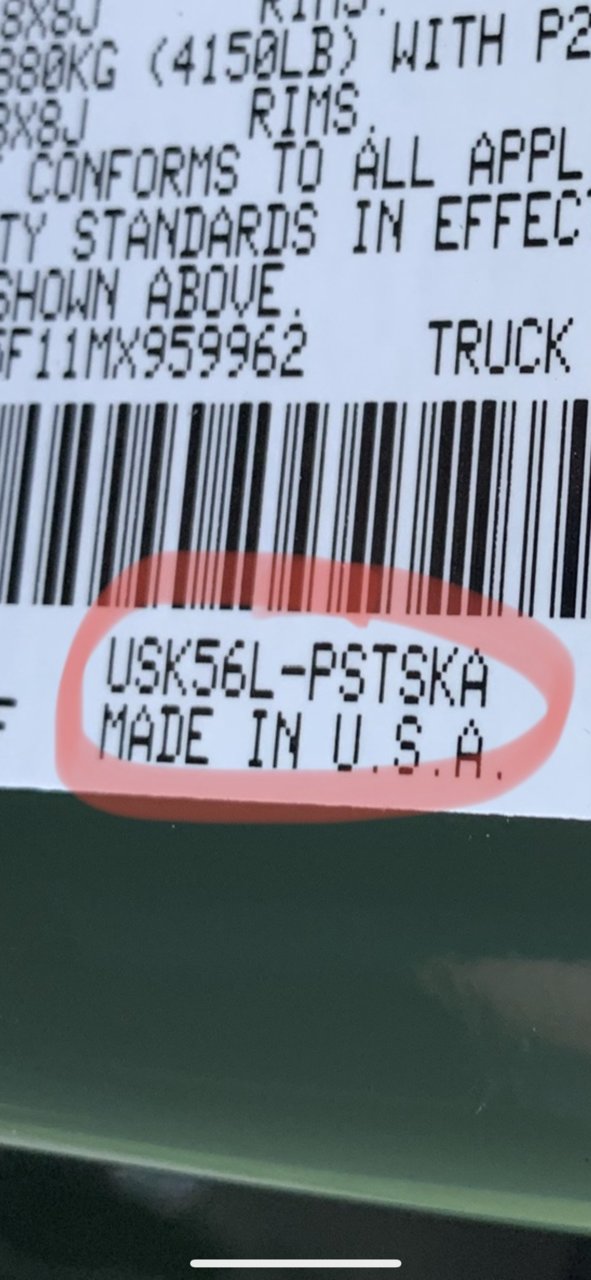

    Yeah but his boat is a legit yacht. 26’ I believe. Assuming his tundra is 7200 lb GVWR, a boat GWR of 9600 puts his GCWR at 16800, which is prob 1000lb north of what his truck is rated for. I’m over a bit at times but not that much.
    I might do it until I figured something else out. But I would definitely upgrade brakes and rear suspension.
    @nobodyintexas check your manual for your truck’s code. It’s on the door jamb on the black and white sticker. Then look at your GCWR for what your truck code is. These are listed in the manual. This is the code you’d be lookin for:

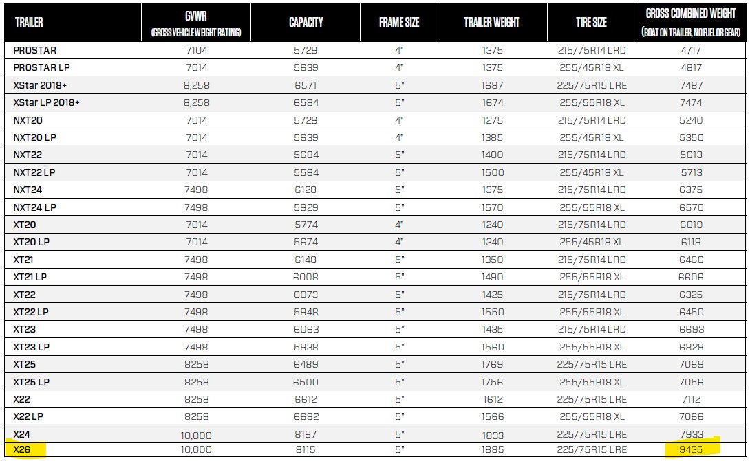

    yikes...just found this....I don't think I'll be risking it.
    and it has a 108 gallon gas tank! and all our gear.
    easily approaching 10k lbs

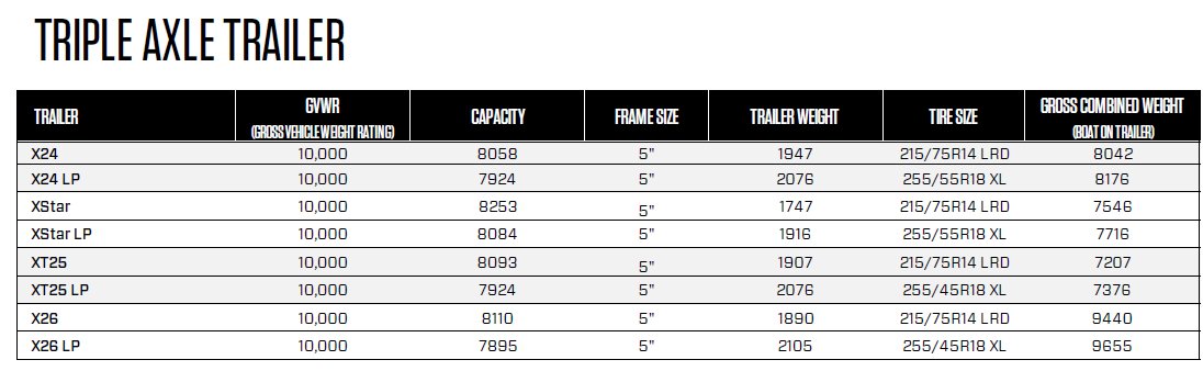

    That’s probably with a triple axle trailer but still…

    They show the triple axle weighing a whole 5 lbs more than the double…
