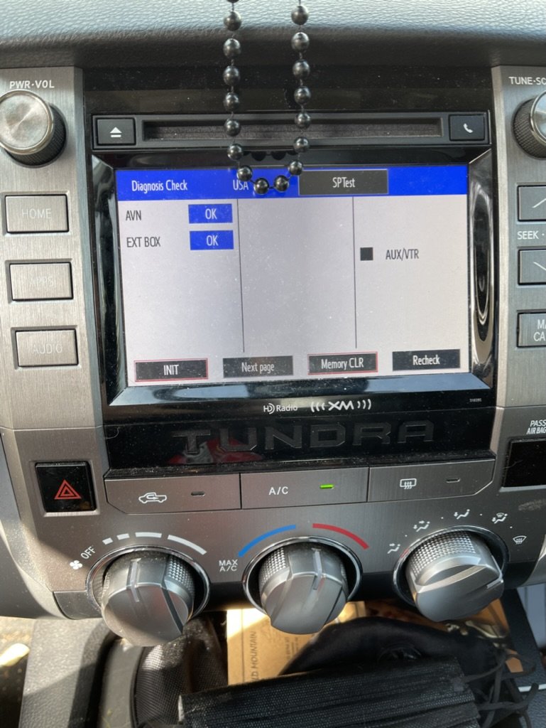

    ok so, if you hold the apps button down and turn the light stitch on and off three or 4 times, it goes into this mode and offers INIT as an option, I did that and was able to talk on the phone nonstop for 20 mins and then later in the evening for 27 mins without the tundra radio losing its connection to the phone. I still don't know if its cleared the default connect to my phone first thing or not as it is the only one connected right now... so well will see on that -- ill update more as I find out more...upload_2022-2-22_0-15-11.jpg

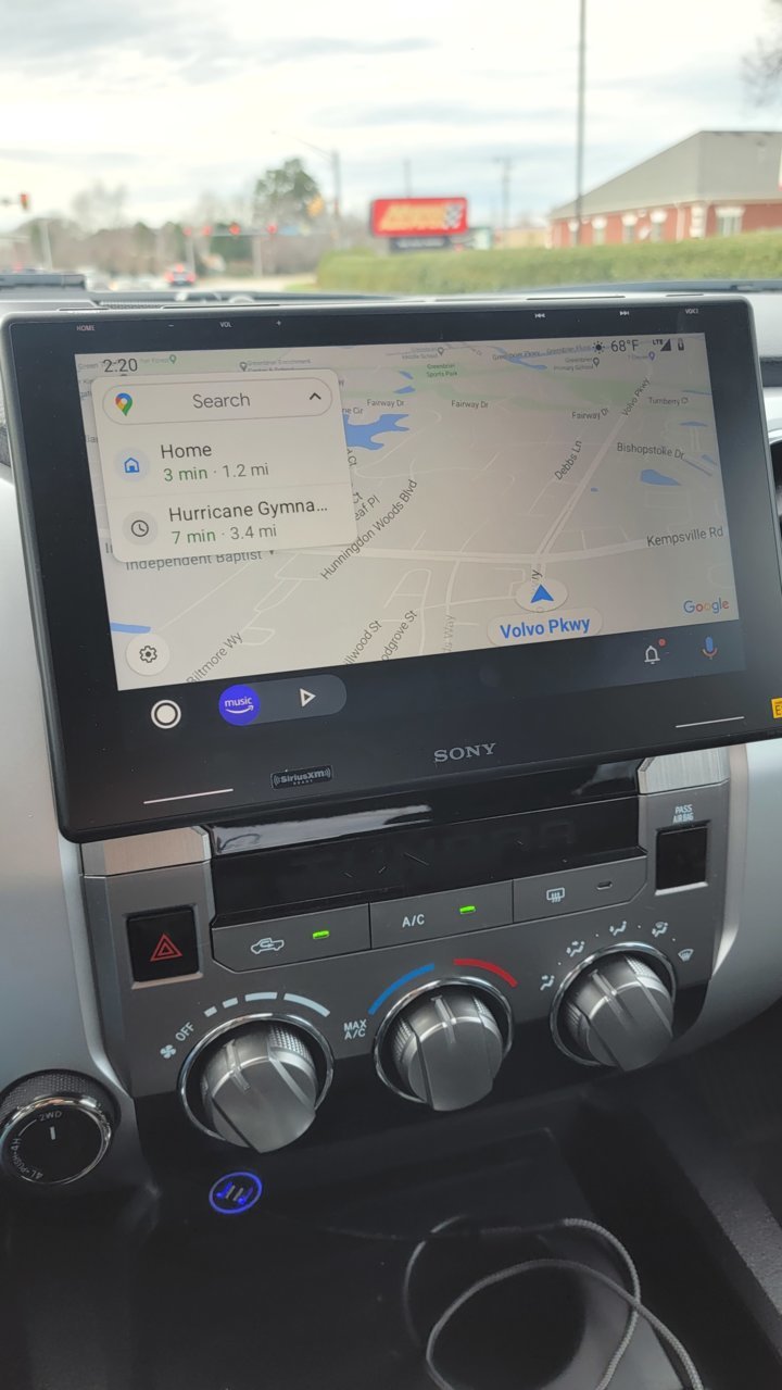

    Short build RC 6inch. Bilsteins B8 8125 coilovers, KMC FMJ 20×10 0 offset Nitto M/t 37x12.50r20 SSbuilt Front bumper inferno powder match Dirty Deeds 6inch KnN cold'ish Baja Design Squadron Pro flush, Diode Dynamics SS2 fogs Opt7 rock lights Aux Beam 6 gang switch Throttle Commander Tyger step boards Tyger 5.5 trifold bed cover
    This is the biggest reason I got so fed up with the Factory Toyota Entunes head unit and pulled the trigger on the New Sony xav-9500es.
    My phone, Samsung S21 Ultra.
    While making phone calls at random points in time usually around 5 mins in it would disconnect bluetooth, drop the call then reboot. But Bluetooth music would be just fine no issues. Only during phone calls.
    My wife has a 21 Sequoia and had the S21 Ultra, we fought and fought with the Toyota, Samsung, and Verizon over this issue. All of them pointing their fingers at one another. Toyota dealer said they can not duplicate in either vehicle, even provided video proof of issue from both trucks. Wife went through 4 different S21 Ultras from Samsung and Verizon. Toyota replaced (so they say) the head unit. The head unit still had her map history and saved destinations. She ended up down grading to the Note 20 and has been better since but does it every now and then.
    A local Tundra Facebook page I'm on, a couple of the people in the group have experienced the same things with the Note 20, S21s and iPhone 13s. Come to find out the new Bluetooth protocols were implemented in these phones and the outdated factory headunits have issues with that.
    So it was either a $1600 new phone or $1600 set up. Oh and Bluetooth in my daughter's '21 Highlander works just fine with the same phones so...
    This is a Toyota issue not keeping up with S/w I ended up Purchasing the Sony xav9500es. See that thread for more info on that unit.

    The init seems to have fixed it.. I’ve talked over an hour without dropping a call
