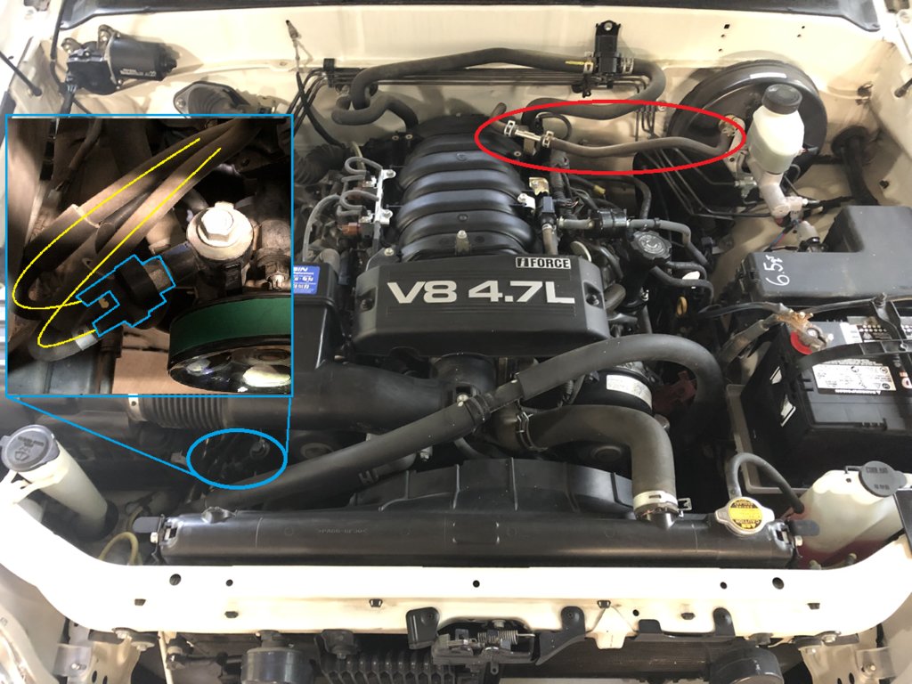

    I honestly think we should have a process to follow for this "smoke at startup only" situation.
    To date, from what I've seen during my ownership and participation here, it seems like the two big sources for fluids are the brake booster and the power steering air control valve with the latter of those two being more prevalent (test process here, and more info on correct vacuum hose routing for earlier vehicles here, but read on!)
    Though there was one (or possibly two) folks who had injector-related issues (o-ring or other seal issue, or failed injector) causing a slow leak into one cylinder if left to sit overnight or longer, there are the "big two" which are pretty easy to check, looking for fluid and vacuum hose issues on these.
    Obviously others may differ in appearance from what I'm showing here because I'm '05+ year, not '04 and lower, but generally speaking, two things:
    1. The PS air control valve will be where the blue circle is, a bunny-eared looking thing, with two vacuum hoses coming off,
    2. Vacuum line from the brake booster to the top-end of the engine somewhere, obviously the red circle.
    You should be checking both for clear signs of fluid being sucked up into the hoses on all three hoses (two to the PS valve, one for the brake booster) before you really start digging into other stuff, and verify the hoses are routed correctly, and they're not cracked/broken.
    NOTE: Vacuum hoses and their routing look slightly different from 00-04 than the 05-06. Showing 05-06 in this picture. For 00-04, see the link above, you have one line from a metal tube on top of the manifold down to one port of the valve, and one from the other port of the valve up to the intake box, passenger side.
    And of course, when in doubt, a compression+leakdown test may tell you if you've got a blow-by or head gasket situation, but lack of compression on one or more cylinders DOES NOT indicate your head, it's gasket, or other major stuff is fucked. Stuck valves will cause bad compression numbers, as will bad timing.

    Wow that was some awesome stuff. I haven't started doing my investigation yet but I did pop the hood this morning to check the oil level (right where I last saw it) and remembered to look at the two air hoses that run to the PS and so far I didn't see any fluid in either hose. I did forget about the brake booster hose but I'll check that later today.
    Another quick update on the blue smoke level, today there was none that I could see. This would be the third start since I replaced my PCV. As a refresher, I pulled the PCV when I changed my oil last Wednesday. The old one l, which I replaced with an aftermarket one last year or so, still rattled, albeit muffled and gummy compared to the new Toyota one I replaced it with. It also had a lot of oil inside both the PCV and the PCV hose. Since replacing it I had some big smoke the morning after, much reduced smoke the following cold start, ending with today with no smoke that I could see. I will still do my inspection later and keep an eye on the smoke but that's been my observations thus far.
    As per shifty's and others recommendations, I still need to check the brake booster line and spark plugs
