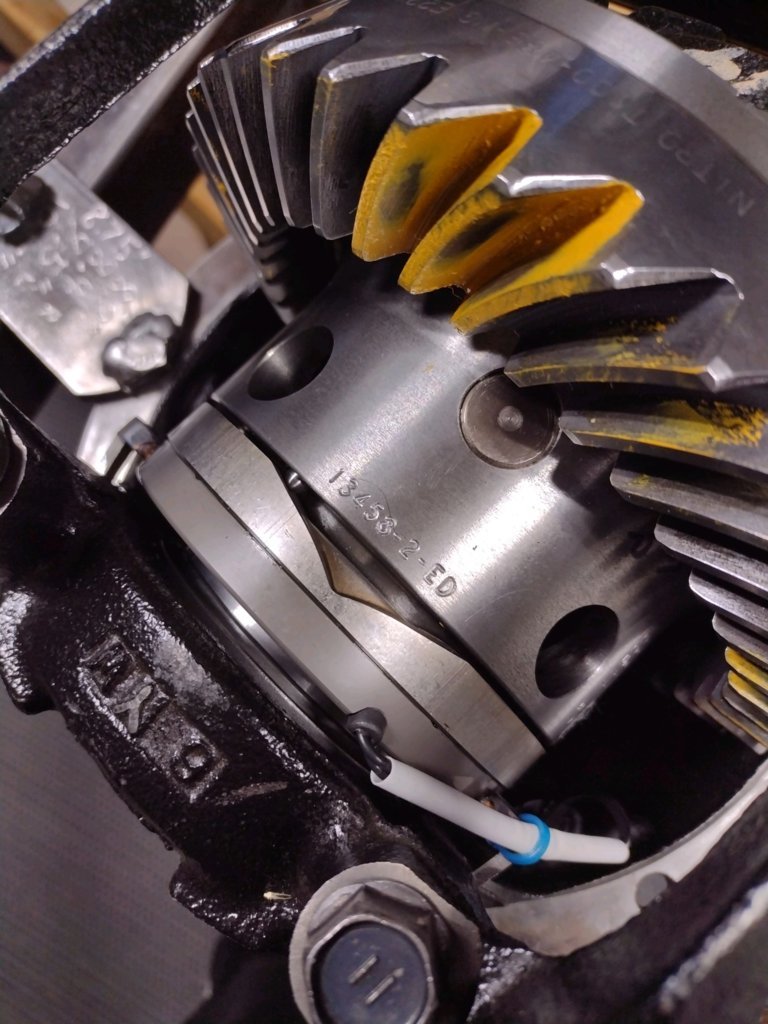

    Son towed my truck back with the gears looking like this.

    The spider gears are know to fail on our 8.4 3rd member. Once they start stripping out, it will cause collateral damage to the R&P gears. Performing a one wheel burnout puts quite a bit of load on spider gears. Spider gears in general weren’t designed for that kind of long term abuse.

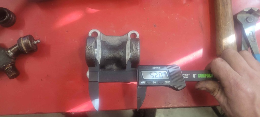

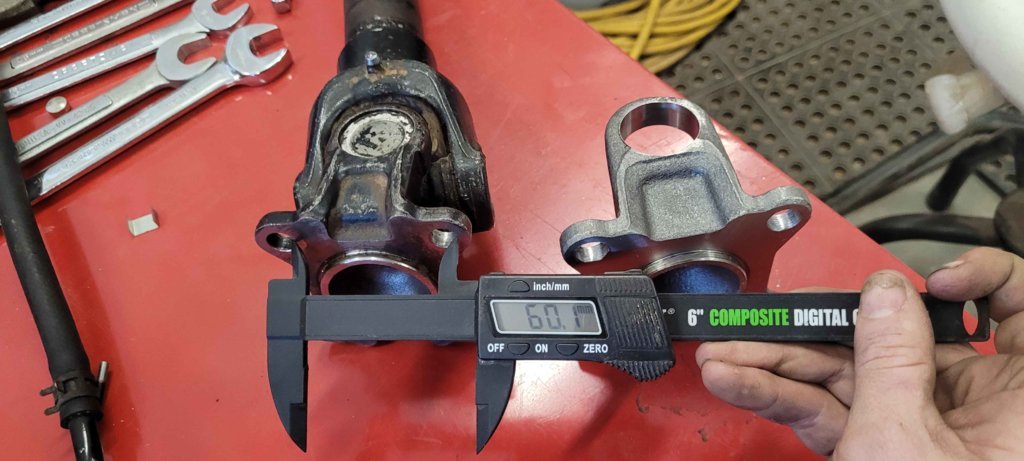

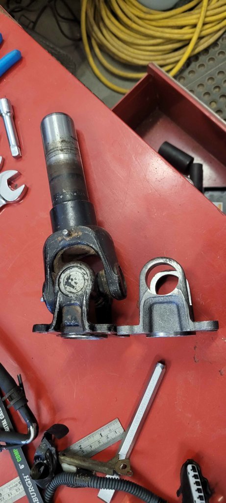

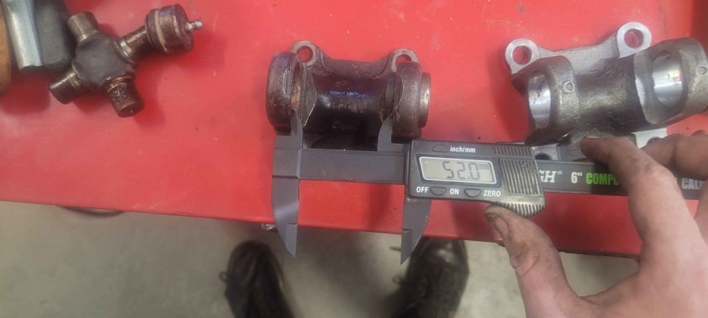

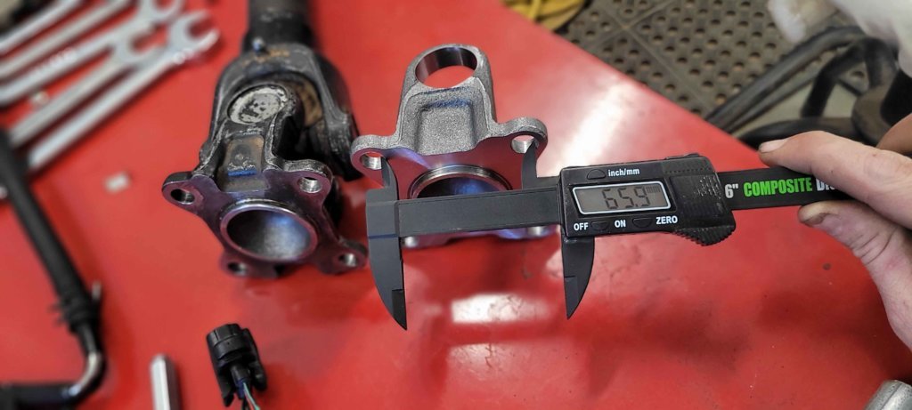

    4WD can also pull the slip yoke, driveshaft flange yoke, and u-joint and order the correct pattern driveshaft flange yoke, that's what I ended up doing.
    I couldn't find a part number for 2WD flange yokes, but they probably exist for some other Toyota application. 2WD/4WD flange yokes are different since 4WD uses 1510 series u-joints and 2WD uses 1310 series. Bearing caps and distance between snap rings are different between the two joints, so 4WD flange yokes aren't compatible on 2WD.
    37315-0K010 - 4WD 66x66mm flange yoke
    37315-35070 - 4WD 60x60mm flange yoke
    (I was lazy with the caliper when taking measurements, wasn't trying to get them precise in the pictures)
