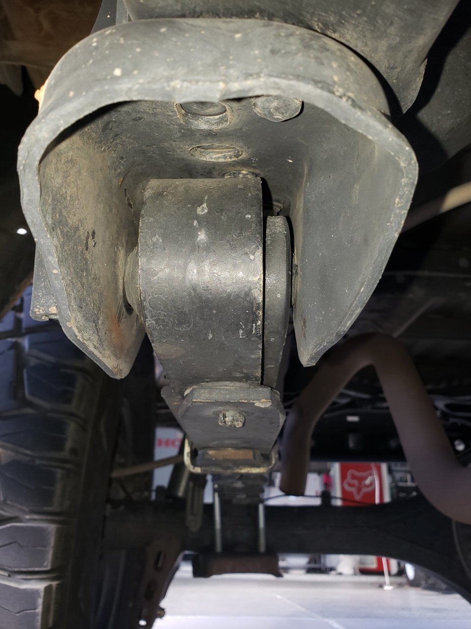

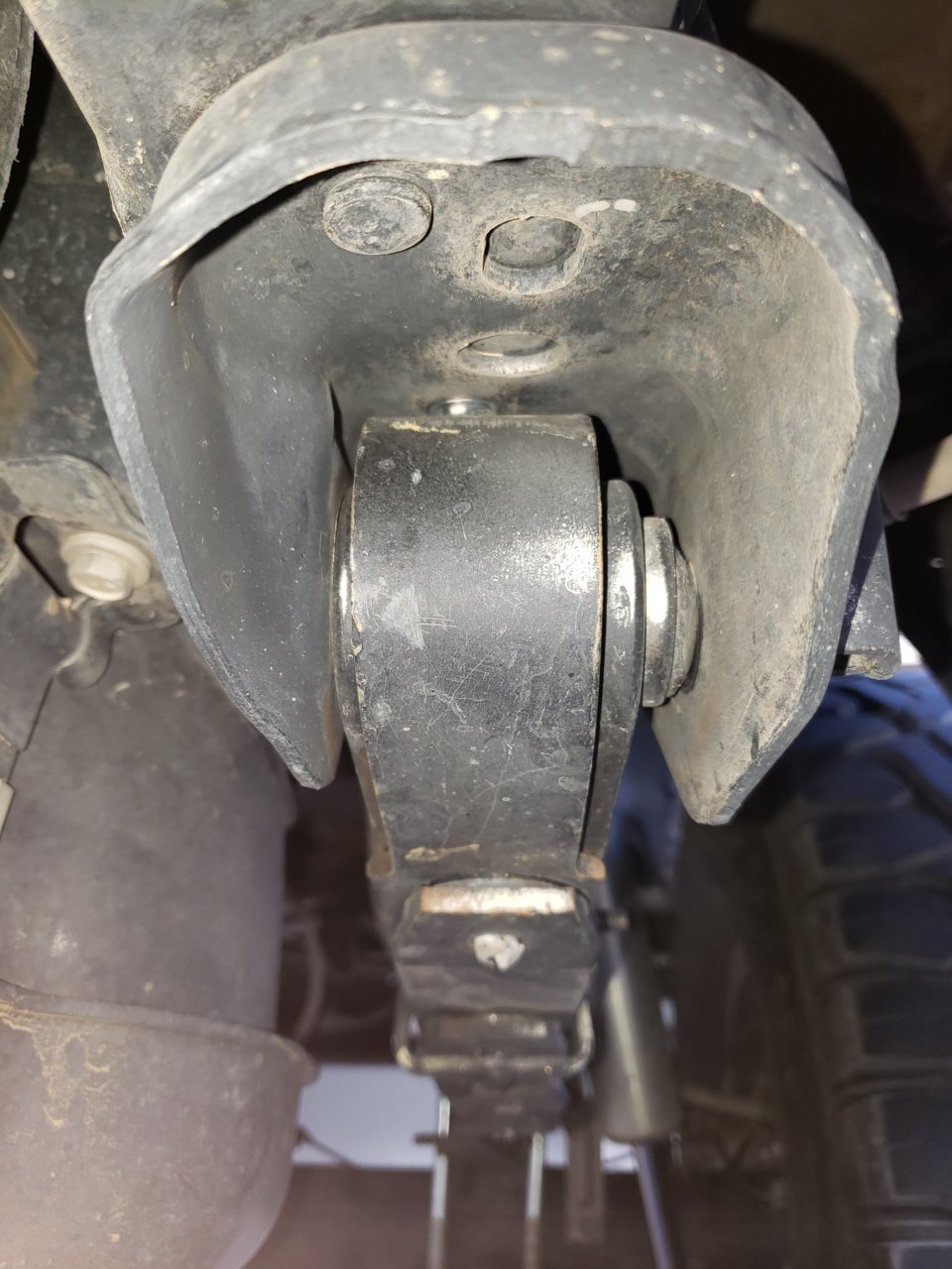

    Hey guys,
    Four months ago I was stoked to install my newly purchased RXT leafs and after a big ordeal of replacing missing parts due to poor packaging I finally had them on.
    A couple of weeks ago I noticed an occasional slight grinding/squeaking sound coming from the drivers side rear suspension. It has slowly progressed to a constant sound occuring on every bump and is loud enough to hear inside the cab at anything less than freeway speeds.
    Second time under the truck today and I noticed the front bushings look like they have failed and are no longer centering the leaf pack. (Pictures are from the front of the truck looking rearward at the leaf pack mount)
    Drivers side: Left side of leaf spring is rubbing inside of frame mount
    Passenger side: Right side is nearly rubbing the inside of frame mount
    Anyone else come across an issue with these leaf springs so quickly? Pretty disappointed that less than four months from install they are creating issues. I wasn't able to get any help from Icon over the phone so I emailed them pictures and am waiting for a response.

    I'm not sure about the bushings themselves so hopefully someone else can pipe up and help out on the front ones. You put the correct leaf spring on the correct side, right? Also, did you replace the bushing or reuse the stock one?

    According to Icons install instructions they are not driver or passenger side specific and there are no markings on the leafs themselves

    Gotcha..... and did you reuse the factory bushings?

    No they are the bushings that come pre- installed in the Icon leaf pack, hency my frustration at them lasting less than 4 months.

    My first thought was of upgrading to some better poly bushings but apparently the front bushings aren't replaceable on these leaf packs by design and nobody offers kits. It looks like it would take some custom bushings and creative removal of the ones currently installed.

    According to the local tundra/tacoma shop Icon's wrap around eylet isn't conducive to replacing the bushings. Not to mention the sourcing/making of a specific bushing .
    They didn't say it couldn't be done, just that warranty should be persued before going that route.

    Yeah I'm convinced this was a bad batch. I've read about dirt building up between the leafs and friction pads causing some squeaks so might try washing them out first.

    Icon has warrantied both leaf packs and is shipping new ones to my door. Glad they didn't ship new bushings and make me deal with removal/reinstallation. I'll update when the new sets are installed.
