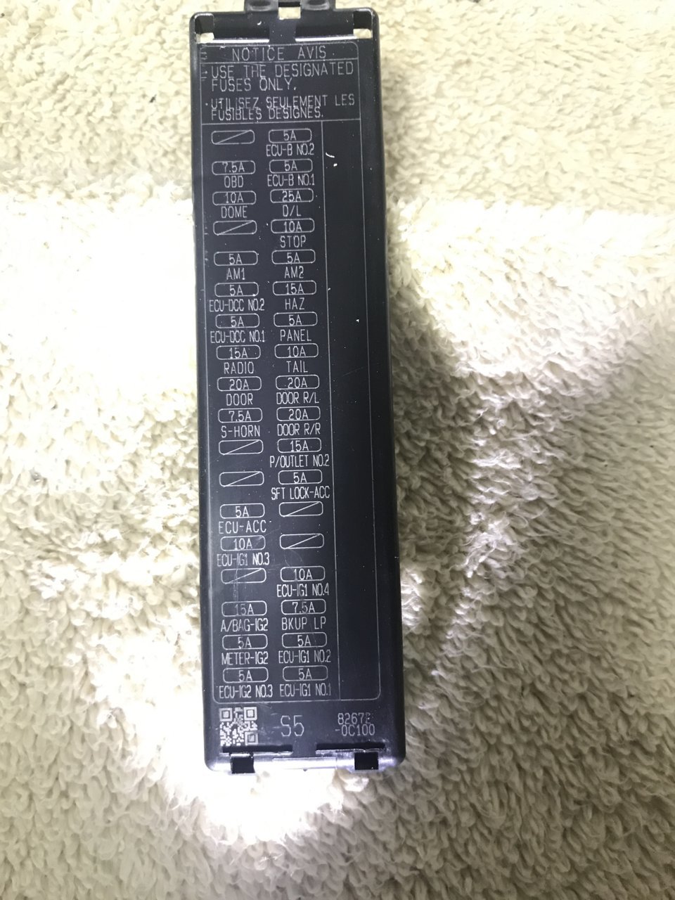

    Can anyone tell me what fuse goes to the two 12v plugs on center console. I was checking the wires for power and my test light sparked. Now neither 12v outlet has power. Can’t find with fuse that goes with those outlets. Any help is appreciated. Thanks

    P/outlet 2 on the right side maybe?

    I know there's a relay in the engine bay related to those outlets, but I don't remember if there's a fuse too. I can check in a little bit if you don't get it figured out.

    Found it. Power outlet 1. Under the fuse box.
