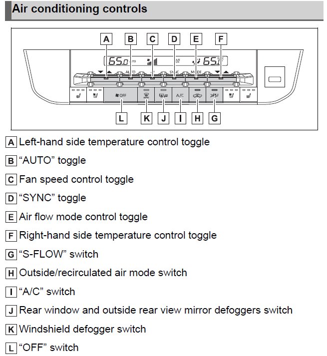

    Try toggling button "G" to disable the S-Flow.
