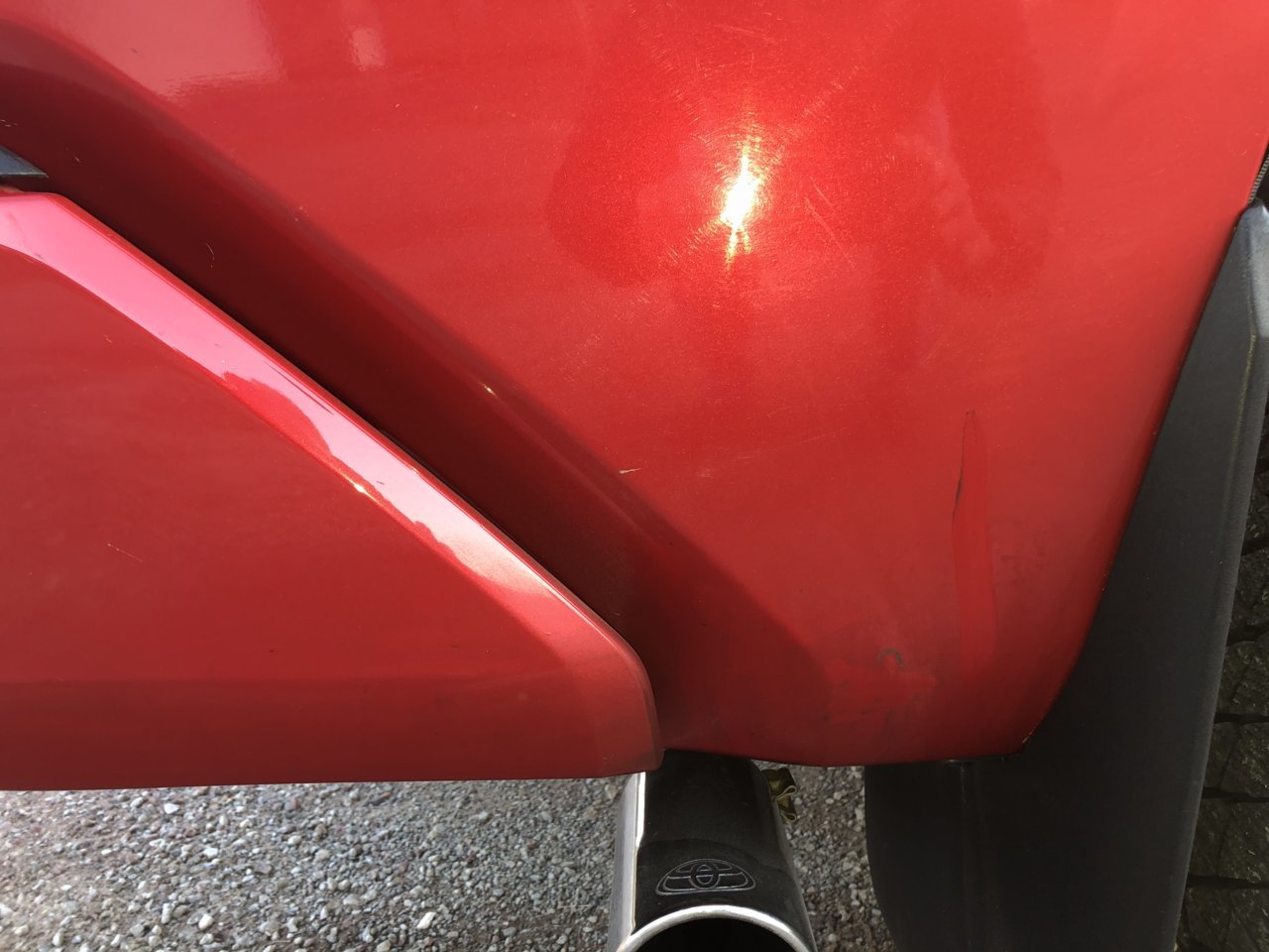

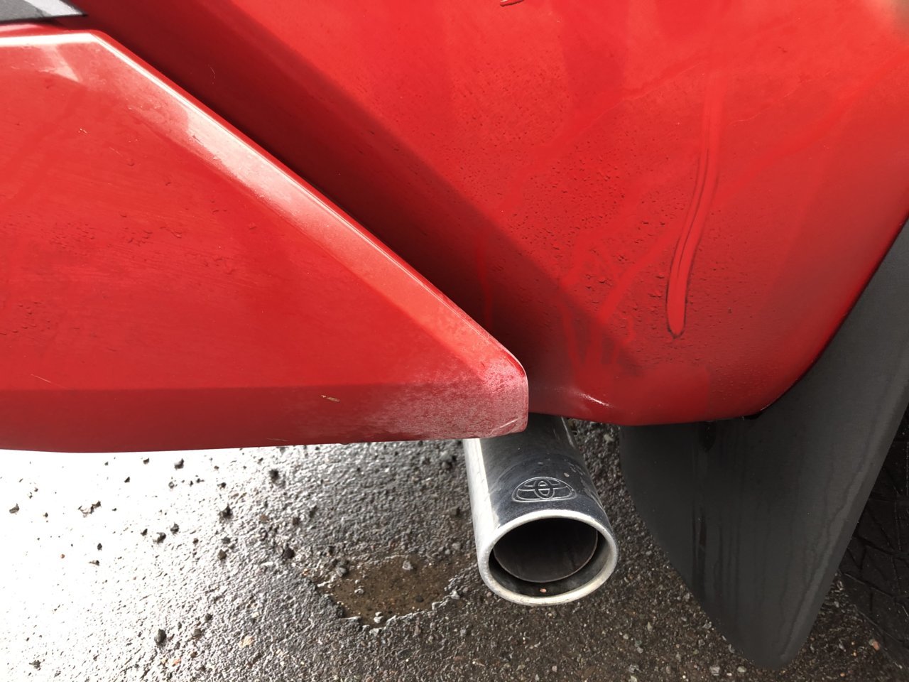

    IMG_1551.jpg black soot around the whole backend of the truck from the exhaust. no codes runs fine, starts normal. dealer looked at it and tested for alcohol levels in the fuel. 11%-12%. this all started after the sensor for parking was replaced. drive to the dealer is 90 miles. filled the tank with 87 from the holiday station. black soot was still there but a little less. washed the truck the next day and black soot is still there but not as bad. I only drove 12 miles after the wash. this morning I have the soot on the bumper and quarter panel 3 mile drive to work.

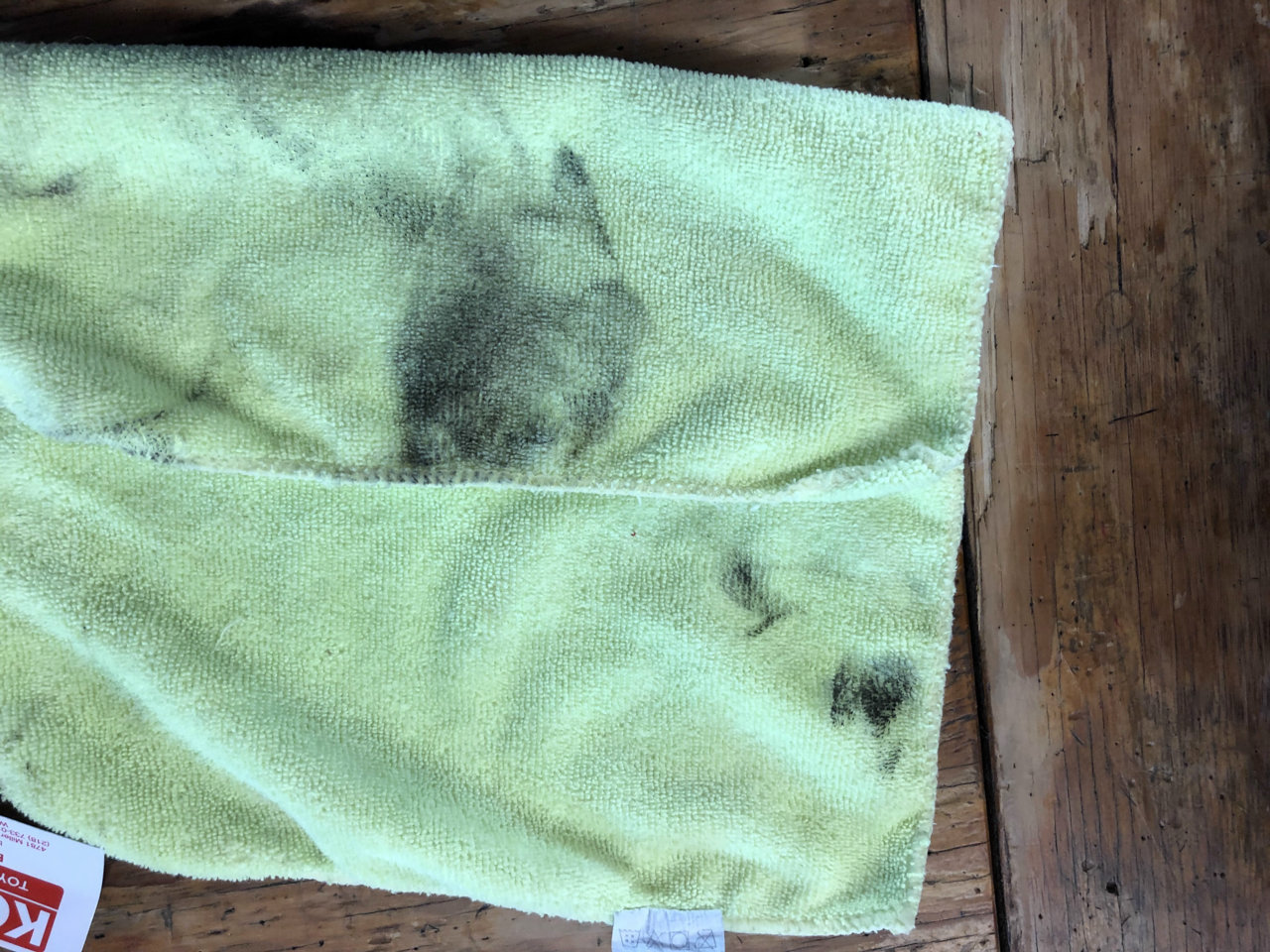

    IMG_1550.jpg this is the drivers side after 15 miles

    My truck does this too. The bumper is chrome and it looks permanently stained. As for the paint next to it, MGM hides everything so no one will know. I think it's from the swirling air behind the tire/mudflap letting it get up there.
    Ethanol doesn't cause it although it might move it from inside the pipe out to the flat surfaces. Ethanol burns very cleanly and the extra water it creates in combustion steam cleans the crap out of everything, especially if it's E85. Heck when running E85 the massive fog cloud coming out of the tailpipe on a cool morning probably transfers the soot to everyone else's cars too :eek:

    Mine did that too, left a hard to remove residue on the paint film guard. I just loosened the exhaust tip and moved it so it sticks further out away from the bed. Haven't noticed it since.

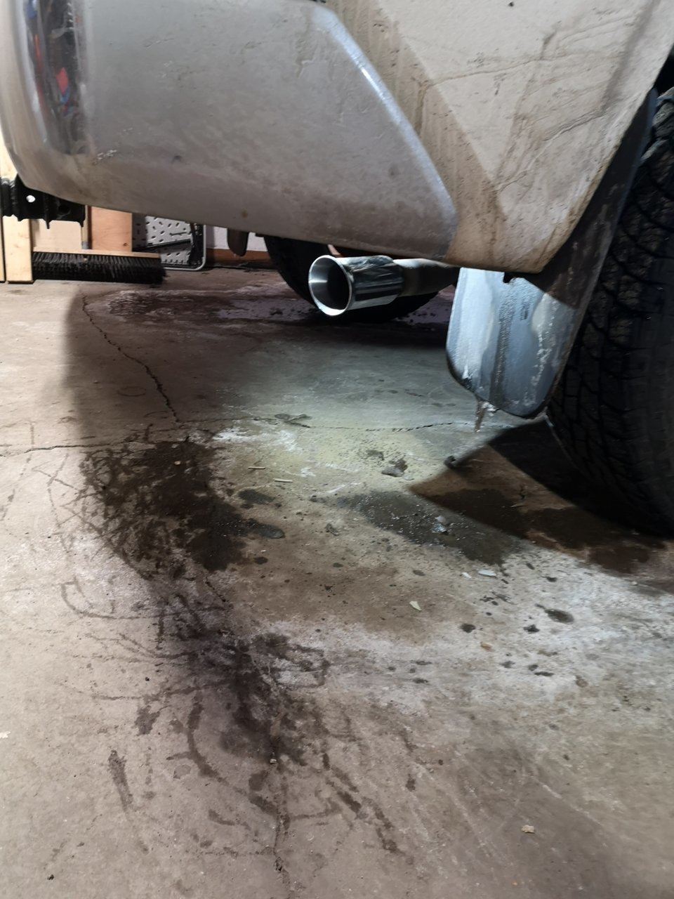

    Had the same issue on my tundra . Super noticeable on white paint. This was my solution to the issue . Cut the tail pipe back and add a cheap stainless tip . IMG_20200320_181337.jpg
