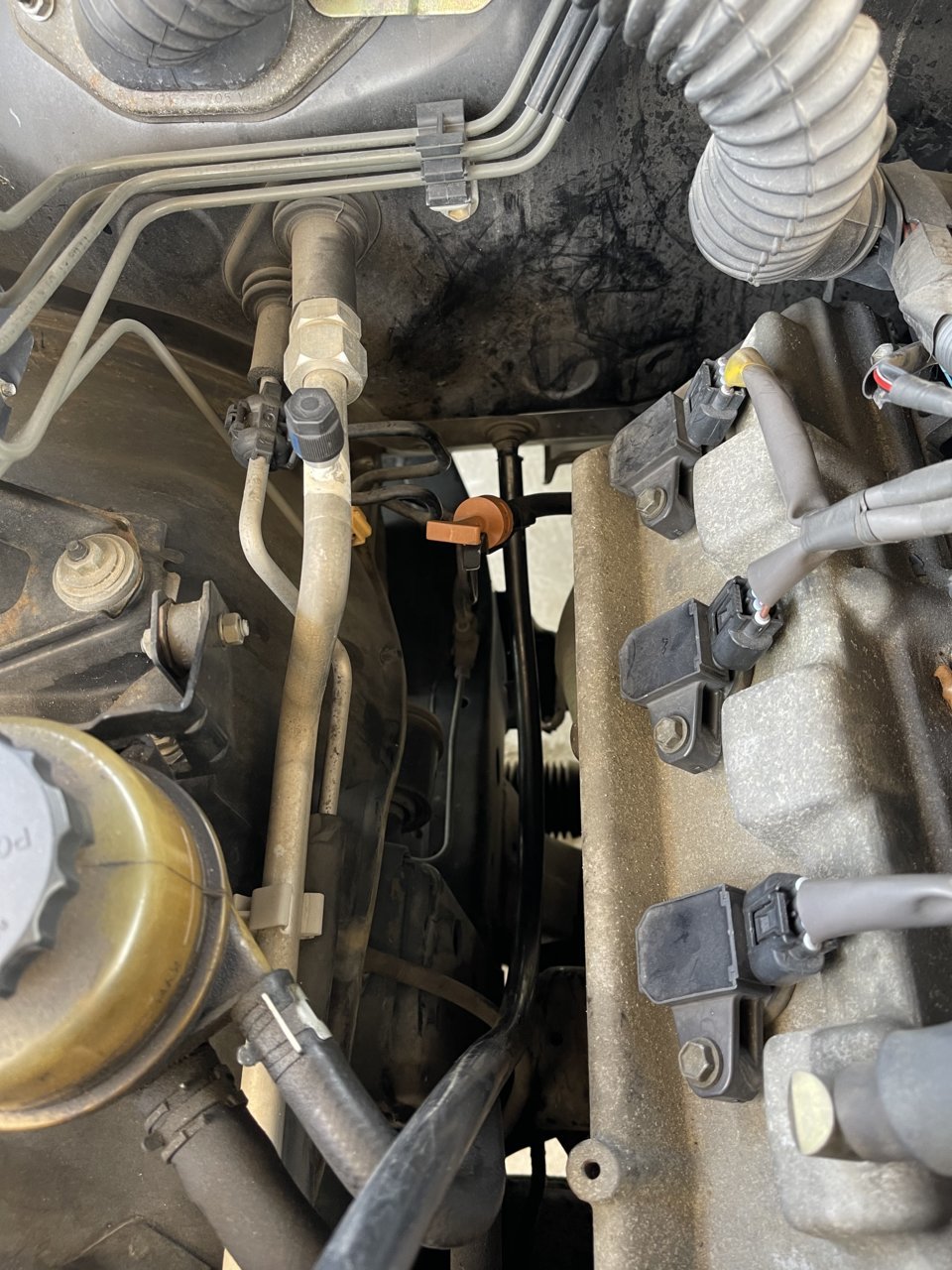

    Hey folks, it's ya boy DarkMint back again with a "what is this thing" thread.
    I noticed a small puddle of water under my truck the other day. Traced the source back to a dripping black rubber nozzle/vent/nipple thing under the hood, passenger side, next to the transmission dipstick.
    This thing is slowly dripping water constantly. I left it dripping overnight with a bottle under the truck and it dripped a bit over a tablespoon of water, so it's definitely a slow drip, but is constant.
    What the heck am I looking at? Is this water drip expected?

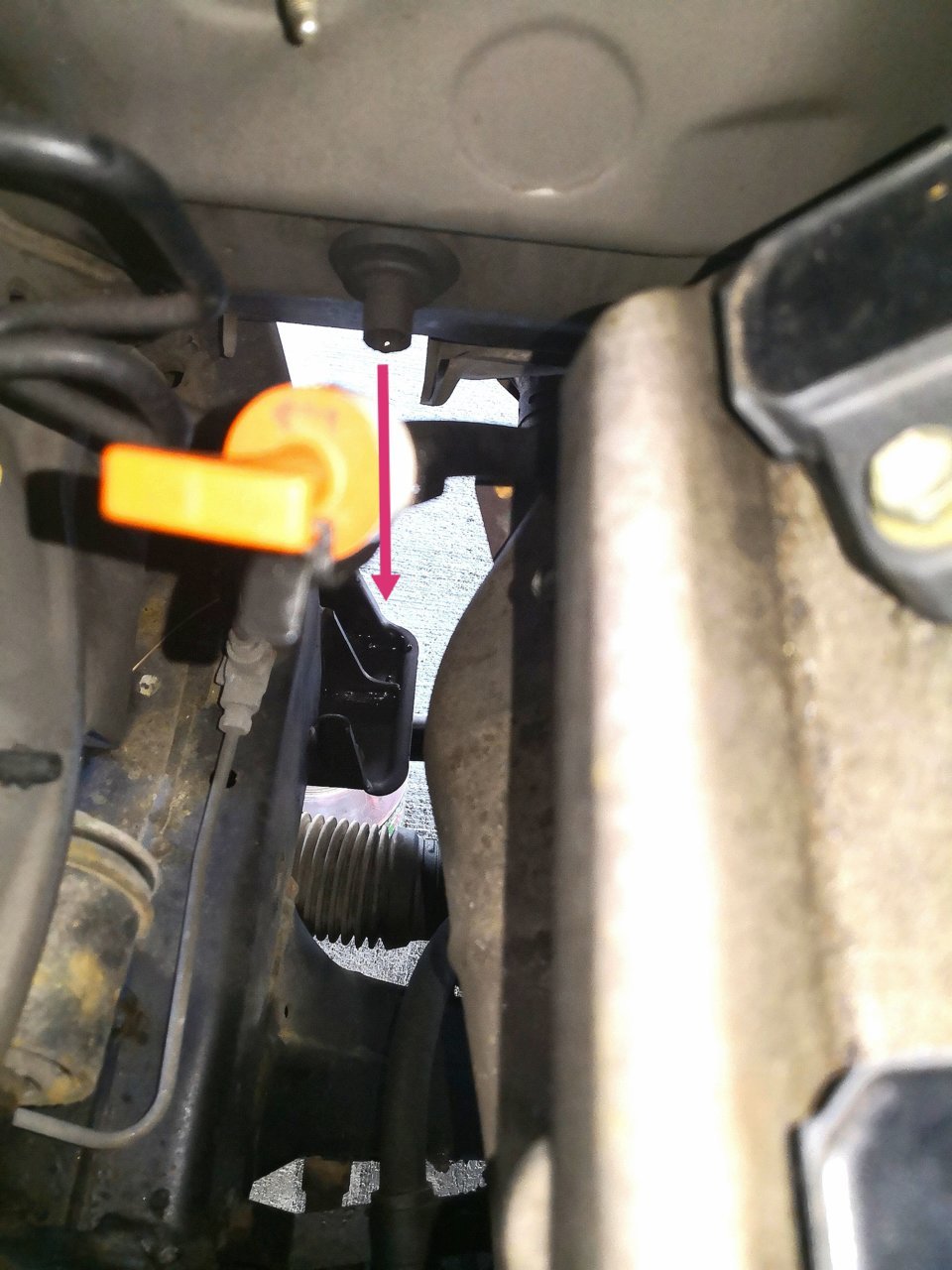

    Every Tundra has a little penis. Its hidden for shame. Once in a while if you run your AC your truck gets cold and has to pee.

    Is that really all it is, just shameful peepee?
    Are there any known mods to re-route it?
    Why does this peepee drip down onto some steel parts?
    Darkness[QUOTED] likes this.

    @DarkMint you can slip a straw inside there and let it drain completely if its leaving puddles of H2o in your passengers floor area.
    If you find it does, just puff a little compressed air into the end to clear the clog and you should be good to roll.
    As long as its leaving water outside the truck its doing its job

    Copy that. It just seems bad to drain this water all over the parts underneath it. Unless it's harmless and I'm being paranoid about rust issues. Coming from the firearms world rust is a constant battle so I may be overthinking this little truck water issue.

    It should be fine. It's mostly condensating as you're driving, therefore drying itself off.

    For a 2004 that girl looks very clean and unrusted, dont sweat the small stuff its doing something good.

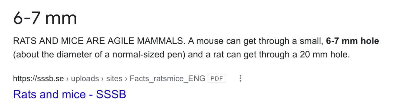

    Gotta be a really small mouse. The inner diameter is maybe 5mm.

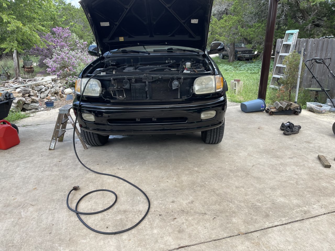

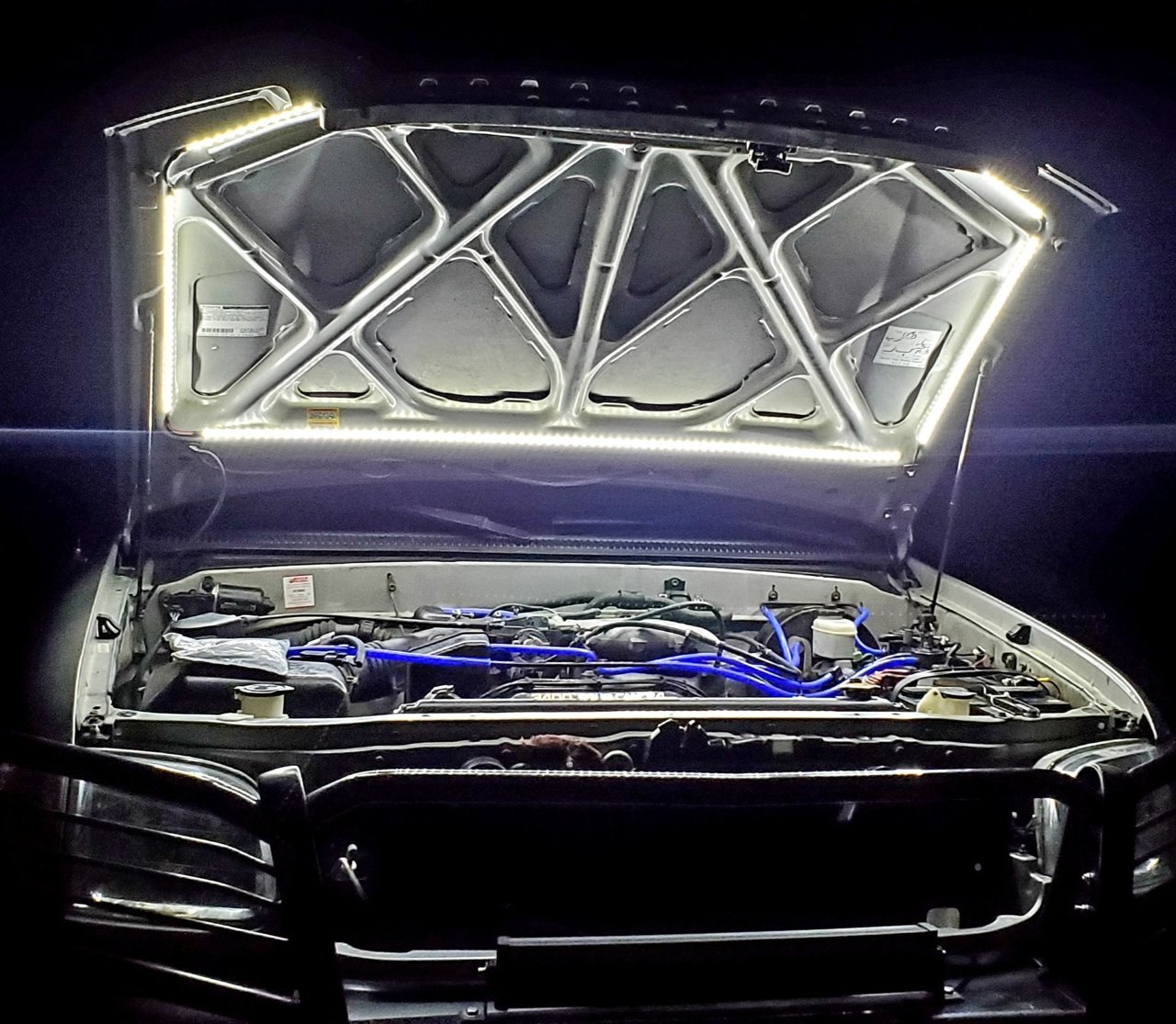

    Yalls poor trucks.
    3077E1BF-04ED-420F-8C09-2702C000346F.jpg 0443F0C9-5DAE-40AE-BE08-987917504E79.jpg

    Hey guys, dont be too hard on him, maybe hes never seen what a real engine looks like.
    Theres an engine under this:
