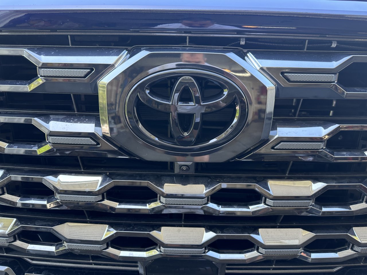

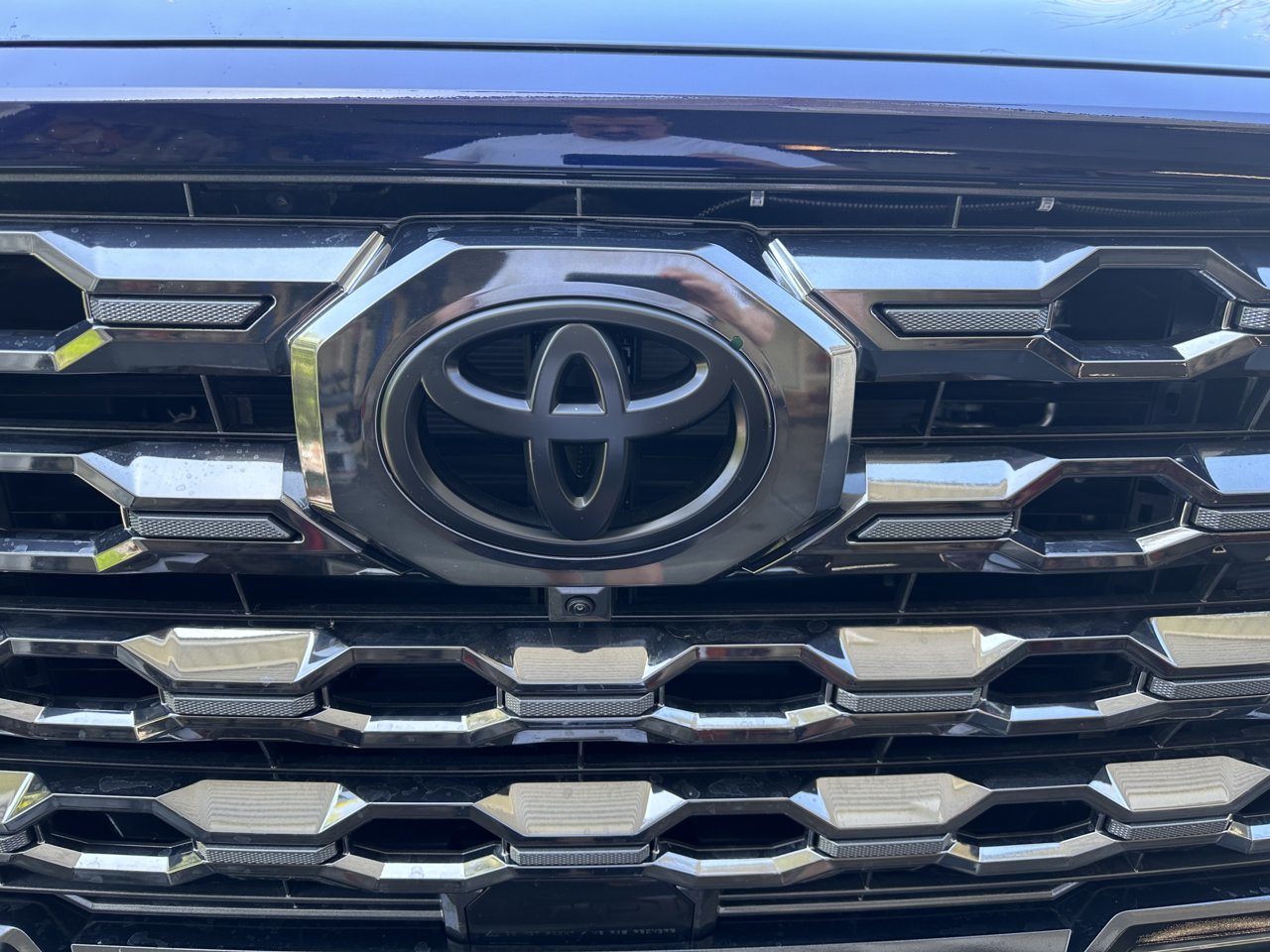

    Here is glossy vs matte on platinum
    I think the glossy fits in better on platinum, so I’ll have a matte for sale

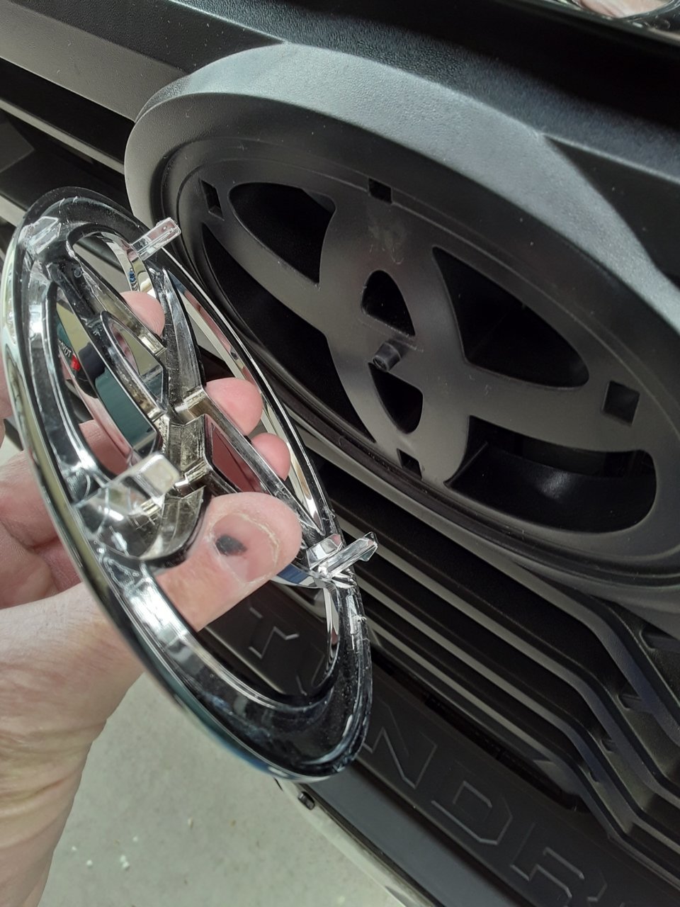

    For those of you who remove the logo and painted them yourselves, how the heck did you get this thing off? I’m pretty mechanically inclined, and it looked fairly challenging. Did you takeoff the whole grill?

    I had to pinch the 3 tabs inward while pulling the emblem out. It wasn't easy by any means. There is no adhesive holding it on, so once you get the tabs pinched correctly, it should pop out.

    My emblemed popped out by pressing the clip on the back of the emblem that is located at six o'clock.

    yes. tabs at 10, 2, and 6 o'clock. Reach through and gently work any one tab; the emblem will separate from the grill a sliver. Then do same to the other two and it pops out.

    Flathead screwdriver from behind on each of the 3 tabs did the trick for me. Put several coats of plastisip on mine as well and it's been holding up great. Will snap a pic tomorrow
