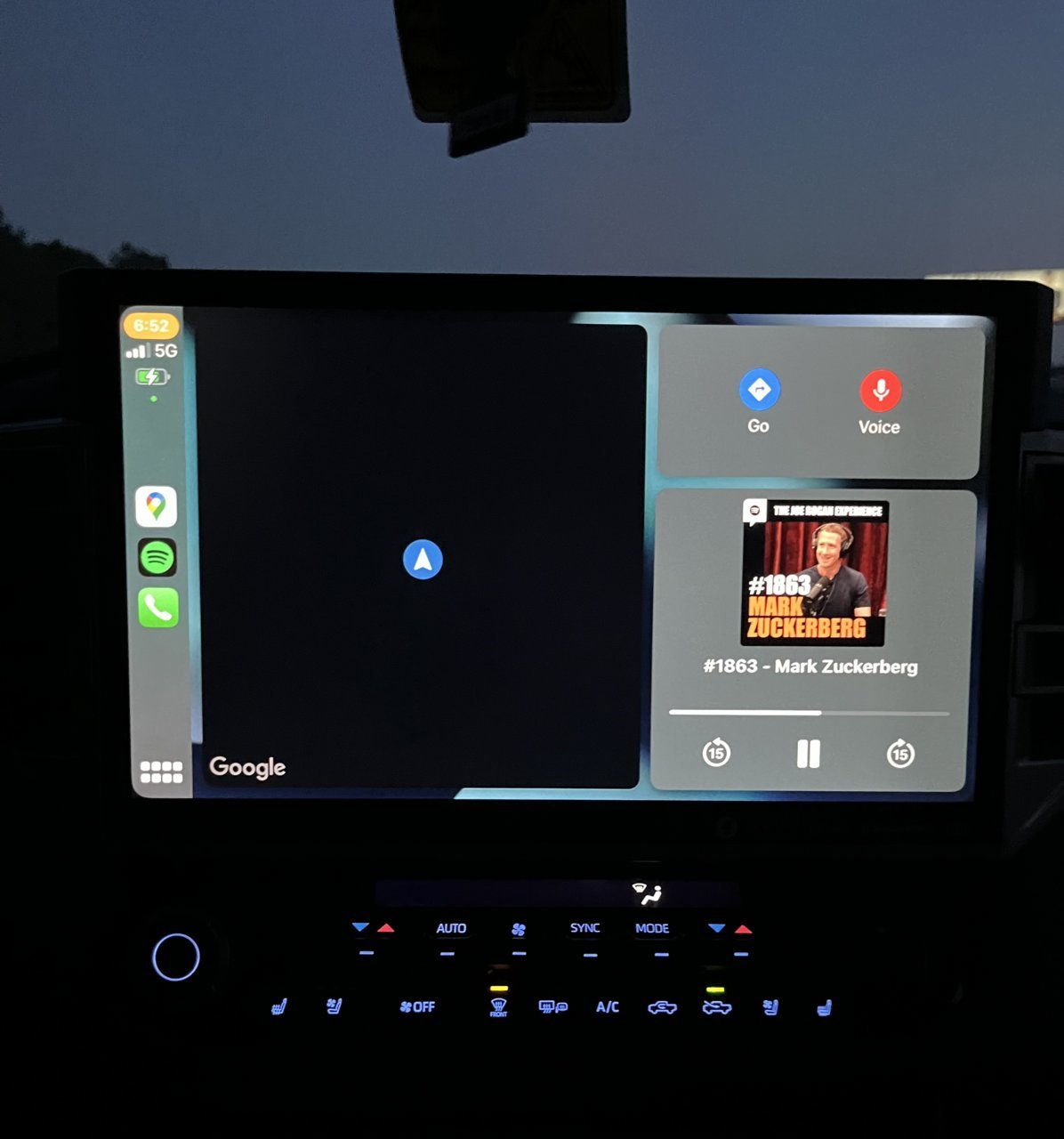

    Has anyone else experienced their navigation screen on CarPlay blacking out? I’m not sure if this is an issue with CarPlay/Apple or the tundra itself. Any help is appreciated.

    Mine started doing this several months ago when I was still using Google Maps. If you go on your phone, open Google Maps, then it will appear on the screen. But as soon as you close the app, it goes black again. No clue why it started doing this. So I switched to Apple Maps, and the map is always up there even without opening the app on my phone. No idea why Google did this.

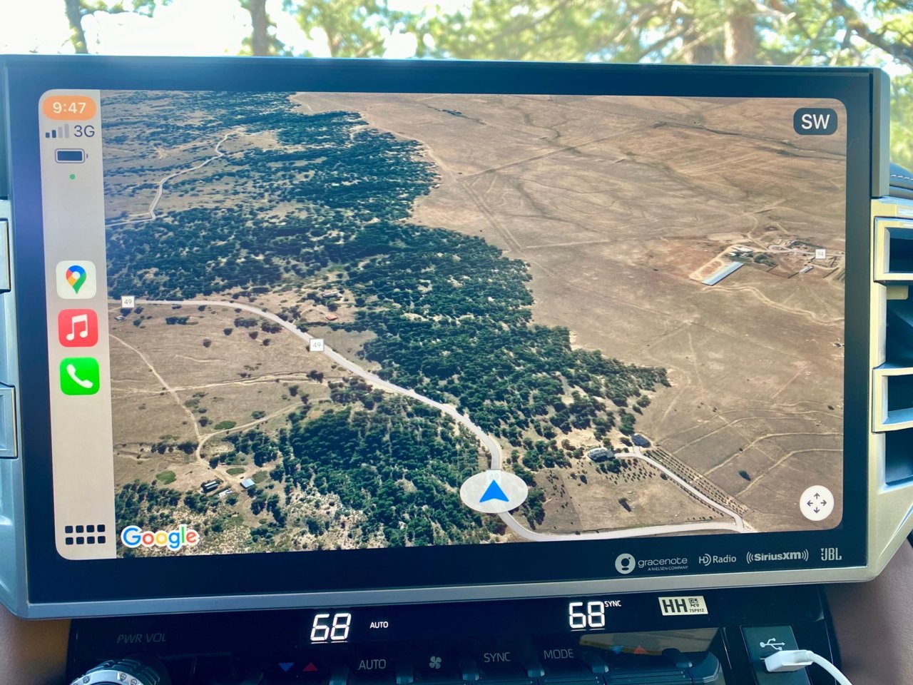

    I use Google Maps via CarPlay. I love the satellite view on a 14" screen. It doesn't have to be open on my iPhone to display correctly on my truck screen. I've never gotten the black screen. I'm using IOS 15.6 on a iPhone 11 Pro Max.

    Not had this problem on any CarPlay maps yet but the built in Toyota maps have got lost and gone blank twice in the past 2.5 months. I love that Satellite view from Google you’re showing. I can’t seem to get that working. Have Sat view turned on in iPhone but truck is showing street view. I gotta figure that out. Looks cool

    Go to Settings on the truck screen when you have Google Maps displayed. It's the little gear looking icon on the upper right corner of the screen. Then select Satellite Map. Voila!
