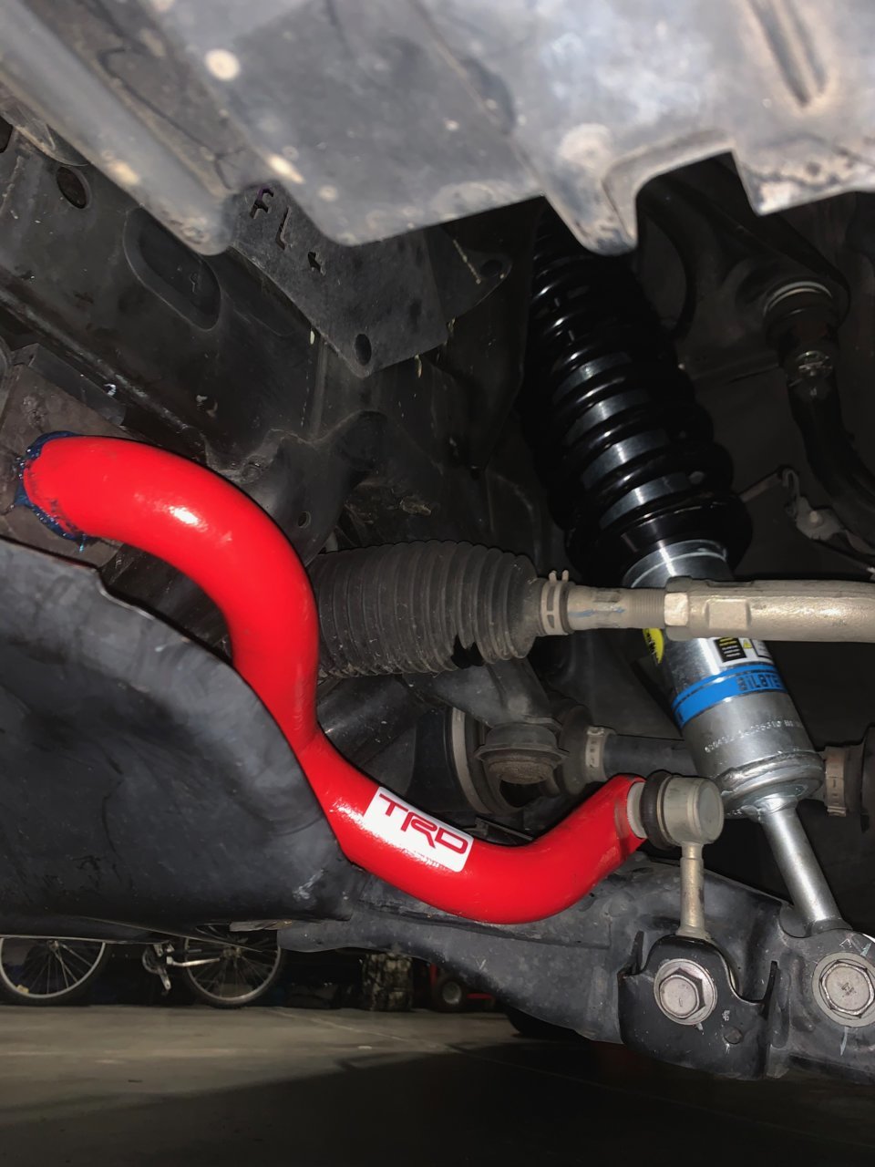

    Thanks to the information on this forum and some YouTube videos I've seen the light! The stock ride on the Tundra was seriously lacking in any sense of responsiveness, other than feeling like a boat.

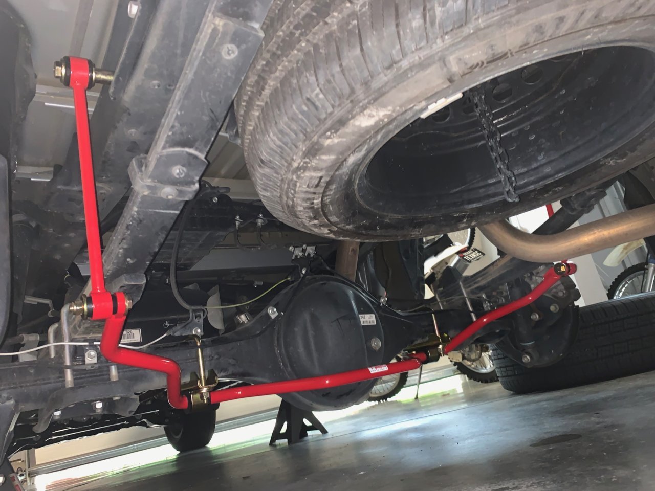

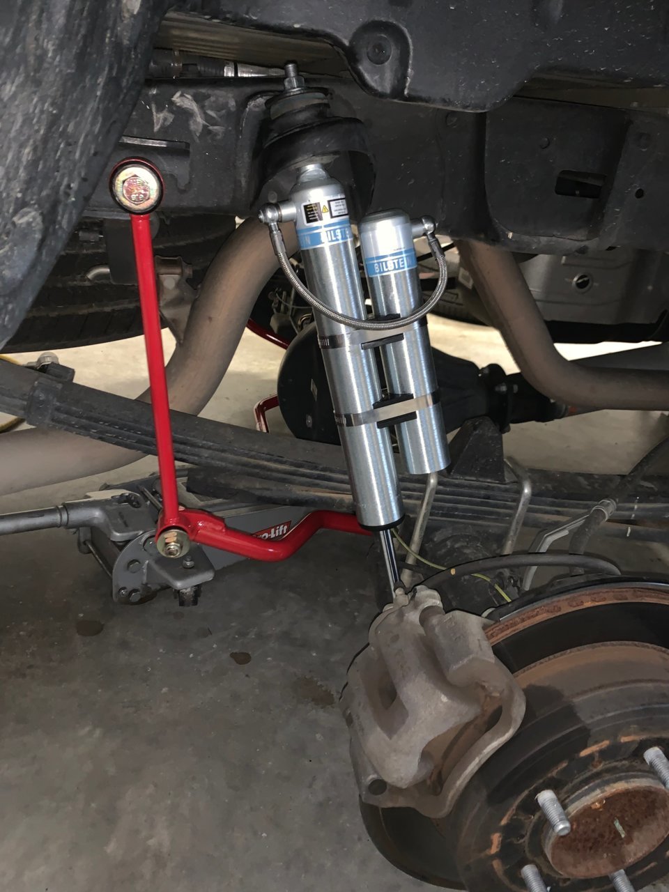

    I upgraded my suspension to the Bilstein 6112 Front shocks/coil and 5160 Rear w/reservoir. I added the TRD rear sway bar and upgraded the front sway bar to the TRD. Huge improvement over stock. Put the front ring on the second from the bottom and that just about made it perfect front and rear. I'm running all-weather tires and may get more aggressive in a couple of years, but for now this is going to be a highway cruiser and national forest stalker.

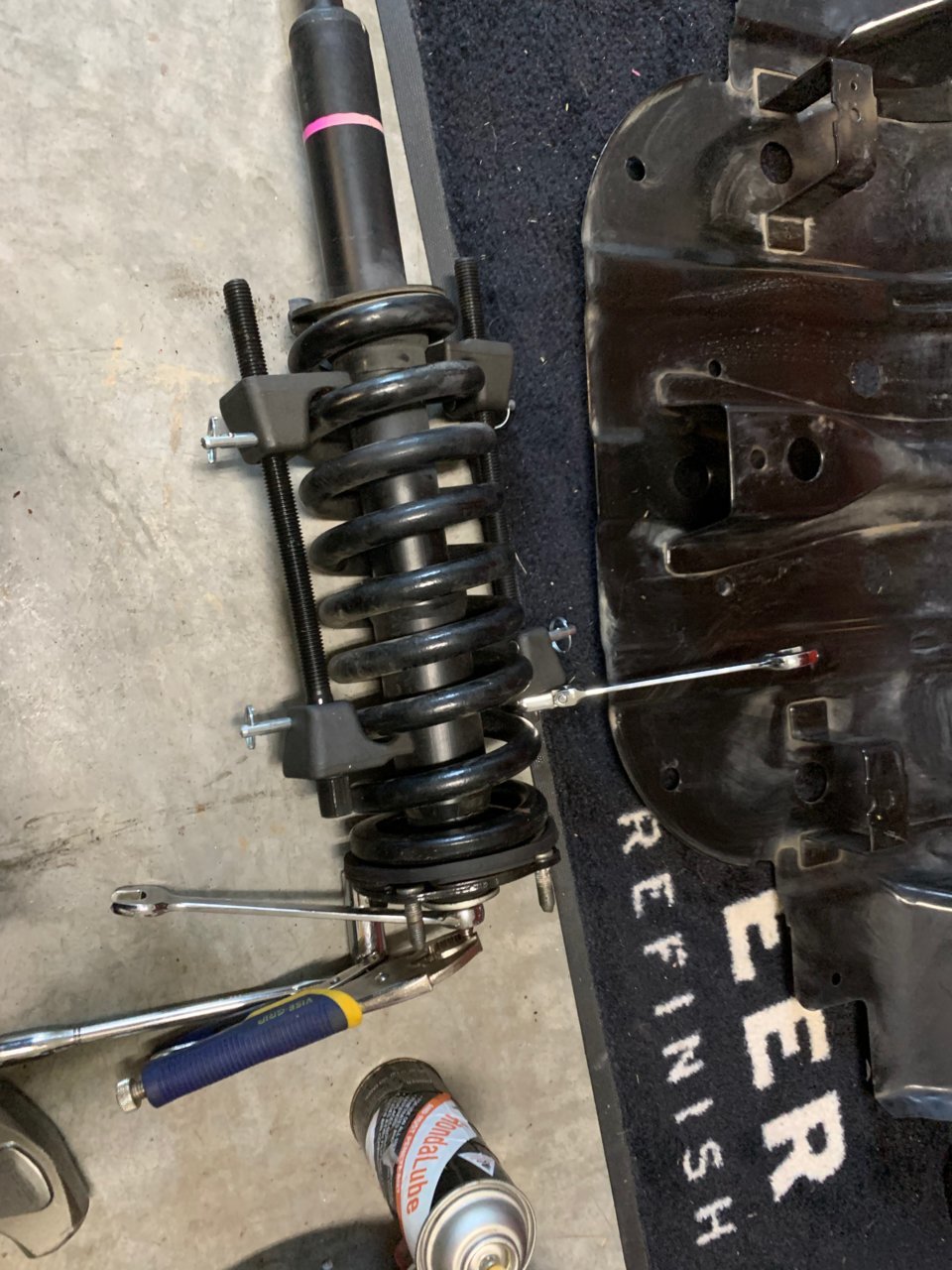

    I drove it after doing the rear first to check my rear measurement and that made, what felt like a 40-50% improvement in the overall feel going down rough roads. Did the loaner tool program through AutoZone for the coil compressor tool. Only mistake I made was when transferring the top hat to the Bilstein shock I didn't check the arrow and OUT marking and had to recompress to adjust the shock. After doing the front, it handles as if it's on rails. I had the alignment checked and the front toe was only slightly out. Very happy with this modification. Ran me about $1400 for everything shopping around.
    I did everything myself and only needed a second pair of hands getting the front shock reseated in the cup and a floor jack to hold the front of the TRD sway bar to get it bolted up.
