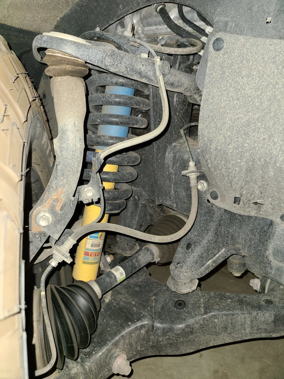

    Last question before install. Is there anything I need to extend or relocate in the front? 20210819_073530.jpg

    How are you trying to swap just unbolt and replace or disconnect lower control arm?

    I'm hoping to just unbolt and replace.
    I believe the pro shocks add 2 inches. I'm curious if it's necessary to have longer brake lines. What's other people's experience with this.

    Brake lines should be fine, was just an option while stuff is out.

    Just be careful not to pull cv joint out. I did not extend lines

    Disconnect the brake line and senser wire brackets so they can move more. Disconnect the sway bar first, that will help you move the shocks

    Brake lines are fine no need to extend them. Just unbolt them during install. Shoot me a text or call if you have anymore questions.

    No need to extend the brake lines with that setup.
    TRDPros have the same factory lines as everyone else. Yes, you need to be careful when everything is disconnect during install so you don’t stretch them but once everything is reassembled there is plenty of brake line.
