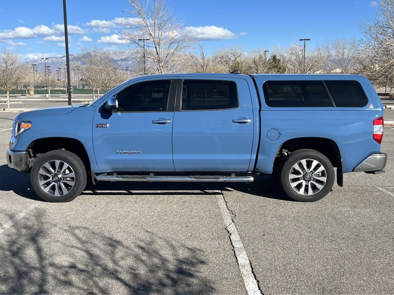

    Okay, so the super slow build has sped up slightly, and I finally installed my TRD Pro front coil overs with a single coachbuilder shim on the driver's side. I got the alignment done today; it looks right and drives right. I bought 275/65R20 4 New Arroyo Tamarock A/t - Lt275x65r20 Tires. I will be curious to see how they ride. $632.00 for four tires off of eBay, and the reviews have been pretty good, so we will see—couple pictures for now. I will post more once the tires are on, and I want to do a before and after picture.
