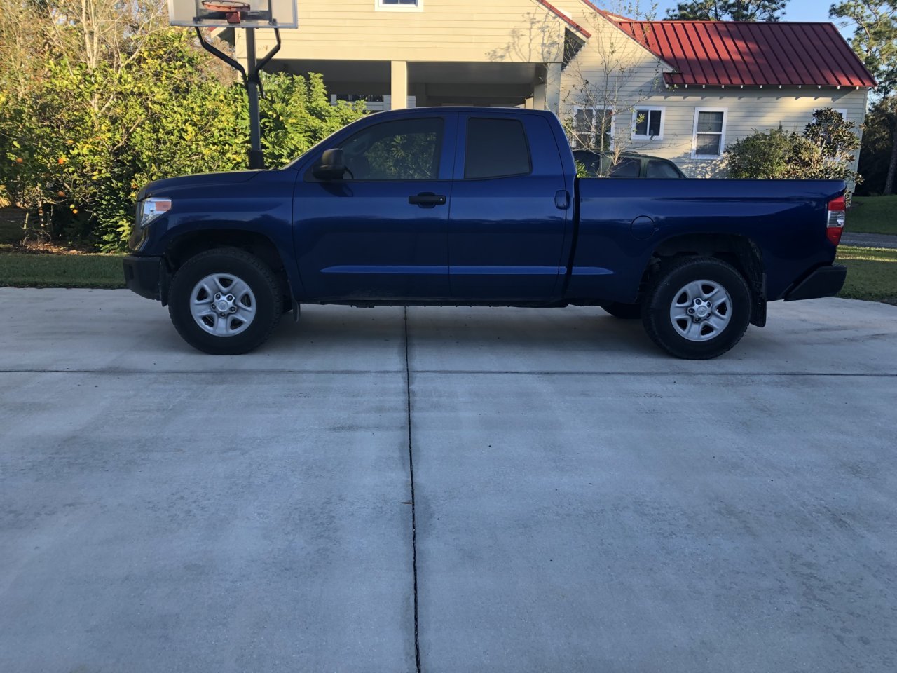

    275/70r18 = 33.2"
    2.5" front lift, none needed in rear, truck will sit level.

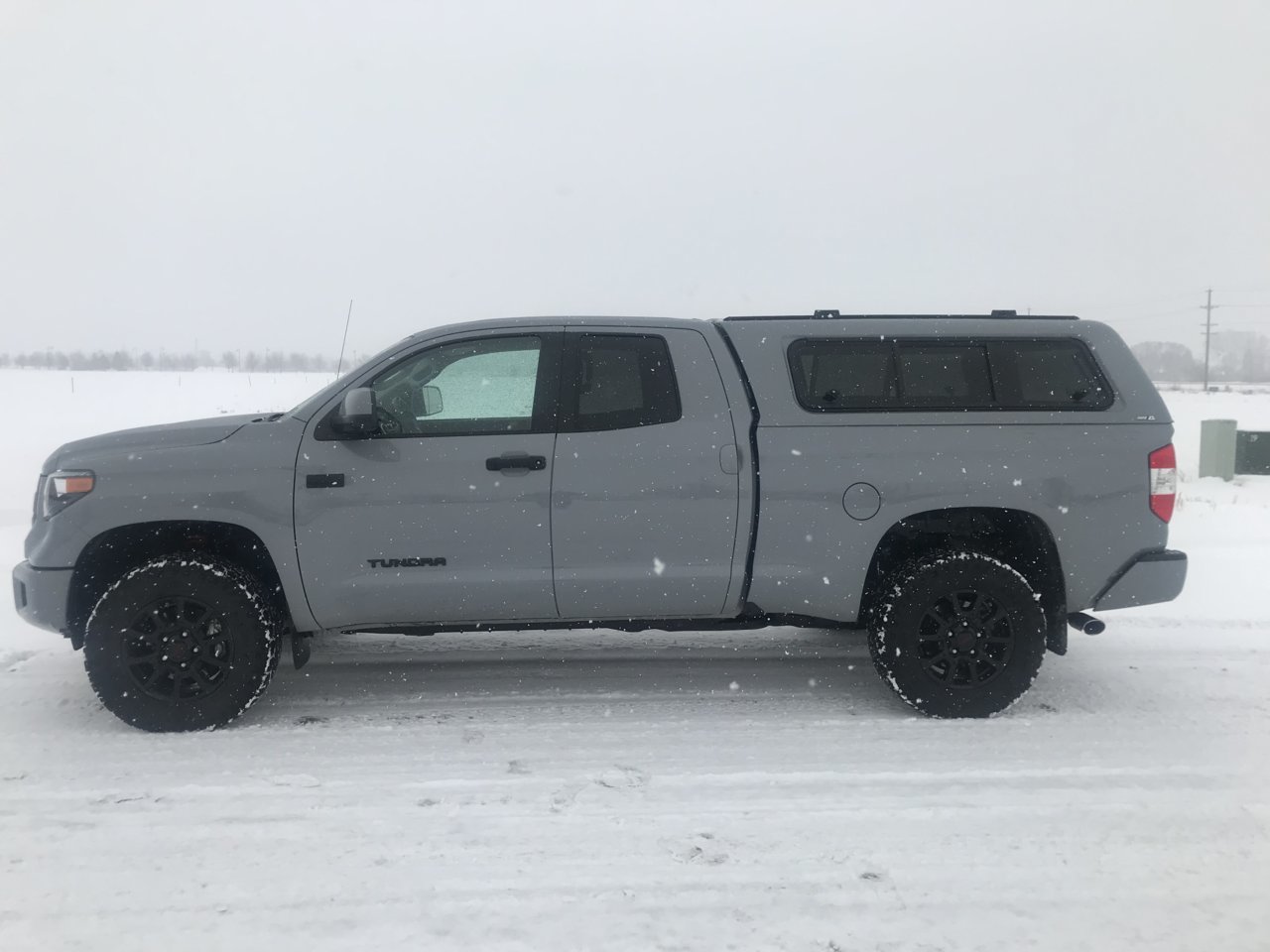

    Baja Designs Squadron Sport Fog lights, ARE CX Series Topper, Alcan Springs , DAP Tune, Coach Builder +1 Shackles, Headlight Revolution Supernova V.4 LED bulbs, HR LED interior bulbs. General Grabber ATX 275/70/R18
    Install Coach Builder +1 shackle, gives a nice ride and lifts the rear up 3/4”.
    Installed mine a few weeks ago very happy with the results. I am running 275/70R18

    Thats only 3/4” of lift in the rear? Stock pro setup in the front, no shims?
    If so, that’s pretty good for having a shell on the back. Maybe the road is uneven? My pro setup has me looking level and sometimes nose high. Didn’t think 3/4” would get me to where your truck sits.

    Yes that is a 3/4" in the rear. Running Pro suspension gives you a lift of 2.5" in the front. Gives you no lift in the rear. I replace the OEM leaf spring with Alcan leaf spring build 500 lbs over capacity. I have a constant load of the bed all the time, plus I was getting some squatting with OEM springs. CB +1 shackles raised the rear end a bit. Next year I will be replacing the suspension with either Kings or ADS shocks.

    Ok the Alcans raised it a little bit too. And I’m pretty sure you only get 2 inches from the pro suspension. Or 1.9 LOL I got about 2 inches when I put it on my truck.

    Right it's only 2" I was thinking an aftermarket, been reading to much about kings and ADS which give you a 2.5" lift.

    5100s on bottom setting 275/70r 18 no lift in back E1B6BAC5-2CC9-4360-A1B9-A14D2E96778E.jpg
