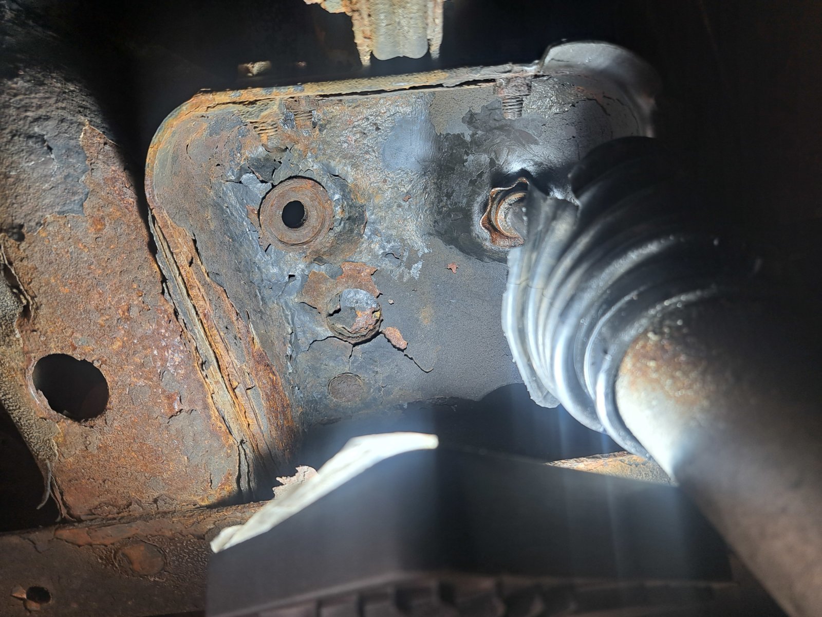

    I had a rattle underneath my 05' DC 4x4 and found my rear driver side bilstein was loose on the top mount and had been bouncing around. I am mostly worried about the shock mount and if it is damaged, and whether or not it may need to be repaired or replaced?
    I sprayed with PB blaster the last two days I was kind of hoping I could just crank the nut on top tight again and be able to drive safely for the time being?
    The boot on this paticular shock was hanging and mostly torn off. I have attached pics and appreciate any feedback!

    Why’s the metal washer puckered like a starfish? If it was normally flat, I’d say you’ve got an issue with it and it most likely needs a weld repair patch to reduce the hole size.

    That's kinda what I thought, and am afraid of. Thnx

    I’d say it’s not unrepairable though since there appears to be plenty of good metal around it to brace the force of the shock from a new plate of steel being welded in there.

    I’d like more pics. Clearly a new shock is called for but that looks more like an internal clamped piece of the shock than a crumpled washer to me.
    And I’d be more worried about the delamination I'm seeing in all that rust more than the shock. That’s pretty rough.
    You didn’t buy the shocks on scAmazon by chance, did you?

    so...ummmm....where’s the upper shock bushings? The shock stem is threaded only partially, and the nut that’s currently on there might already be threaded down to the very ends of them.
    Or can i not see the bushings for some reason? If they’re scamazon/fleabay Philistine 5100’s, perhaps the bushings were made out of old tennis shoe mid soles?

    My guess is OP didn't install them properly. And I'm pretty sure that shock is completely blown, and what you're seeing up there is a cap that was once inside the shock.

    OP had them installed. The bushing is collapsed and pushed thru.

    That is correct. Thanks.
