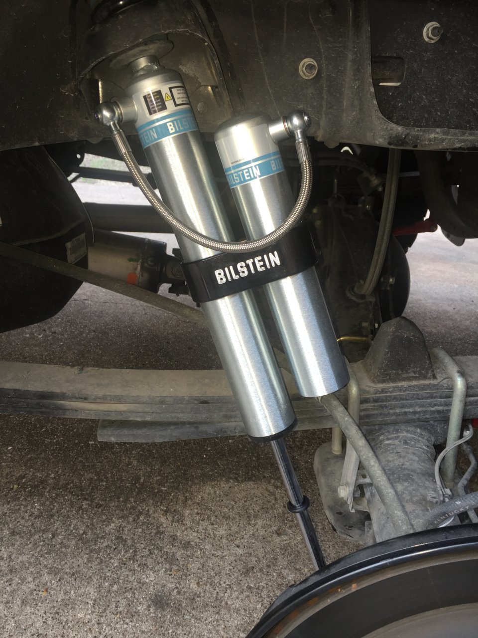

    I went with Bilstein 5160s for the rear.

    Forgot to add a photo.

    5100s are good shocks, but 5160s come with an external reservoir. So theoretically, they should heat up more slowly than 5100s. Heat causes shock fade, which affects shock damping ability. I figured they were a decent deal for better shocks without breaking the bank.
