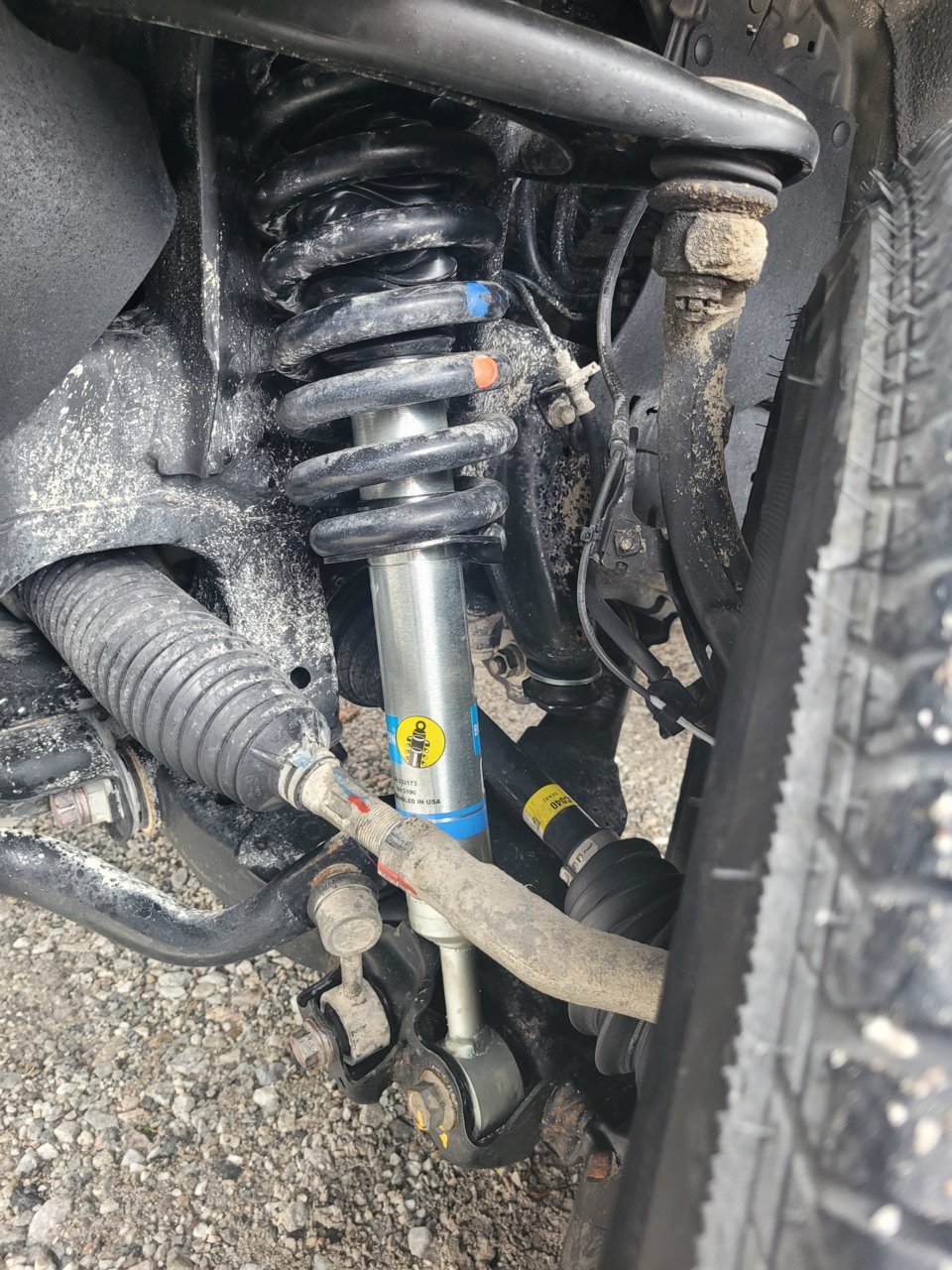

    Post a pic of the lower perches on the shocks. It’s somewhat common for shops (or DIYers) to put the perches on upside down and give way too much lift.

    Here's a shot of lower perch, I don't think it was a bad install, just a bad choice of setting.

    Ok those look correct. I’d say make them drop it to the mid setting like you wanted then. Or get shackles for the rear like @saybng mentioned. You don’t have any shims or spacers on the top right?
