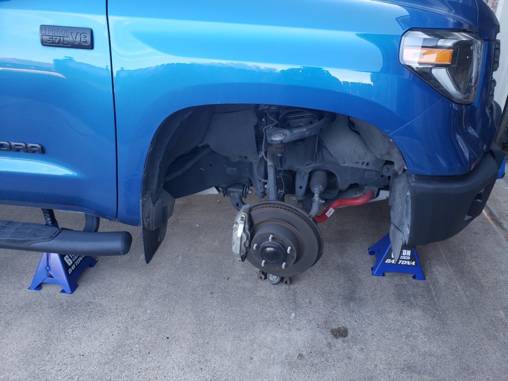

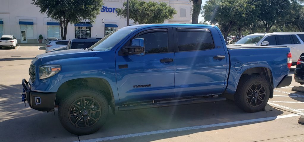

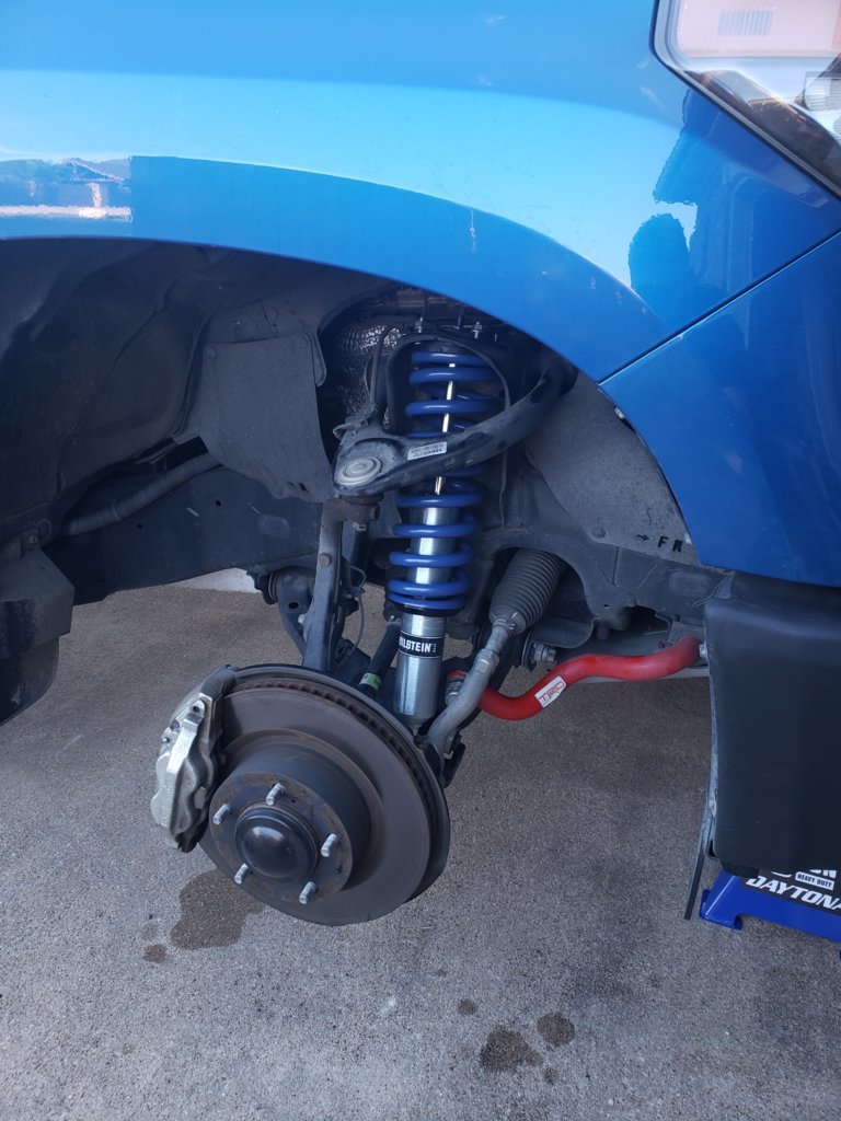

    RobertD
    May 18, 2020
    #46765
    4,856
    Robert
    DFW, Texas
    I ordered from @memario1214 and he assembled the 6112 at the setting I wanted. If you get them already assembled, it isn't too hard to do the install yourself. I did the 1.9 with a driver side shim, currently on stock UCA's. I had the coilovers powder coated blue, but they are the coils that come with the 6112.
