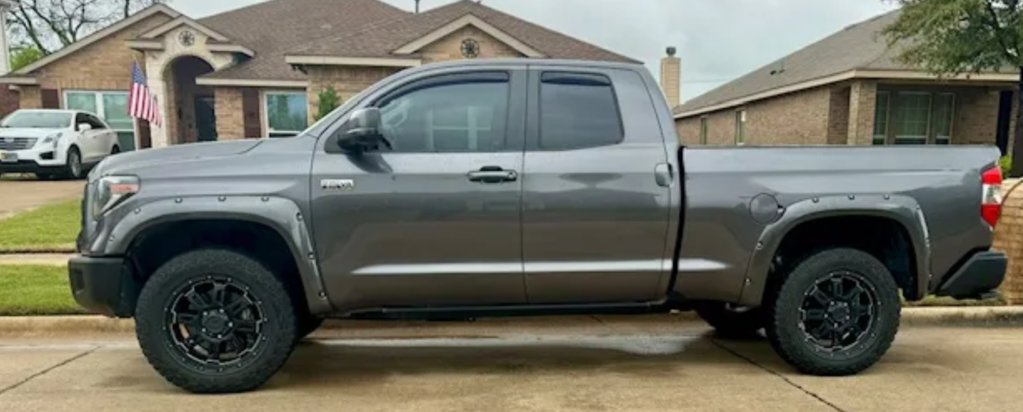

    I'm planning just to do 1.75" lift upfront to level the back and leave the back at stock height. going after some looks, more comfort for daily, and some capabilities on weekends... this is my end goal setup for reference. cheers

    If i can justify buying the 6112/5160. affordability is bottom of the worries. i just want to make sure i really need it for my intended application. thats a plus for that combo rather than 5100 all around
