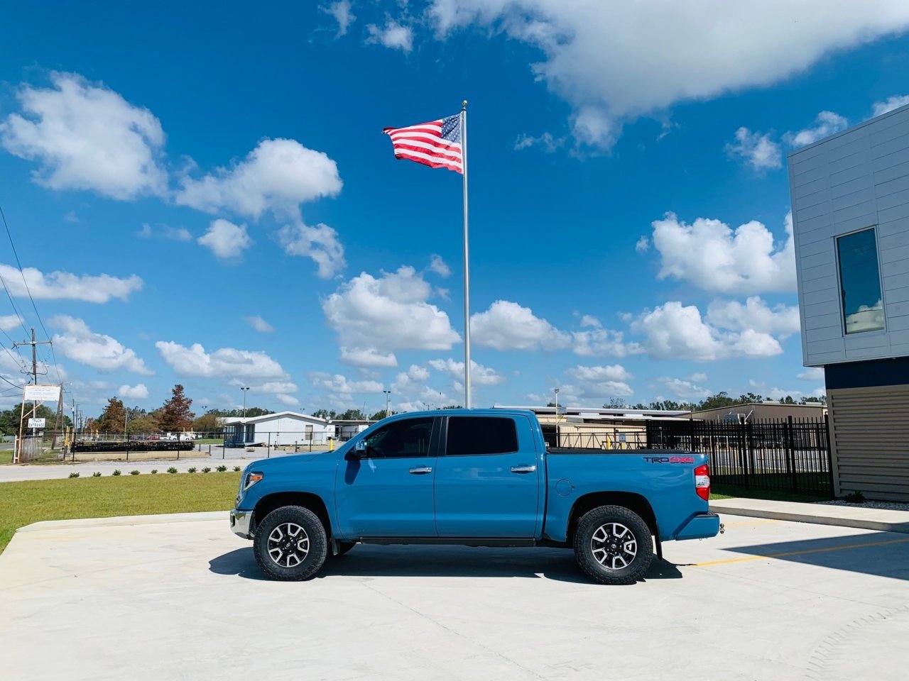

    Same set up shock wise, 295's no blocks in rear.

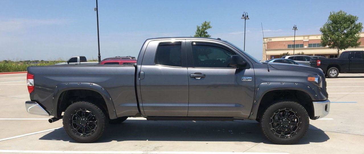

    I'd go with rear shackles over a block.
    I did 6112s (not the highest setting) with the end result of 2.5" of lift in the front.
    Pretty much leveled the truck.
    763B91DF-899D-4443-A7EC-B9CE39DA5452_zps_40bc24ad3f26a52479708d1be3d2d728905eb2e0.jpg
    I then added Toytec shackles on the 1" setting.
    91CBAE5D-765D-497E-9830-48F25491821C_zps_503c9585249b42e32b25ba10b10d1035f78d1e04.jpg
    When I did run it level I would get nanny warnings on sharp turns.
    There is a way to fix that, offset the sensor under the console, but I wanted a little rake back.
