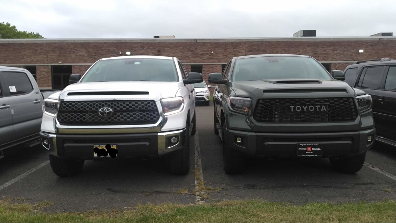

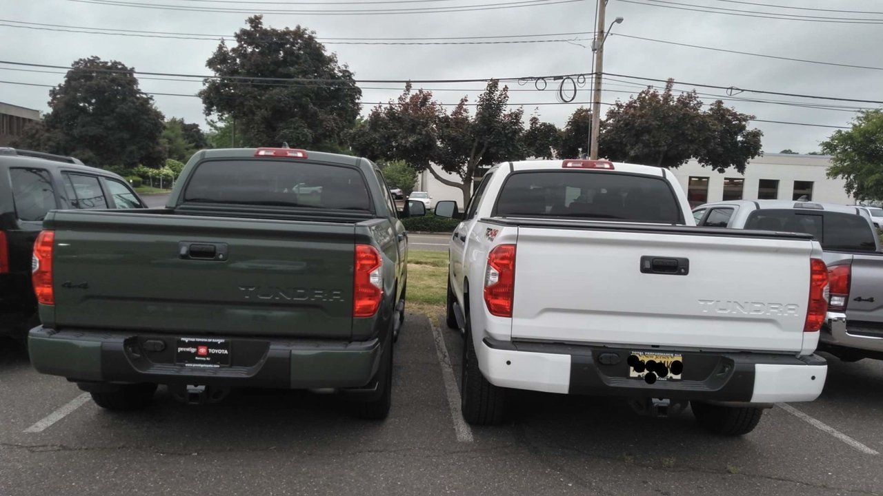

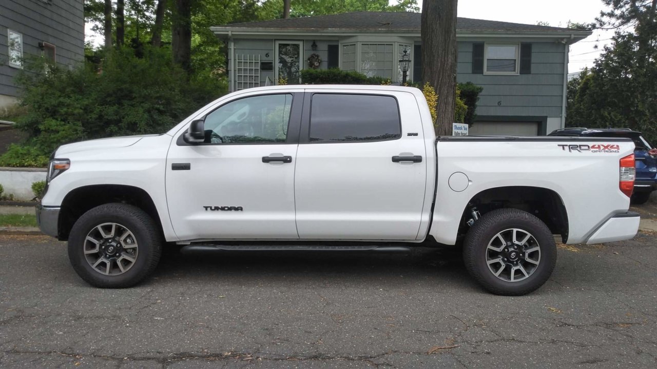

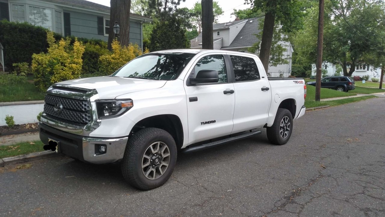

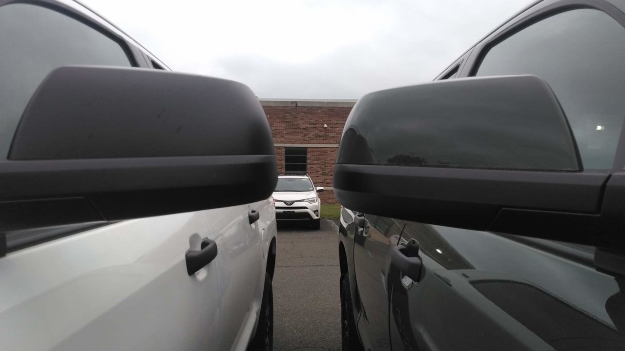

    I've added a few pictures of my truck next to a stock TRD Pro for comparison.

    The truck is otherwise bone stock, and the only thing possibly affecting the stance would be:
    -Gas tank is 3/4 full
    -Rugged liner tonneau cover installed (~40-50lbs)
