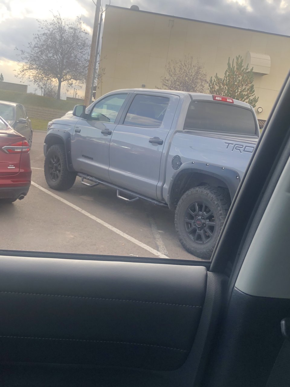

    Hello everyone,
    I just purchased Bilstein 6112 and am planning on setting it to the highest setting and wanted to put Toyo open country Mt 295/70/18 on the stock rims and was curious if anyone has done this setup yet and if they ran into any problems rubbing with this setup? I saw this trd pro on base the other day with the EXACT setup I’m looking for and was wondering if the 6112’s will achieve that same look? Thanks in advance all.

    I don’t run 6112s myself, but I’d say check out this thread.. probably find what your looking for: https://www.tundras.com/threads/6112-setting-and-tire-wheel-combo-thread.23699/page-13#post-1286047
    As a side note, I am running 295/70r18s on stock TRD rims and had to use some Spidertrax 1.25” spacers to get the tires away from my UCAs.. also would have had to chop/bend my stock skid, but bought an RCI one which is narrower and allows for bigger tires to get full articulation without sacrificing protection.
    Good luck!
