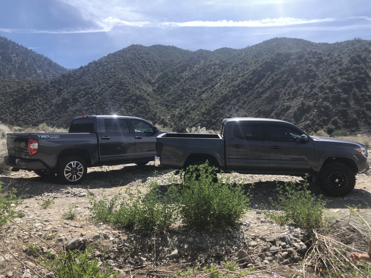

    I don’t do much hauling other than the occasional Home Depot run. Although, my family has a 32’ trailer that I’d like to tow once or twice a year without sagging too much (They have a ‘15 CM Off Road 2WD and that sags a little more than I like). I want to be able to load up the back for a weekend camping trip and, if I’m feeling adventurous, be able to explore a bit and not have any worries with the suspension. My brother-in-law has a Tacoma with a lift/suspension upgrade (unfortunately don’t know what method/brand) and my Tundra looks so under-qualified next to it.. haha.
    I’m thinking of going with 5160’s in the rear, but I’m curious how those do with towing. Not super important but I’m trying to take everything into consideration. Do the CB shackles have any pros/cons? The concept seems just like adding a spacer in the back. Will adding a leaf give me some lift while retaining some rigidity for towing? Just my thoughts. This is all new to me so my understanding of truck lifts and suspension is minimal. Would love your input! If you could share pictures of your truck stance, and setups, I’d greatly appreciate it.

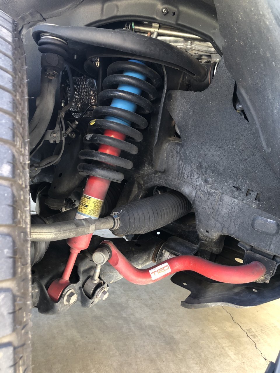

    I run 1 inch coachbuilder shackles with 6112s. With the leer shell I should have done the +2s to remain level. The 5160s have done fine with towing.
