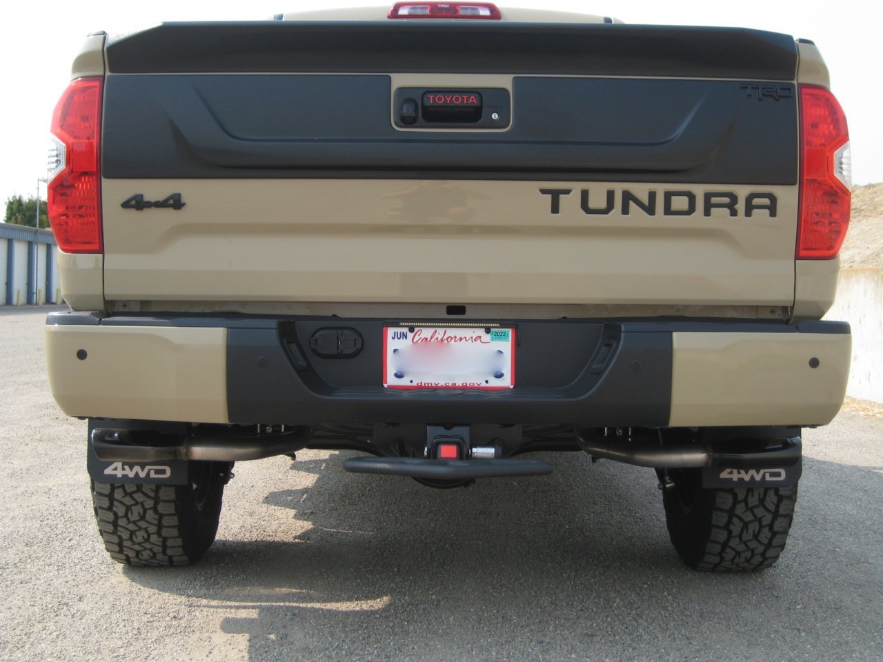

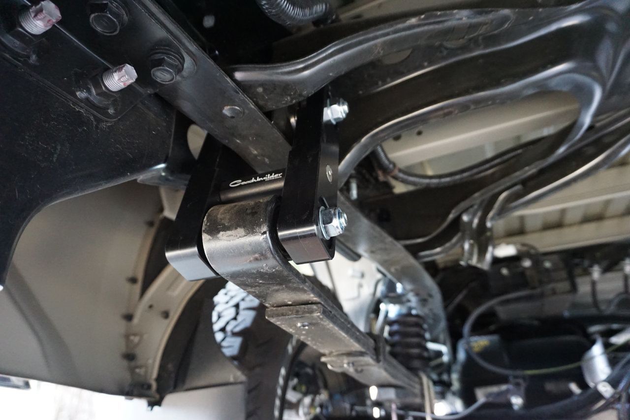

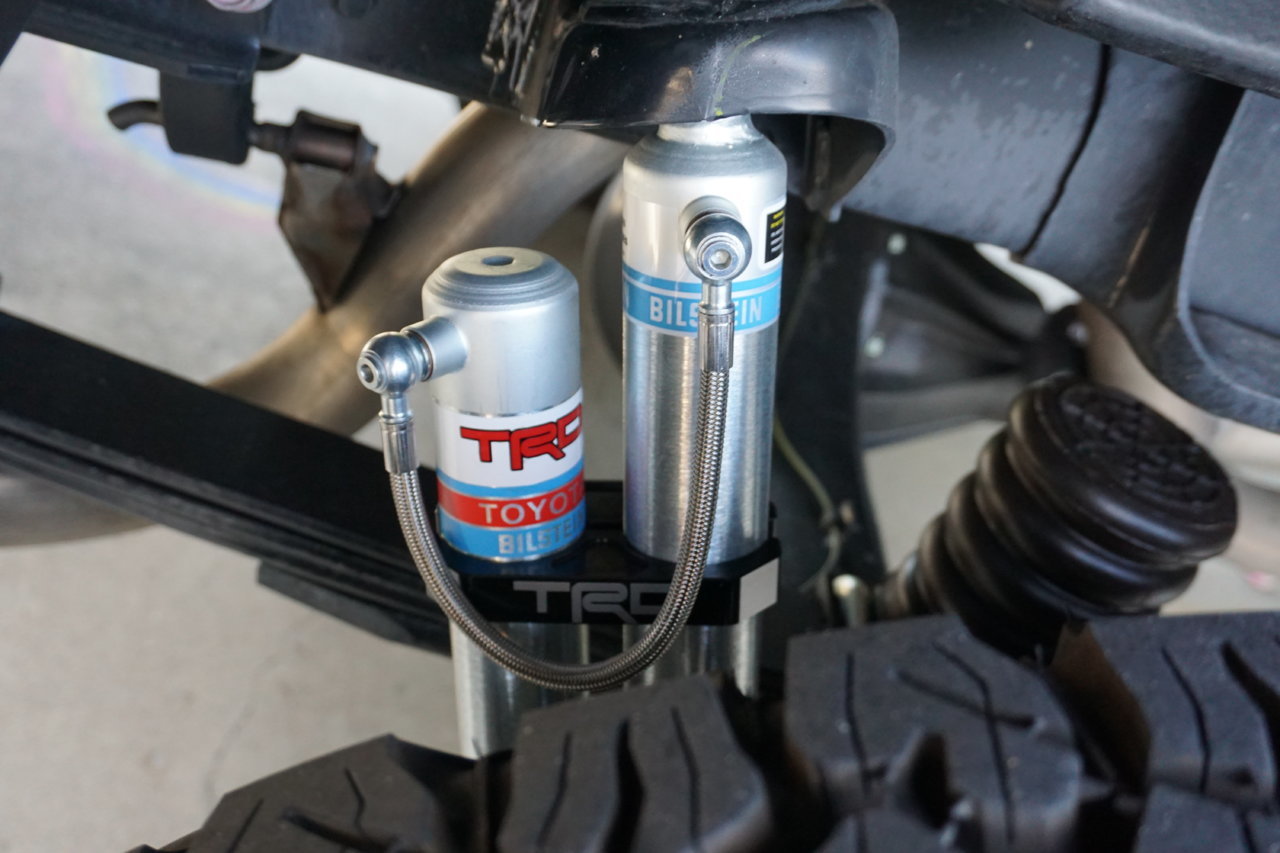

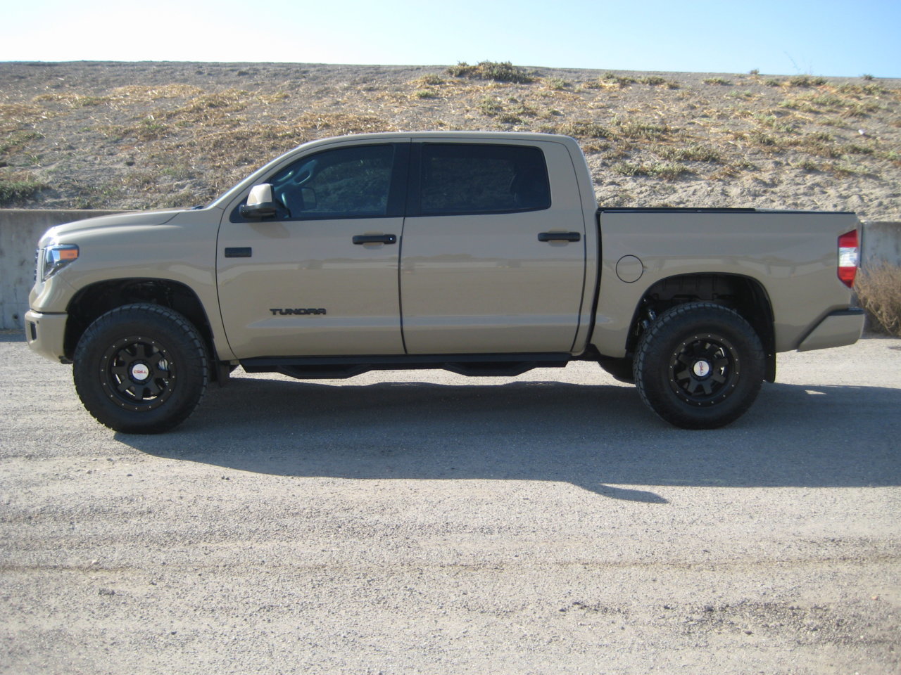

    You will not regret it. Shackles with the 5160's. Best way to set it up. This is my rear setup: Coachbuilder +2 (1.25" lift) and Bilstein 5160.
    After it settled: Rear is 1" higher than the front. Exactly how I wanted it.

    Yes. This setup will work with the TRD Dual Exhaust.
    Here is mine:
