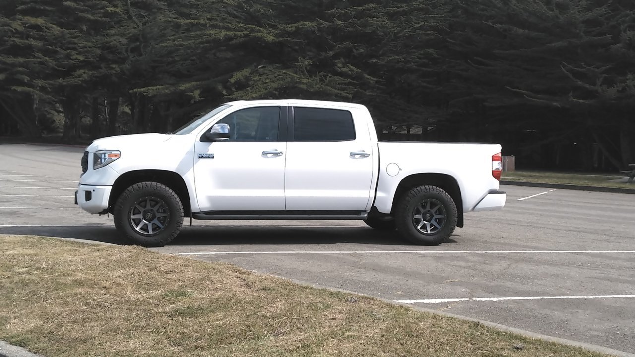

    KIMG1566.jpg2019 with 5100s front and back, middle clip front, stock height rear. 275*70*18 Maxxis on Icons 18*9 with 25mm offset
    PermaFrostTRD and Sleeper16plat like this.

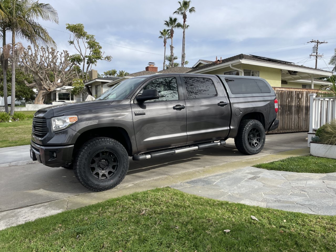

    Southern California
    2015 Tundra Platinum, SnugTop Shell, Gray
    Bilstein 5100 all four corners - front at top setting Ready Lift 1” rear block 295/70R18 Falken Wildpeak Method Roost R18 Under Seat Storage Boxes - Rear Seats - see post LED Interior Lights LED Mirror, Back-Up and License Plate Lights Added Auxiliary Fuse Box and Battery Switch Plasti-Dip Chrome Mirror Covers and All Badges to Black WeatherTech Bed/Tailgate Liner Replaced tailgate strut Working On Modifications: Add Oh Sh!t Handle To Driver Side A Pillar LED Head and Fog Lights
    Bilstein 5100s all four corners.
    Fronts set to highest setting.
    1/4 shim above driver front strut to alleviate Tundra tilt.
    1” ReadyLift block in rear.
    Method Roost 18” Wheels
    Falken 295/70R18 Tires
    tundra_uso, The Dude and ATV25 like this.

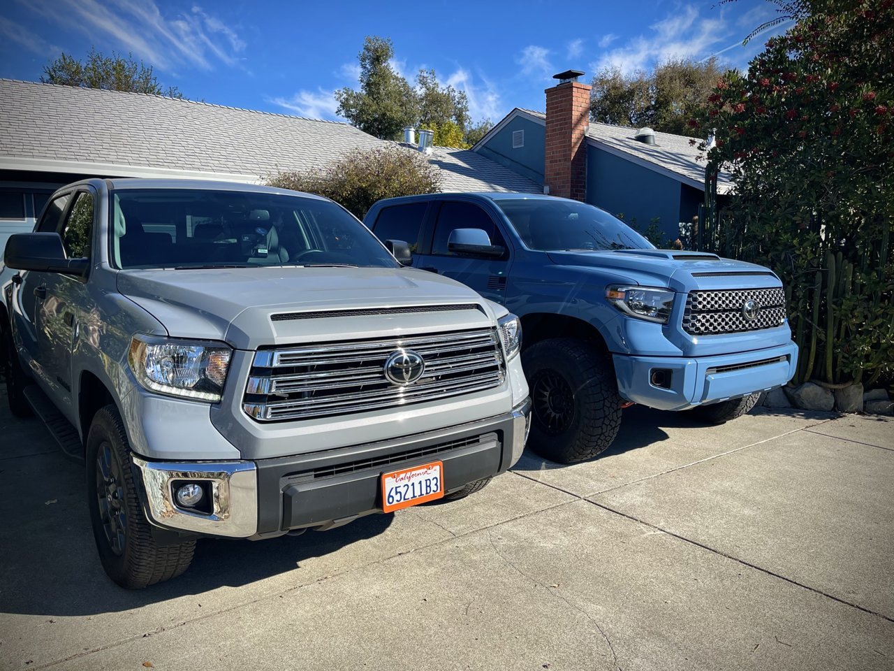

    5100’s top clip
    2 coach builder shims on driver side
    1 coach builder shim on passenger side
    +2 coach builder shackles for the rear
    RRW 17” wheels with 35x12 falken wildpeaks
    tundra_uso, MER, The Dude and 2 others like this.

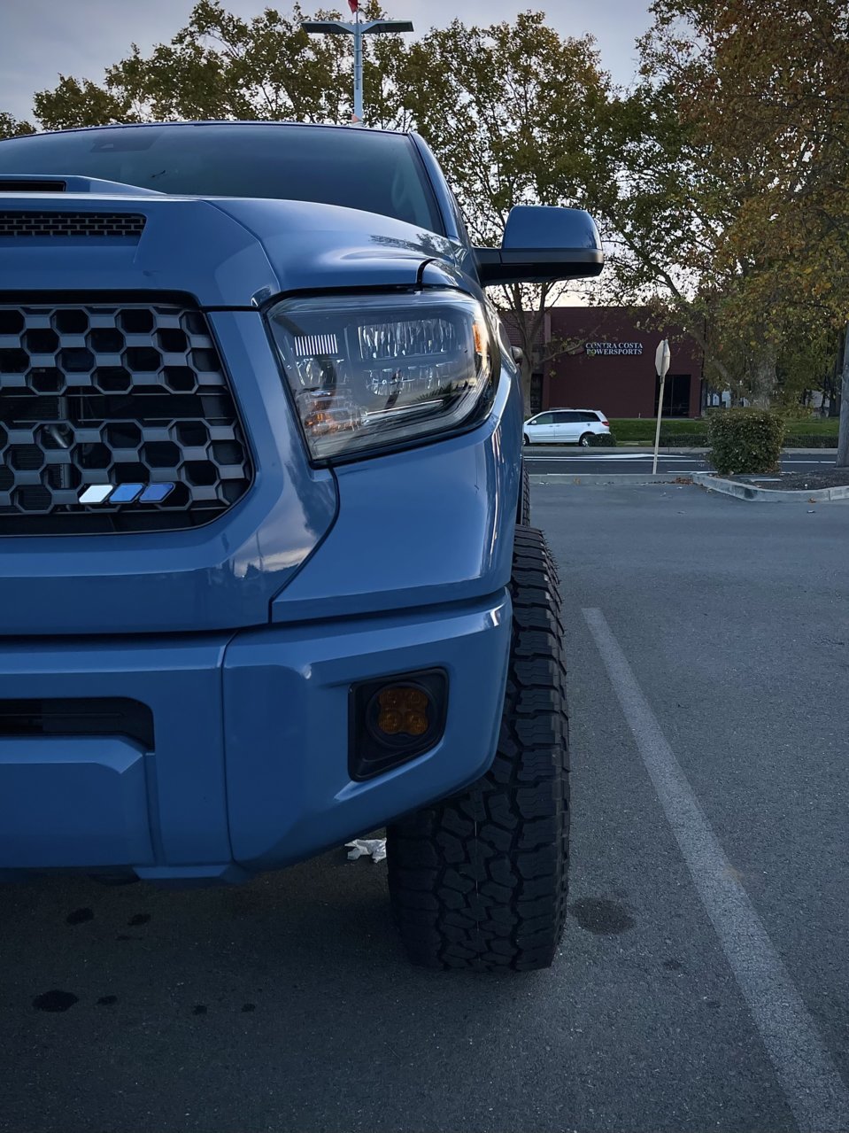

    I love your setup! Couple of questions:
    what size shackles are you running in the back?
    what size shims are you running in the front? Why did you do 2 on the driver side?
    Any issues? How is the ride overall?
  9. Mar 5, 2023 at 10:43 AM
    Toe404
    Toe404 just a poser
    Jan 27, 2021
    #58285
    559
    Tomas
    Concord ,CA
    '21 Cavalry TRD Sport CM

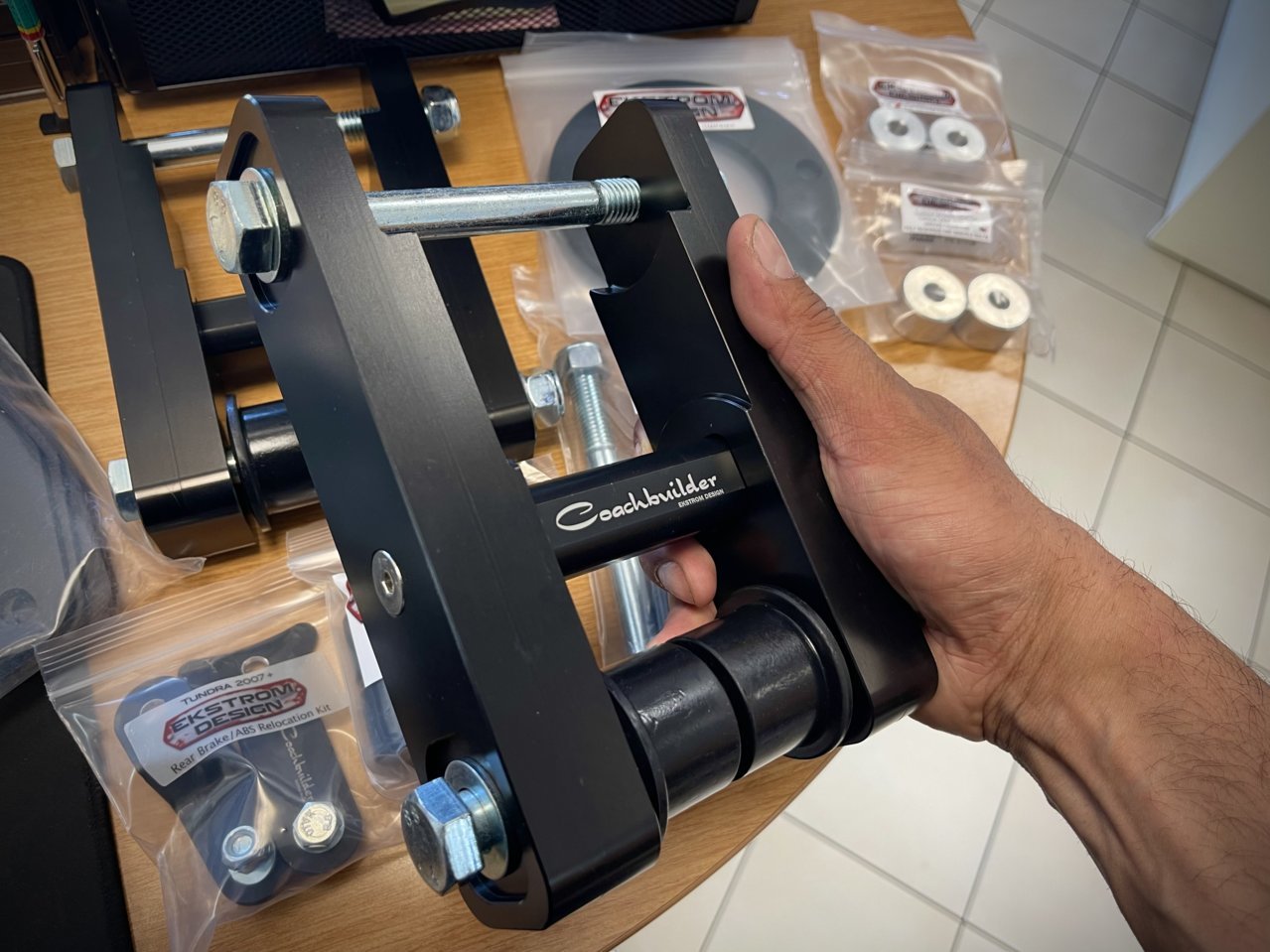

    the shackles are +2
    The shims up front are .5” thick each. The driver side gets 2 to compensate for the “driver side lean” which is due to the extra weight of the battery and gas tank.
    ride quality is great, stiffer than the standard TRD sport suspension but that’s cause I’m on the top clip so there is more preload on the spring

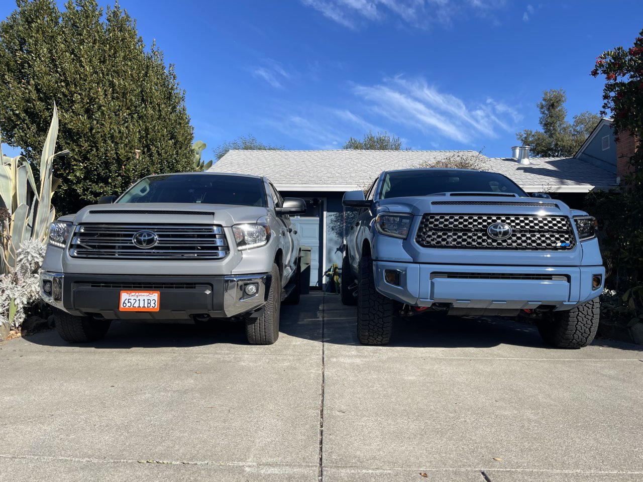

    side by side comparison to my parents 21 trail edition

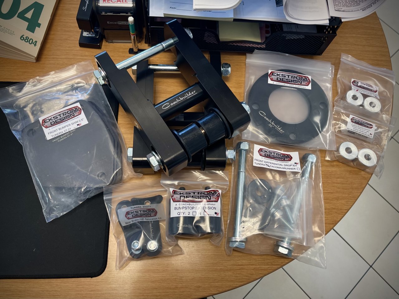

    https://shop-coachbuilder.myshopify...ilder-2-shackles-provides-1-25-of-actual-lift
    3 of these? https://shop-coachbuilder.myshopify...ilder-strut-coilover-shim-provides-50-of-lift

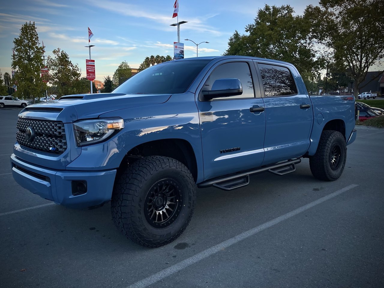

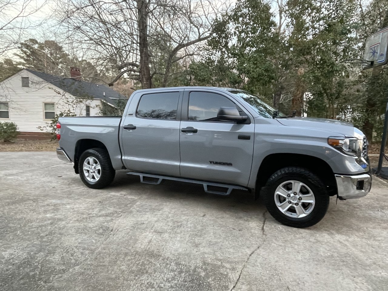

    46A6566A-0C89-4AE7-A514-CABAA15AA0F2.jpg Middle setting, stock rear.
    vokeydawg and ATV25 like this.

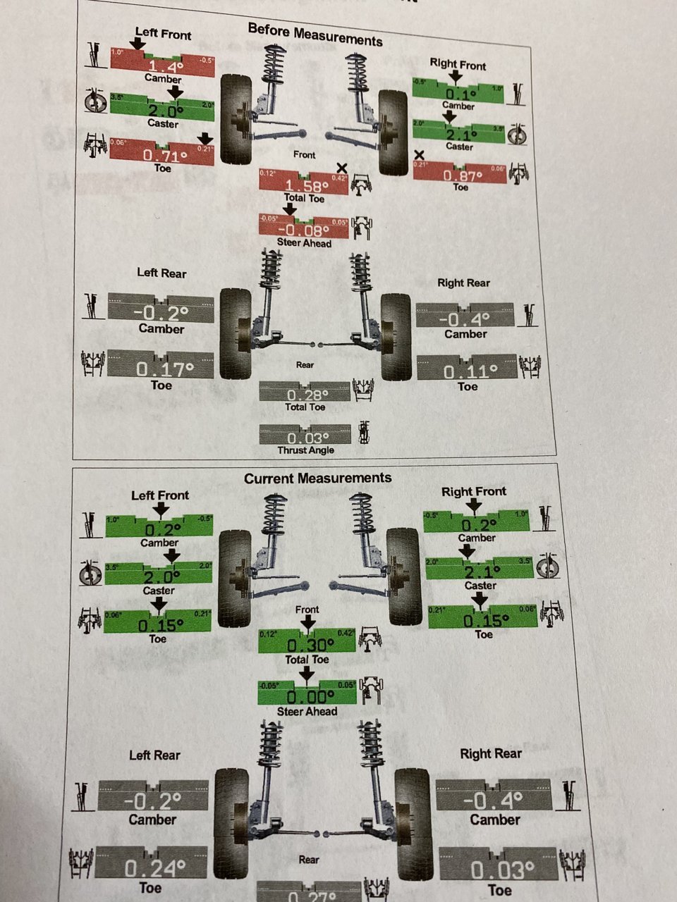

    OEM, no issues. Here’s a pic of my alignment specs. The fact that the wheels are zero offset helps a lot with clearance of the UCA’s.
    just the 5100’s nothing else was added. Although I also did the coach builder carrier bearing spacers.
