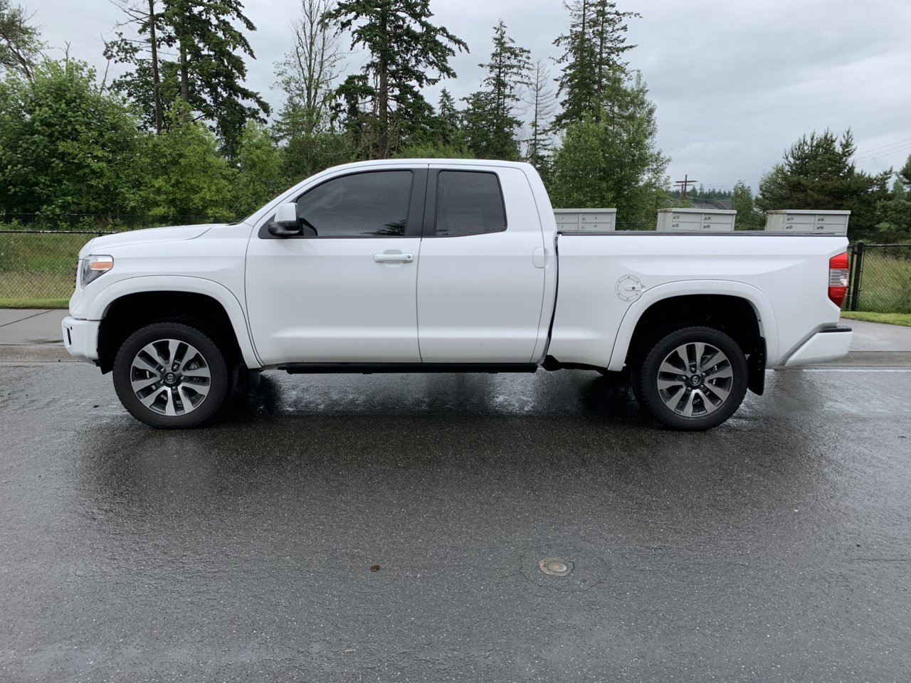

    That is what I did on a new set I think they put raised the front 2.5 and the rear 1. I still have the factory tires and decided to not align..
  8. Jul 15, 2020 at 9:21 AM
    Tchase
    Tchase MostlyLurk
    Sep 14, 2019
    #36090
    642
    Buckley WA
    2019 White Tundra Limited
    In work

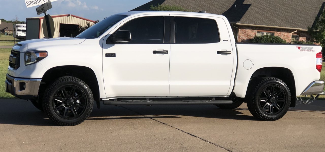

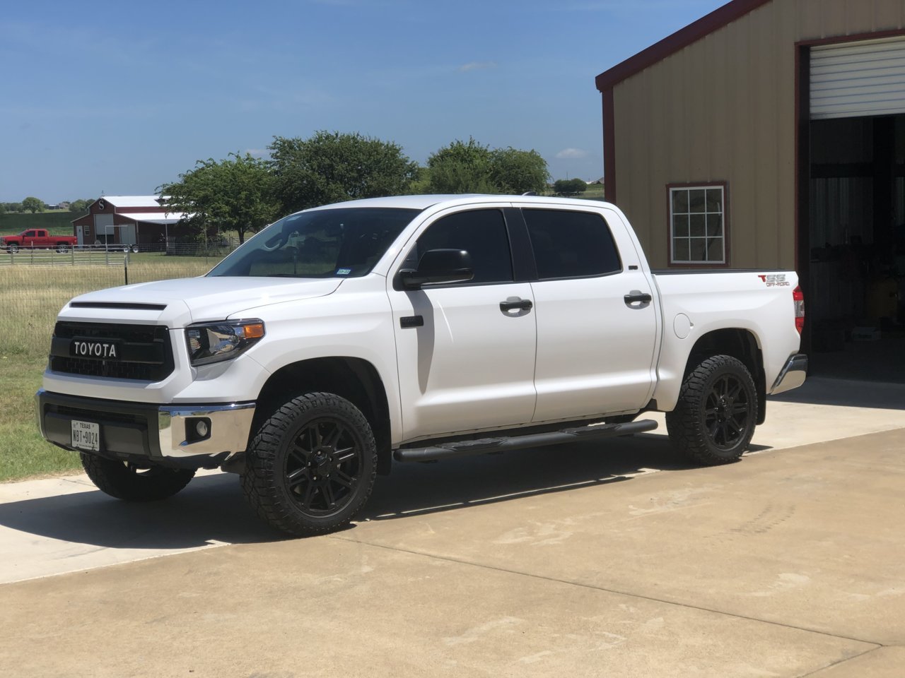

    A26CC6CC-47B9-4233-B3AA-4EE0404F7D12.jpg DB16B4B7-BBC4-4C62-BD4B-D5B6B0961224.jpg Installed Bilstein 5100 on all four corners the front struts are on the top notch which gave me pretty level set up, my rear fender wells sit 1/4 inch higher than front close enough for me. These are stock TSS rims and Tires in my 2020 CM
