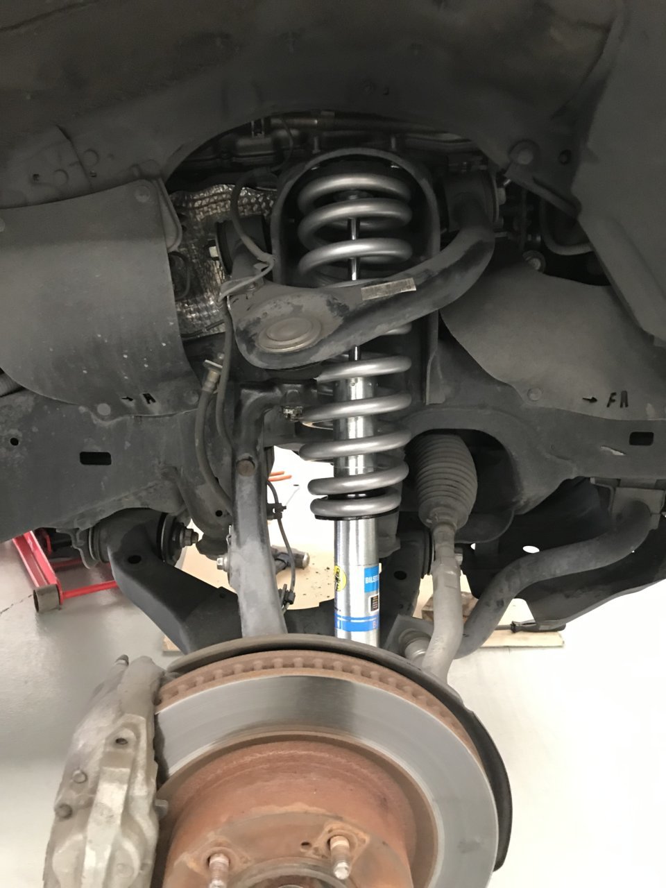

    5100 with eibach I installed last month. Smooth setup.

    Using the bottom setting with the Eibach Spring sets you around 2.8" ish. It will settle a bit. Rides pretty good.

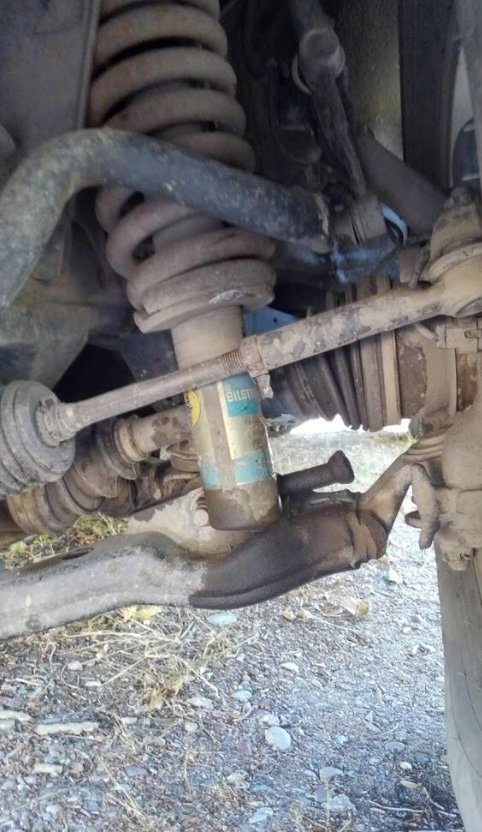

    I’ve heard of 5100s popping off their ring setting but have never seen proof.

    Only time I heard of that possibly happening is when they install the cups upside down. Almost looks impossible for the clip to pop off if it’s encapsulated in that cup, but I’m sure anything could happen.

    If your shocks are breaking it's bc they are bottoming out HARD. That's what the bump-stops are for though. To have the susp bottom out on the bumps and not on the shock.

    Are these the 2" lift coils or the 2.5" lift coils you used? Im about to go the same route but having a hard time deciding which coils to get.

    These are the 2.0”
    I think eibach recently released the 2.5” I have no experience with those yet. The 2.0” works well with the bilstein keeping it under 3”. If you do the 2.5” lift spring u will be sitting around 3.25”. Give or take with whatever extra weight you have up front.
