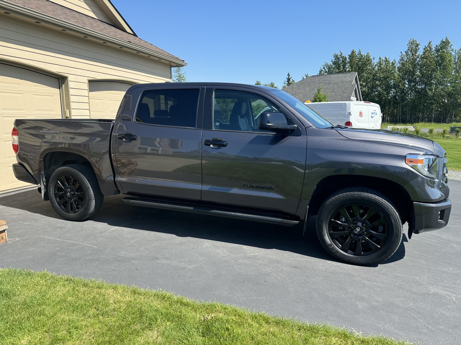

    Ok, I have researched the hell out of this forum and Bilstein 5100’s to gain a slight lift (mid setting is what I’m leaning towards) and better ride for my 21 Limited Tundra non-TRD. I’m looking to eliminate the ‘rolly’ soft ride. I’ve seen folks add TRD sway bars too to help. Main question…are the Bilsteins the best way to achieve lift and a stiffer ride or do you have a better shock recommendation other than Bilstein?

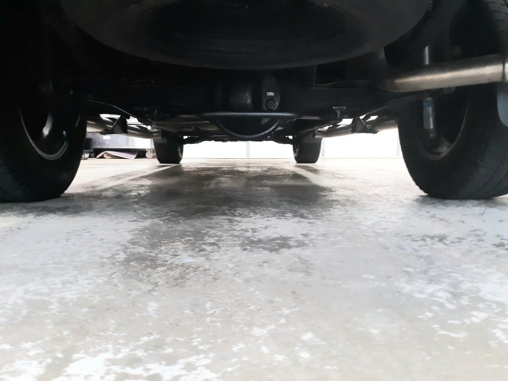

    Resized_20240707_072353.jpg Don't forget to include the Hellwig Sway Bar in your research. It's thicker and 'lift adjustable' but it ain't that pretty red color!:D
