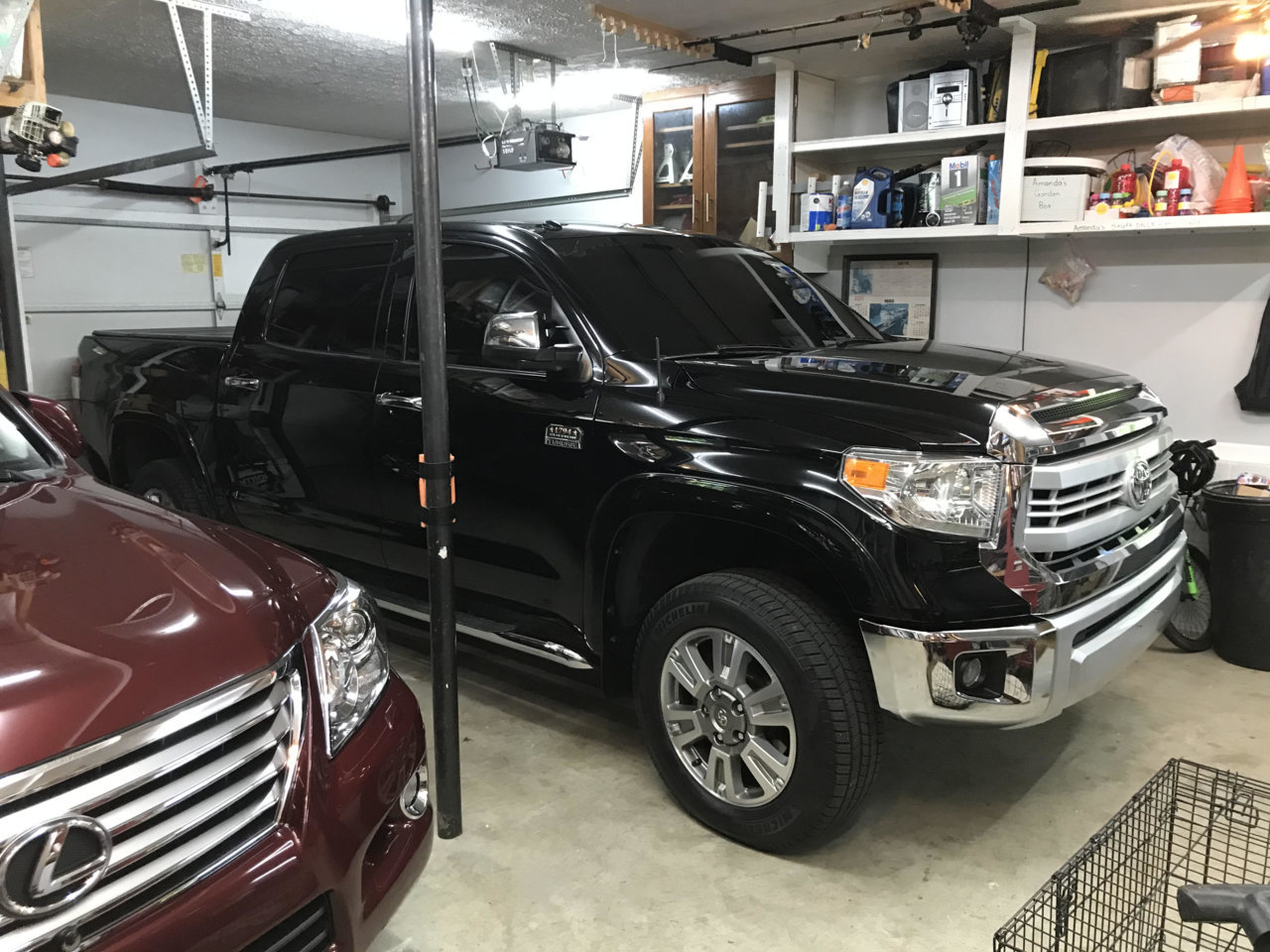

    Greetings! Seeking some advice. I just purchased a 2014 CM 1794 4wd with 165K miles on it. It has the original black OEM shocks. They have no visible oil leaks. Truck has a 2.5/1.5 leveling kit on it. It is primarily used on the road with a weekly 300 mile highway trip. I'm considering replacing shocks solely due to the mileage on the current shocks.
    1. Are stock length shocks okay with the leveling kit?
    2. I have the opportunity to purchase a set of new take-offs (31 miles on them when removed) Bilstein 4600's for $100. Are these "better" than the black OEM's? Will I notice a difference vs. 165K miles on current black OEM shocks?
    3. I just had my truck aligned, will I need to align it again if I replace my black OEM shocks with replacements that are the same height/length?
    Thank you!
