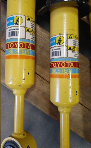

    I kind of feel like an idiot. I bought the shocks and I "assumed" they were 4600's but they may not be. They are yellow and blue and say "toyota" and "bilstein" on them. Are these 4600's or just look alikes? Here is a pic.

    Those are TRD off-road shocks which are a rebranded 4600.

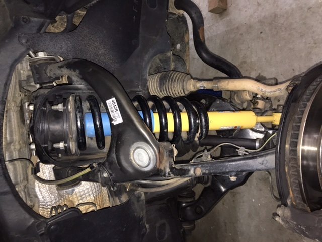

    Swapped em out today. Big improvement. I believe it’s mostly just because the old shocks were worn out. They didn’t rebound when compressed after being removed. Here is a pic of the new ones installed. Rides much better. Thx y’all.

    Don’t worry about brother it happens...like the posters said above they are TRD Bilsteins which are very different than the 4600’s outside of color. I spoke to Bilstein many years ago and the internals are similar but not exact and the valving is much different. The TRD is much softer and has a better daily driving ride whereas the 4600’s are stiffer and geared to handle weight better in my opinion.

    That may actually be a blessing in disguise. I am a fan of how the truck rides/drives since swapping these out. I'm not a guru by any means. I think I basically just replaced my shocks but didn't "updgrade". If the true 4600's are stiffer than these, I may have not liked it as much. I drive a lot on the interstate and so far, I really like the way my truck drives with these 4600 look-alike's

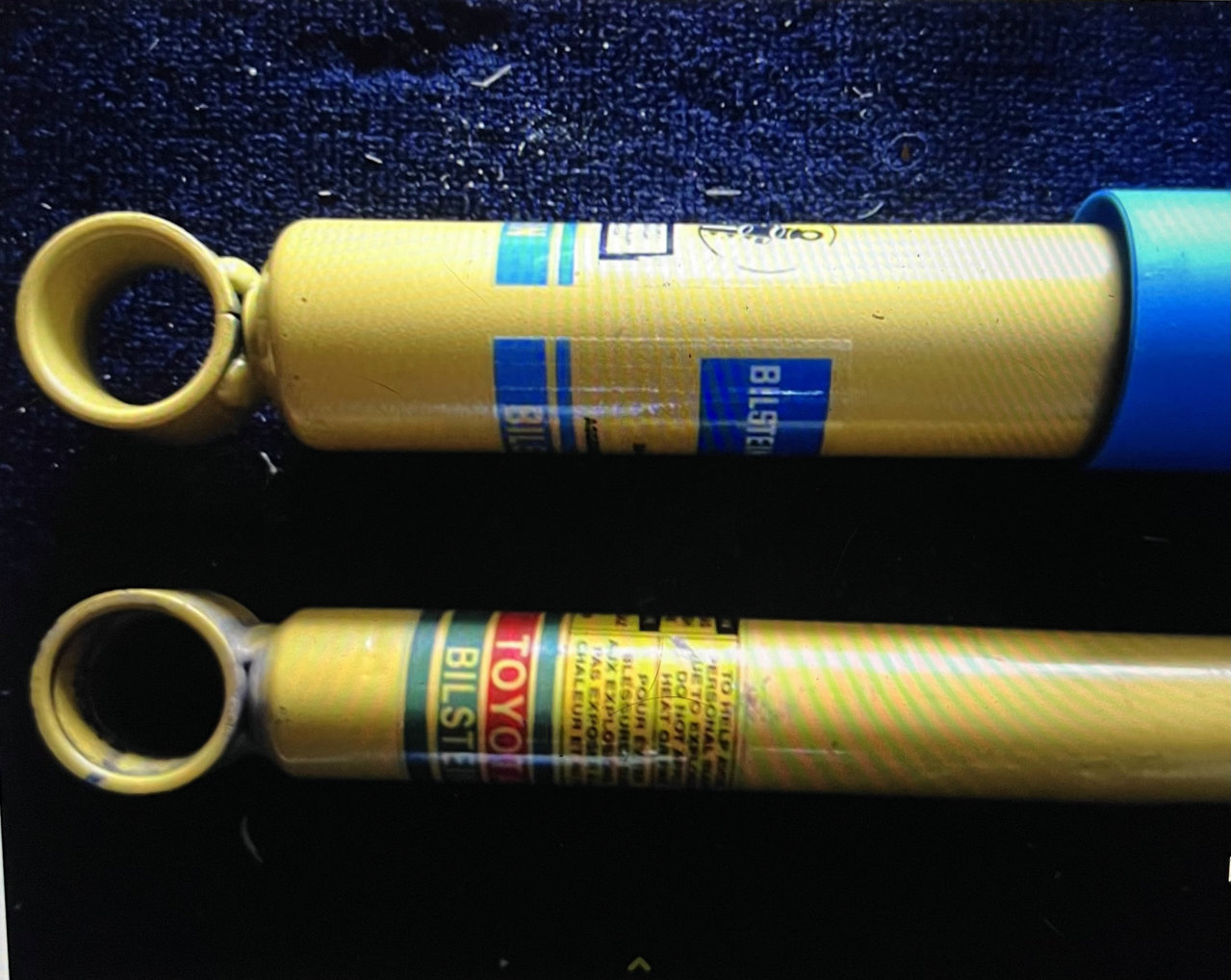

    The 4600's have a larger diameter. I have the 4600's and do not consider them stiff. The ride feels more planted and not as "floaty" as the TRD off road shocks. Here is a comparison photo of the diameter. Length is the same.
