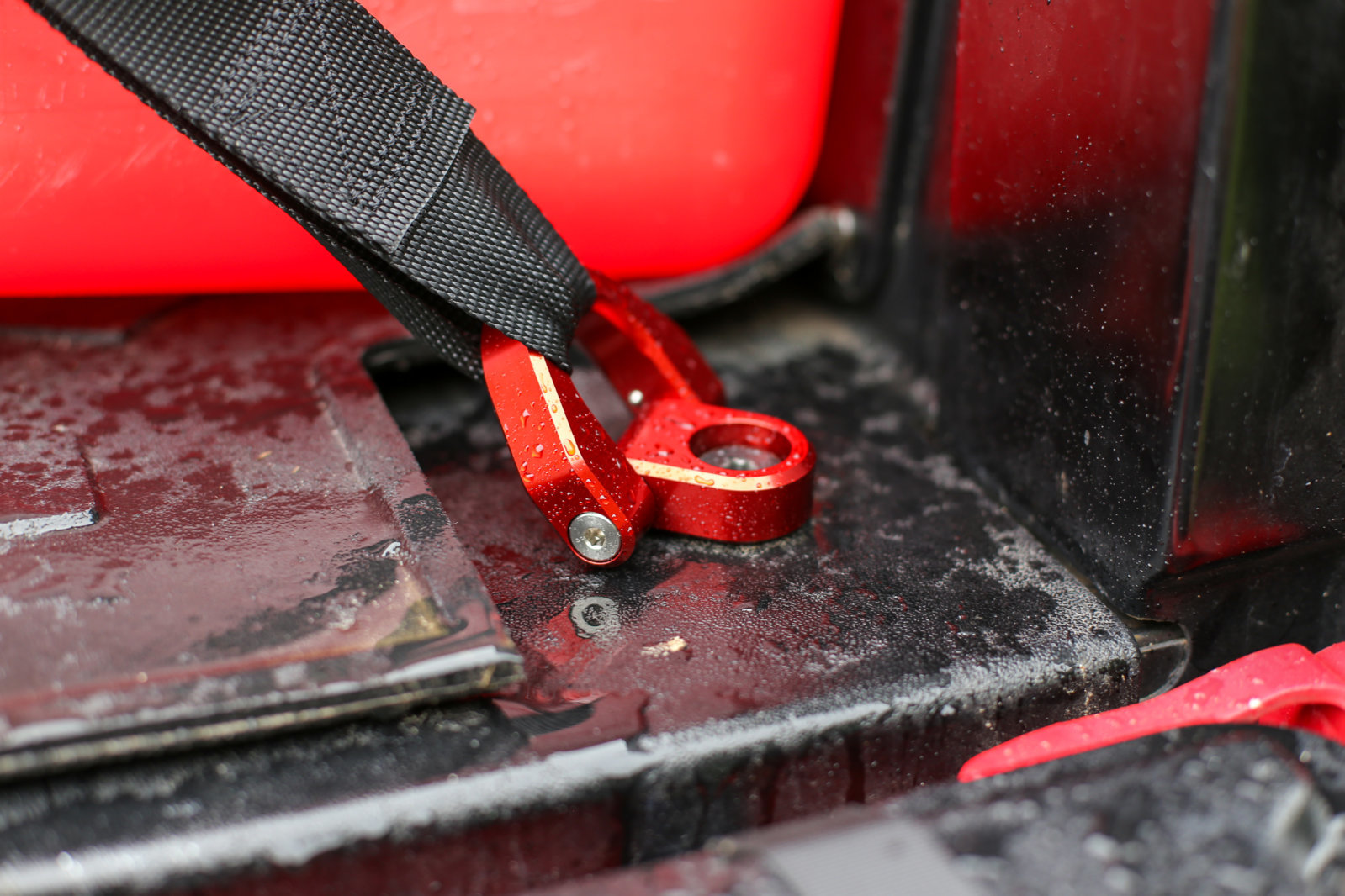

    EDIT - These are now available! https://billettiedowns.com/products/d-rings-for-toyota-tundra-pair-1

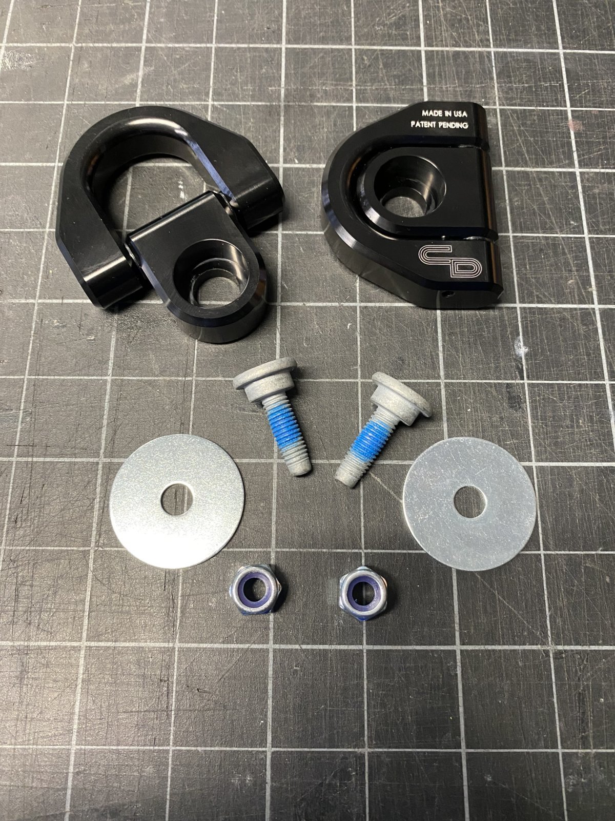

    I ended up designing a custom mounting plate that spreads the load and fits inside the rib of the bed.
    Billet Tie Downs D-Rings follow the same design language and color scheme as our current Bed and Rail Tie Downs, so you can complete the look with these CNC machined Billet D-Rings.
    • Machined from durable 6061-T6 aircraft-grade aluminum
    • Anodized in Red, Black, Blue, or Silver, these Billet D-Rings will add a splash of color to an otherwise dull and boring truck bed
    • Radius prevents dangerous cutting and fraying of ratchet straps, bungee cords or rope
    • Corrosion resistant stainless steel pivot bolt boasts a 70,000 psi tensile strength
    • Marine grease is used during assembly to prevent corrosion and provide many years of trouble-free service
    • When stowed in the closed position, the spring-loaded ball detent keeps the D-Ring from rattling while driving down dirt roads
    Sold in pairs
    PATENT PENDING

    Those look great. My only feedback in regards to the bolt is that I’d prefer to use the stock bolt locations and be anchored to the frame. If the M8 is the more cost effective option, though, at least the 2.5 and older gens have steel beds instead of plastic…

    Thanks for the feedback! Which stock bolt are you referring to? The bed bolt?

    Yep… and I just looked at your photo where you have one mounted on what looks like the corner of the bed and realized these might be smaller than I originally thought. So my comments are completely irrelevant lol. What are the M11 bolts for and where do those live on the Taco?

    Yup, so Tacomas have a separate spot just for the factory D Rings, and it uses a special bolt. The bed bolt is to the left under the bed mat in that picture. I wish they would have just put factory D Rings on Tundras!

    I have similar concern with the thickness of the bed steel and pull-out strength of the tie-downs using a single bolt, even with a fender washer as backup. But I also completely understand the issue with using the factory bed bolts (both thickness vs the bed ribs and the size of the bolt head). Perhaps a thicker plate washer backup - say 3x3x1/4 - would ease those concerns.
    I have no issues with drilling a couple holes in my bed. Putting a set of these near the front will prove a bit challenging over the gas tank though (thinking fore and aft of the wheel wells) - but not impossible.
    Because of my tonneau cover, I don’t have the factory rails on my bed sides. I would love the shit out of having a set of these that would mount to the holes where the bed rails mount, since I currently have some cheapo scamazon steel ones mounted at four of those points. I forget what size those bolts are though.

    Just realized I missed your response, thank you! We're thinking the same thing regarding backing plates. I ordered the factory Tacoma D-Rings that are meant to be added because they come with plates. I'm going to look at these and most likely design my own to fit inside the ribs of the Tundra bed.
    Unfortunately the rails are held on by m6 screws, so the D-Rings would not fit there. My hardware is M8, and I feel m6 would be pretty undersized for these.

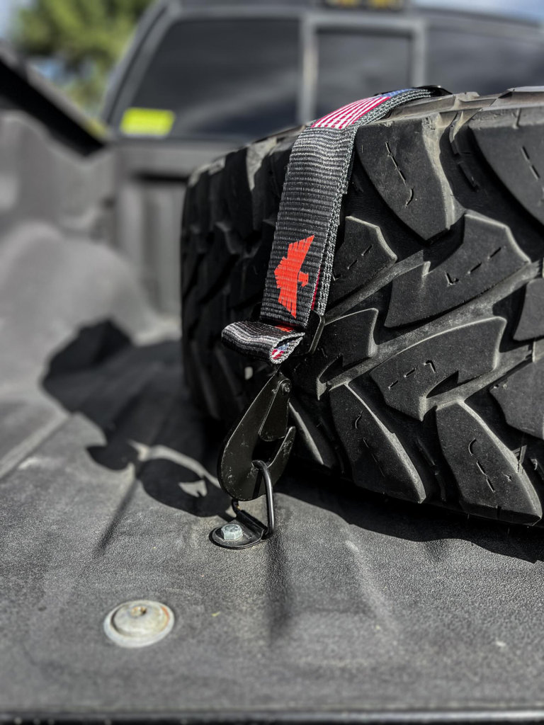

    I just upgraded my Tundra's tires to 37" and will have to carry my spare in the bed. Will your d-rings work in the configuration pictured below? TIA.
    Not my picture.
