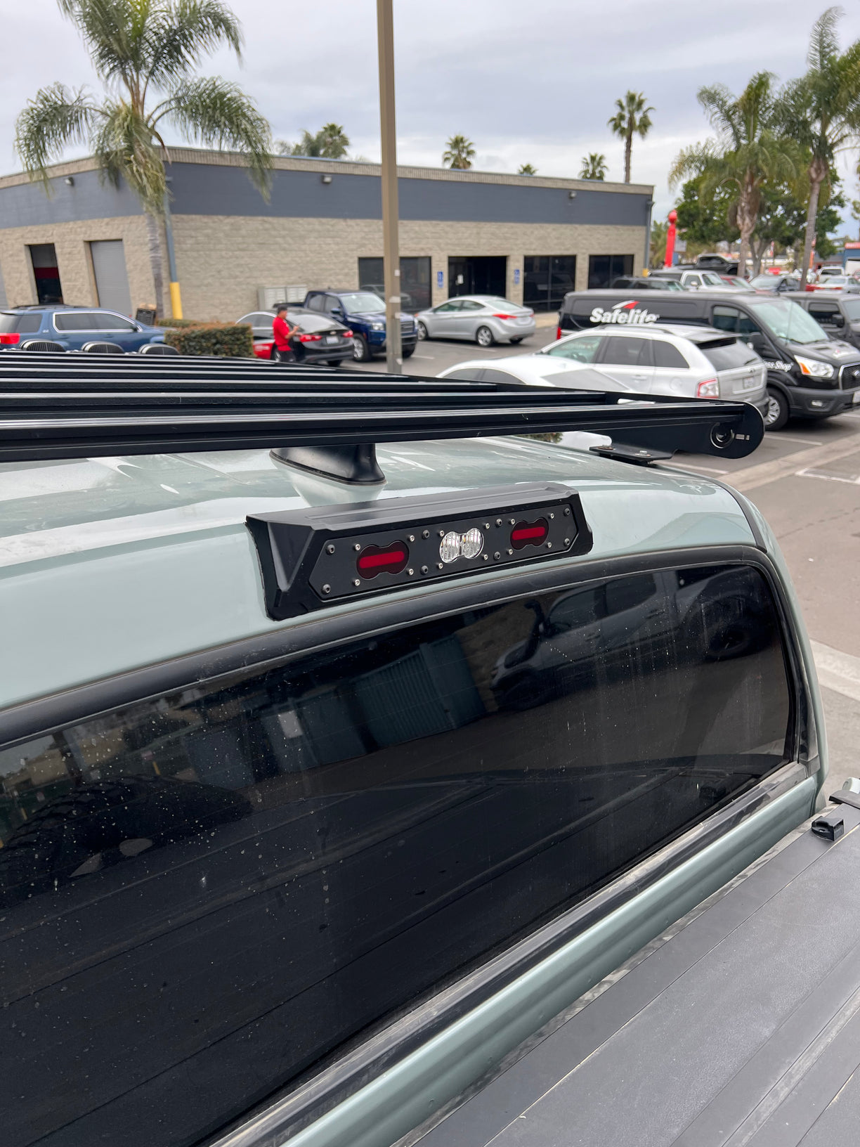

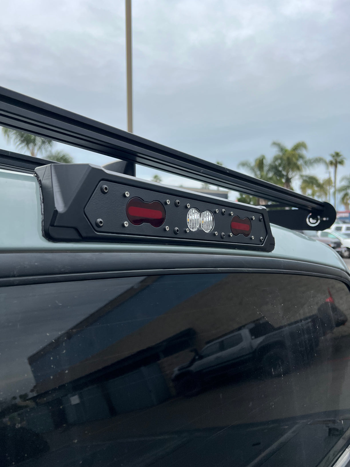

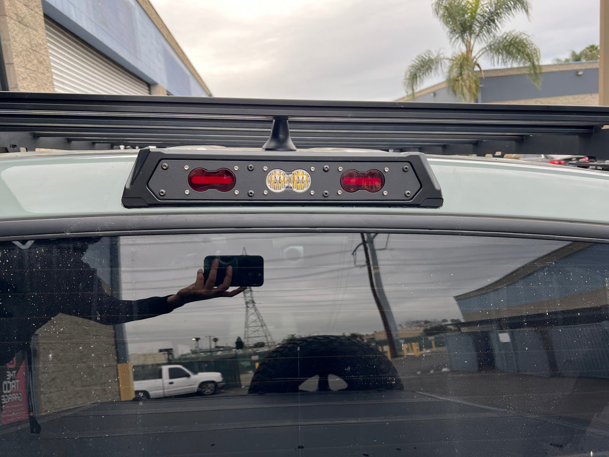

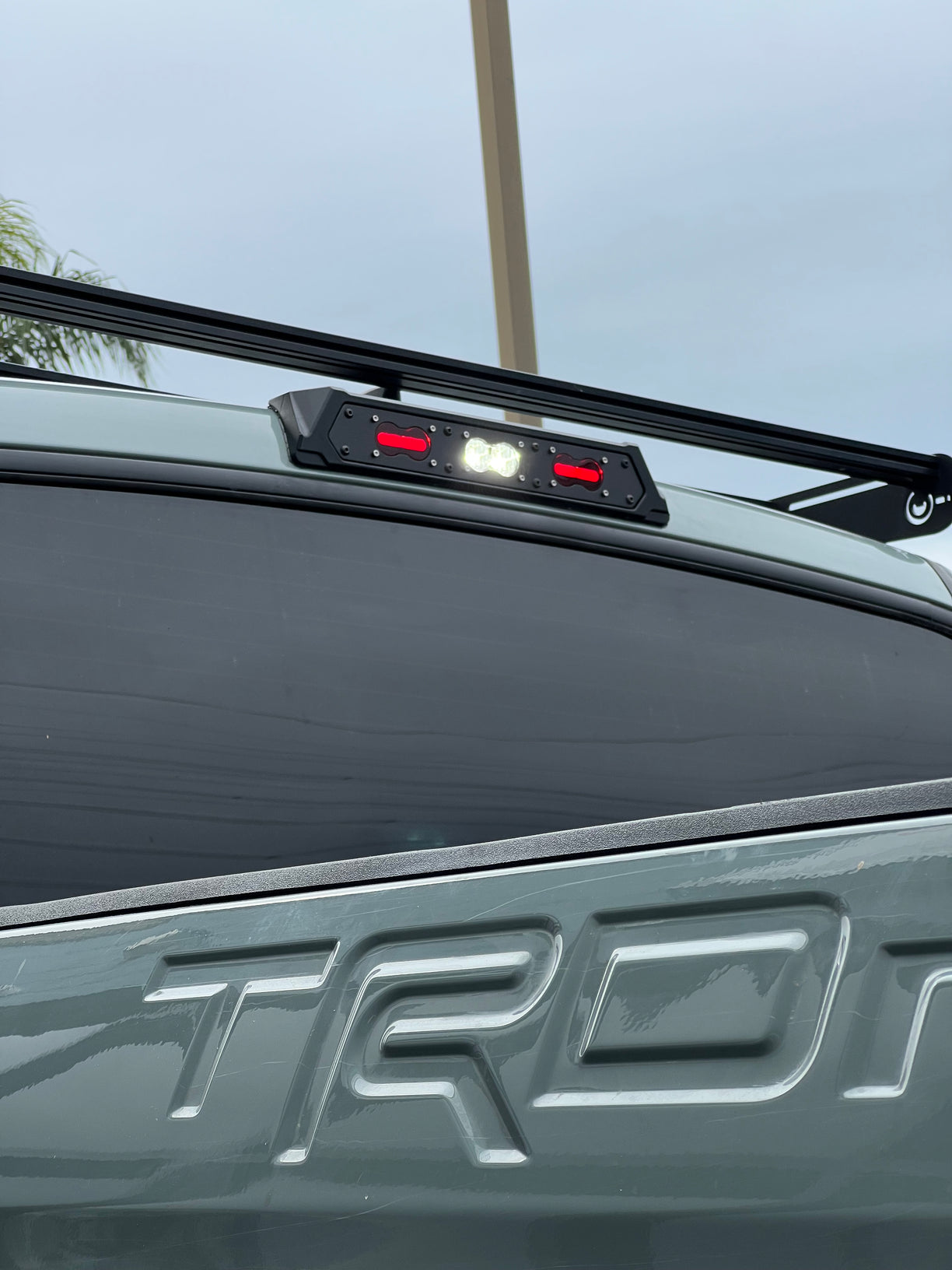

    I’m really excited about this thing we made… I’m gonna let the pictures speak for themselves. Then I’ll do a little write up.
    Purchase link…
    Ok now some boring words…
    We’ve seen the other options and some are great, but we wanted to take it to the next level. So we started designing an we finally have something worth sharing. This this is A SOLID block of aluminum. It attaches using the factory mounting locations and accepts 3 @Baja Designs S2 Lights. The front face is a separate piece for a few functional reasons including making the installation easy. Removal of the original 3rd brake light is accomplished by pulling down the headliner but installing the billet can be done from the outside.
    The S2s can be wired to the original harness but you do need to change the connector, we may make a plug and play harness later. At the time of wiring you can swap the 2 cargo lights and 1 brake light so that you have 2 brake and one cargo if desired.
    This is a new product and we would love to get some feedback. Even if you’re not buying one…
    What do you think?
    Any questions ?
    What would you change, add or remove?

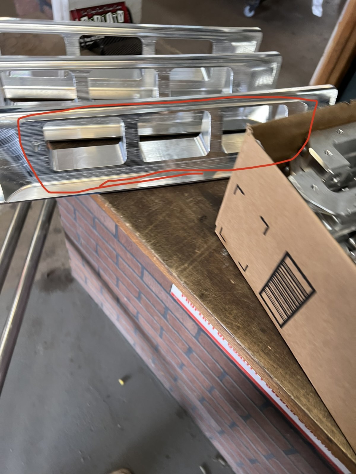

    There is a flat surface behind the housing in the area surrounding the lights and mounting bolts. There is a matching flat surface on the cab side that surrounds the hole that is cut into the cab, the main seal is accomplished at this surface, we used silicone to seal that entire area. Then the perimeter of the housing was again sealed with silicone to prevent water even getting into the inner seal, also fills any gaps that may be present from roof to housing.
    I’ll get better pictures later but here’s one for now…
