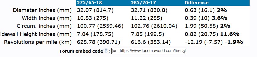

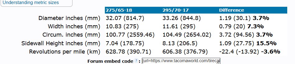

    Gotchu So i should be good with putting a 285/70r17 on the rock warrior wheels. correct? would a 295/70r17 fit without rubbing???
