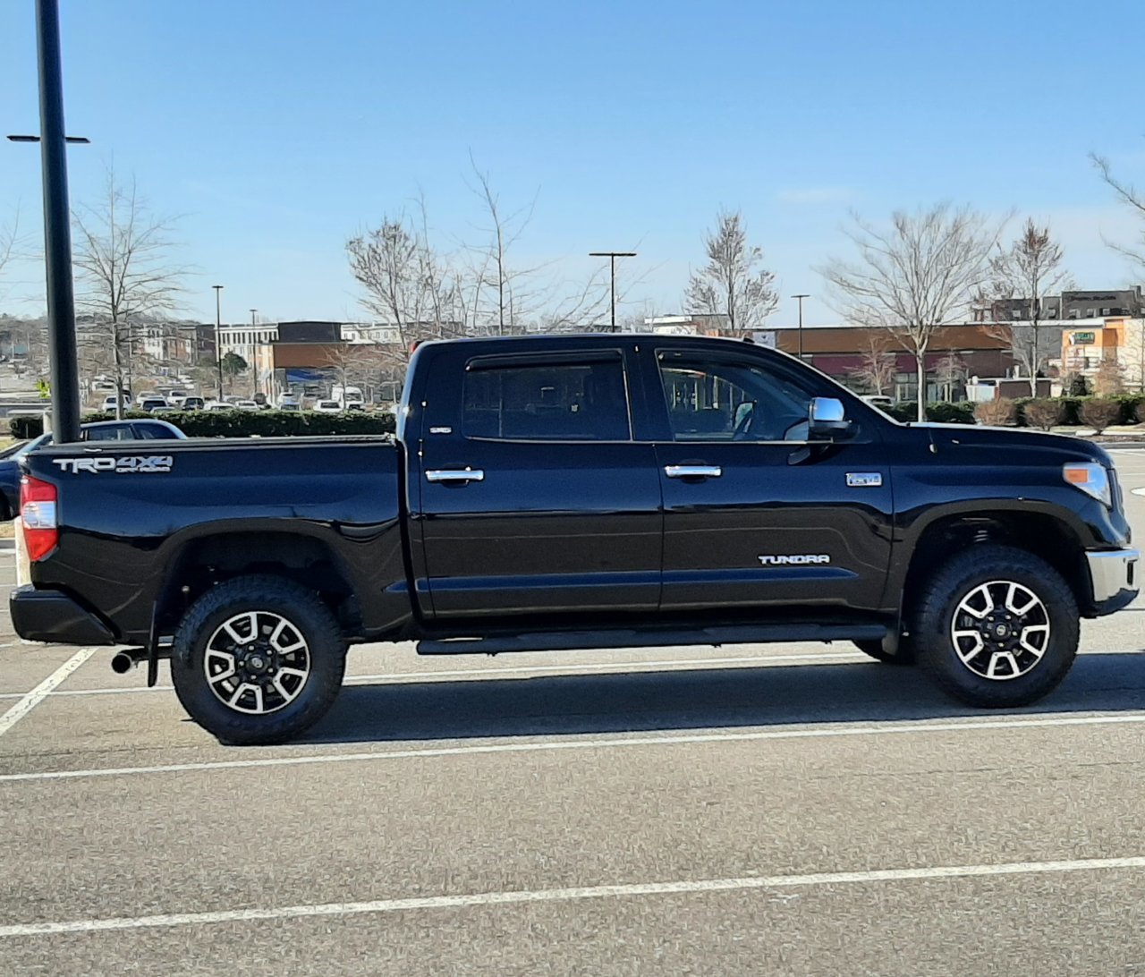

    295/70s and 285/75 in 18s both will work with that setup. OME tends to run higher lift than advertised, expect about 2.75 lift. If I had that setup I would be running 285/75s. I could actually fit that size now with my 2/1 lift. For reference, here is my truck with 275/70-18 and 2 inch lift front, 1 inch rear.

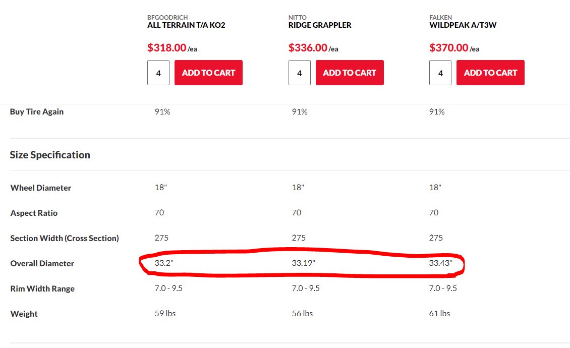

    Check various brands and tire models within those sizes as well. Not all are true to size. Go to Discount Tires website, put in the 275/70R18 size and pic some tires to compare. Then you can see that they vary within that size. I can tell you that on stock suspension the minimal difference between the Ridge Grapplers and the Wildpeaks is enough that I had rubbing and another guy didn't with identical wheels and suspensions.

    Truth. I had Coopers before my current Wildpeaks, same size, and the Coopers were visibly smaller, height and width. Wildpeaks 33.4 tall fit just fine stock however. Not all tires of the same size are actually the same size lol.
