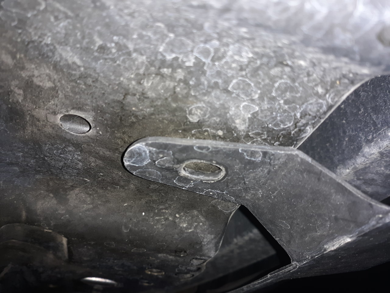

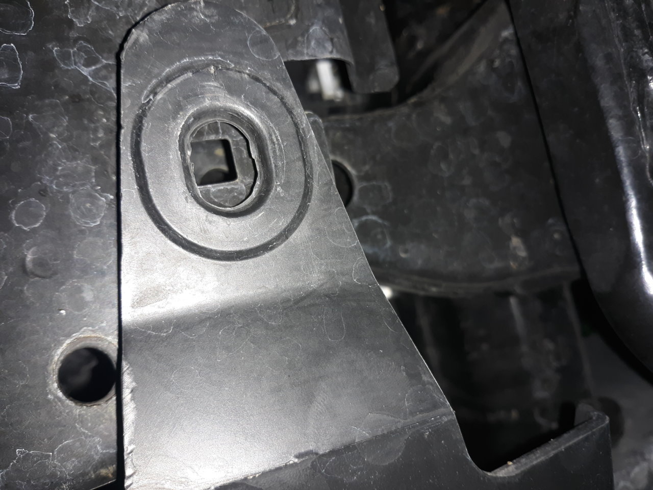

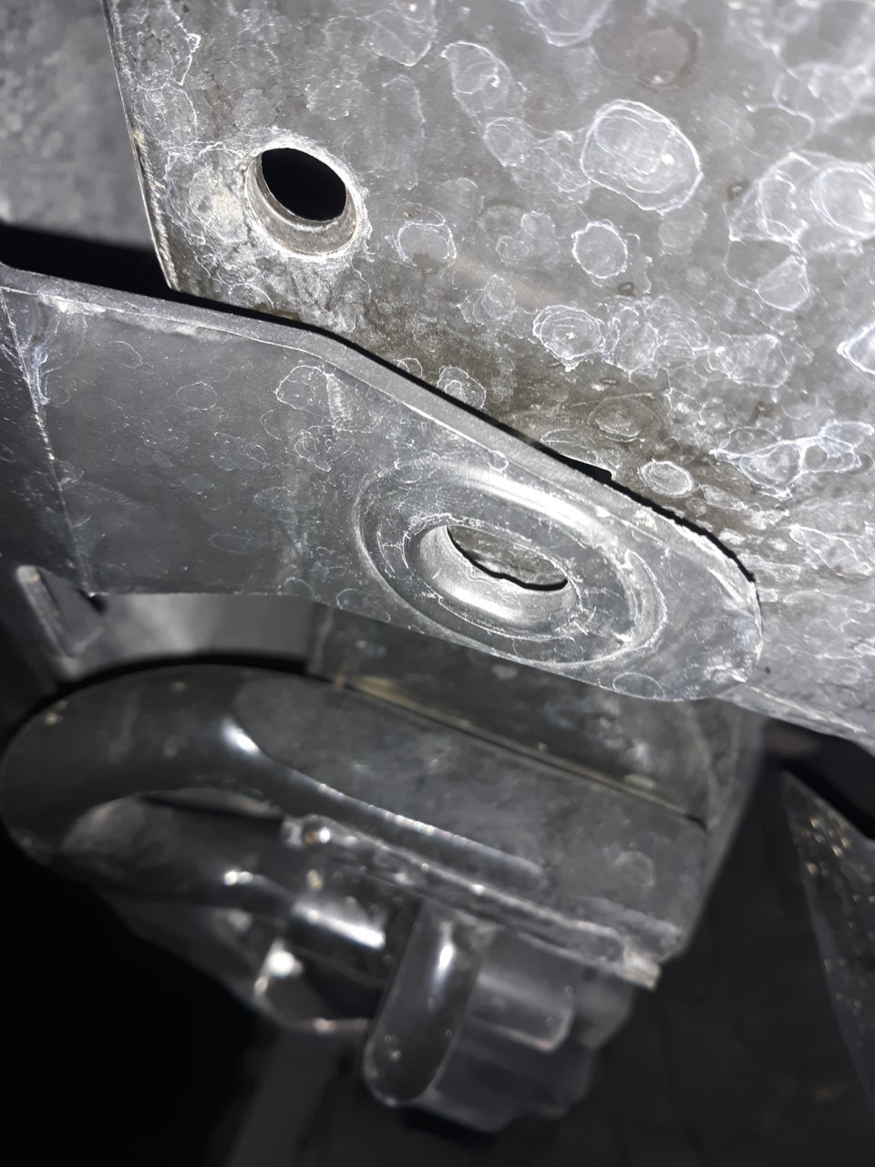

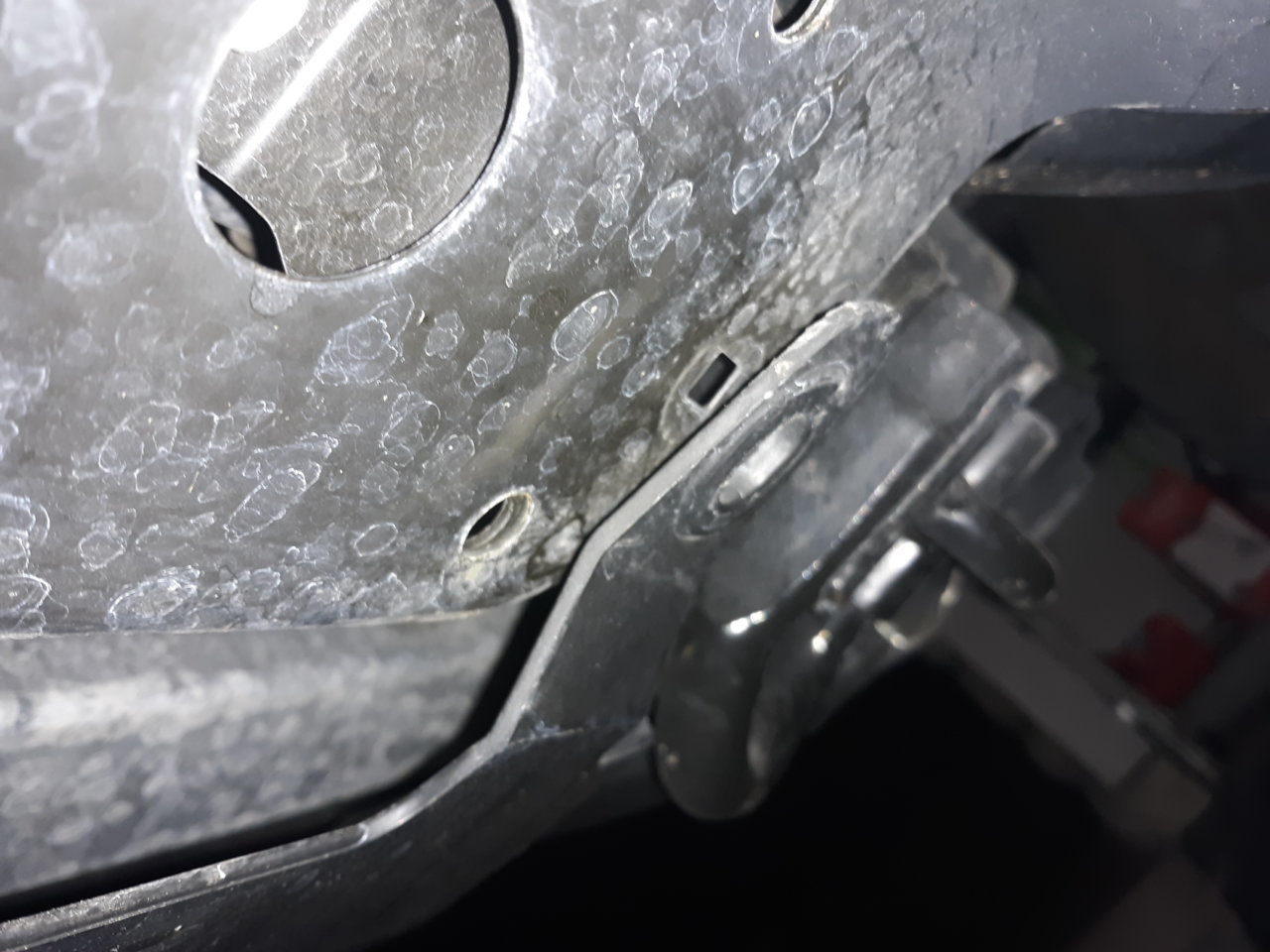

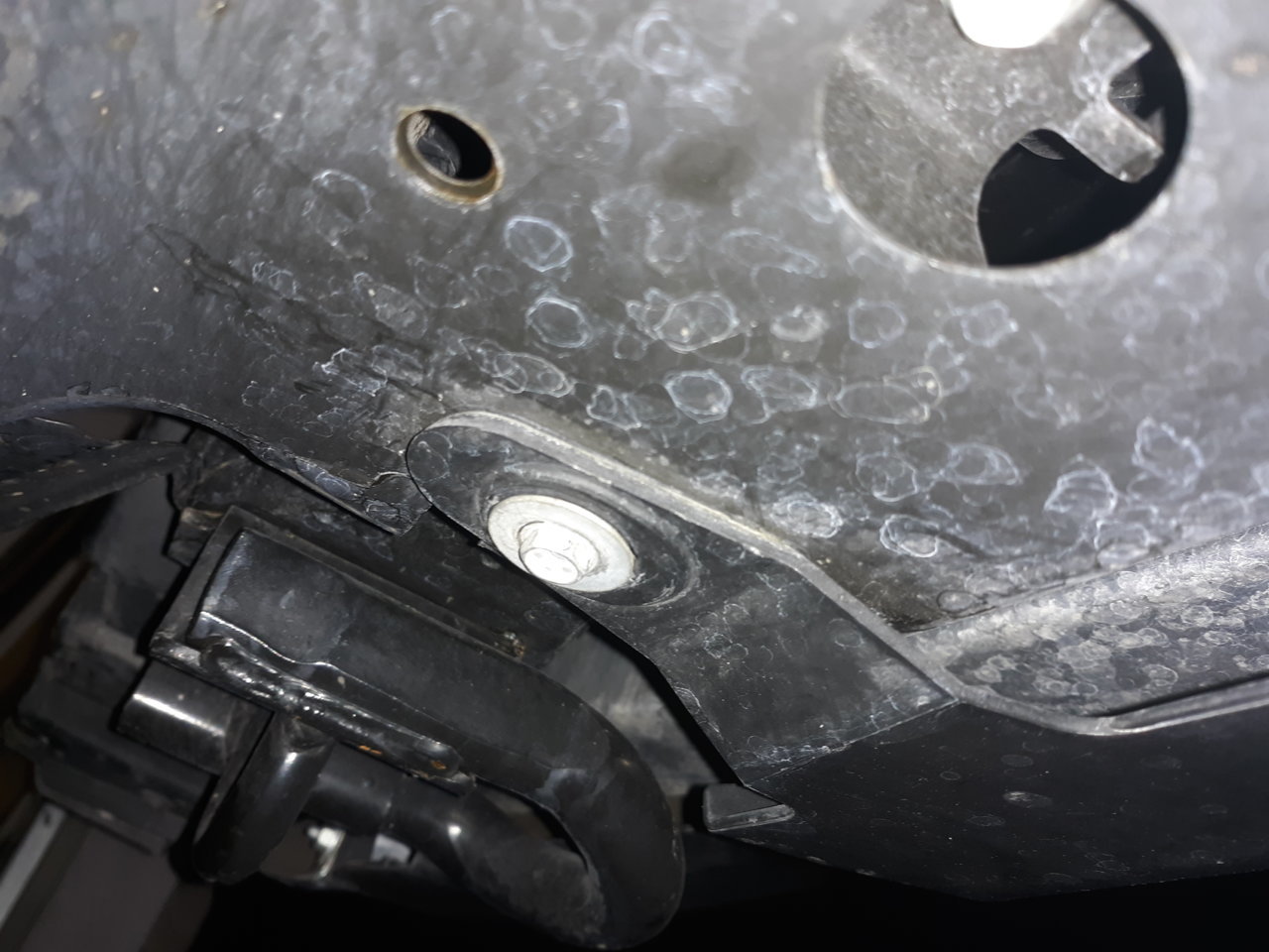

    DOLAN TOYOTA RENO NV. So I got my first free oil change at this dealership. ONLY because it is free, truck hit 10k. This was Wednesday. So tonight had to get under my vehicle and surprise surprise another dealer u cant trust. This is not the dealer I bought my truck from. I bought my truck in Redding ca 100 miles away. Going the other way is Dolan toyota of reno 80 miles away. These are the 2 closest Toyota dealerships to me. So I have 2 bolts missing from the front bumper to the skid plate witch have to be taken off to change the oil there is a totall of 3. First thing I did is check my oil. That was good and clean. Now i am wondering if they changed the oil filter or if there is one in at all. I usually NEVER take my truck to a dealer unless my mechanic cant work on it or is a warranty item. This time because it was free and had to go to reno anyway. So tomarrow i will be calling and be a real Dick. And forward the pics to toyota.

    One of my bolts was missing after my first oil change too. I didn’t call and complain about it.
    So you think they lost the bolts removing the skid plate to get to the filter and then didn’t change the filter or took the old one out and didn’t put a new one in? You don’t have to remove the skid plate just to drain the oil.

    I believe they did the filter. BUT for me if you cant even remember to put 2 bolts on that are right in ur face with the truck in the air. And I know for a fact these 2 bolts were there because I changed my oil a 5000 miles my self. They didn't just drop 2 bolts and couldn't find them. Now I know at most dealers they don't have there master mechanics doing oil changes especially this one its huge. But I do expect better than jiffy lube.

    The stock skid plate front three screws, screw into plastic inserts. They strip out really easily. One of mine was stripped from the factory. I made them give me a free one. Then I bought five more just to have in the toolbox as I’m sure they won’t last forever.

    Stripped or floating and fell off. Also make sure the hex bolts with the spacers are torqued tight too, they can rattle off and the next thing you know the skid plate is hanging. Don’t ask me how I know. Gotta get me an RCI one day with oil door.

    I am not defending leaving hardware off someone's $40,000+ truck, but I don't know what Toyota was thinking when they used those plastic inserts to hold those front three bolts. I am betting the "skilled technician" was in a hurry and stripped the plastic retainers, so he just said "to hell with it" rather than replacing them like he should have.

    Definitely what happened, probably using an electric impact or driver to put them in and stripped them. That's when you gotta own up and admit your mistake to the head honcho. Those plastic inserts probably cost the dealer .10¢ it's not the end of the world to replace them on a customer's truck
