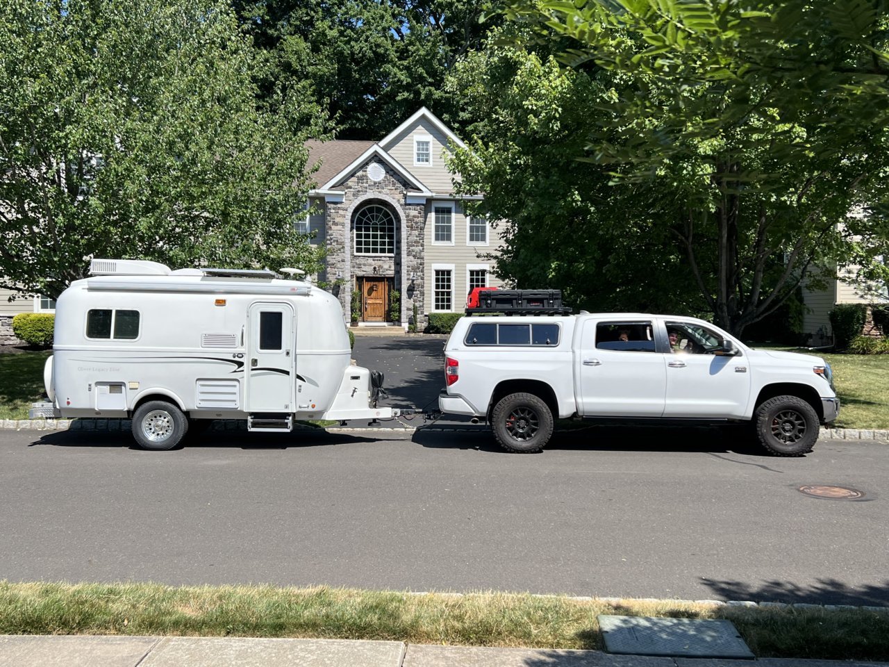

    Before anyone crucifies me.. I don't post here often and have limited experience mechanically. My son will help me with the install. I have tried doing a search and have found a few threads about brakes but need some opinions. I have '20 TRD Sport DC with new Michelin Defender LTX 275/60/20 tires. (the OEM tires only lasted 25K miles) Half of my 30K miles are towing a 6000# travel trailer. I have noticed some pulsing from the front brakes and want to replace rotors/pads fairly soon. My trailer has two 3500# axles and electric brakes. What are some options for my truck since it basically is used for my trailer. I don't do any mountain driving as I'm in the NE but have had to lock 'em up a few times due to asshat drivers. Brake controller set to 7. We do have salted roads(ugh) and I want to avoid as much brake dust as possible. Any help appreciated![​IMG]

    Nice trailer…:spending:..haha….cha-Ching

    I am a Fiberglass nerd.. went from having a Casita for ten years.. Love your Ollie!

    Love the Oliver!
