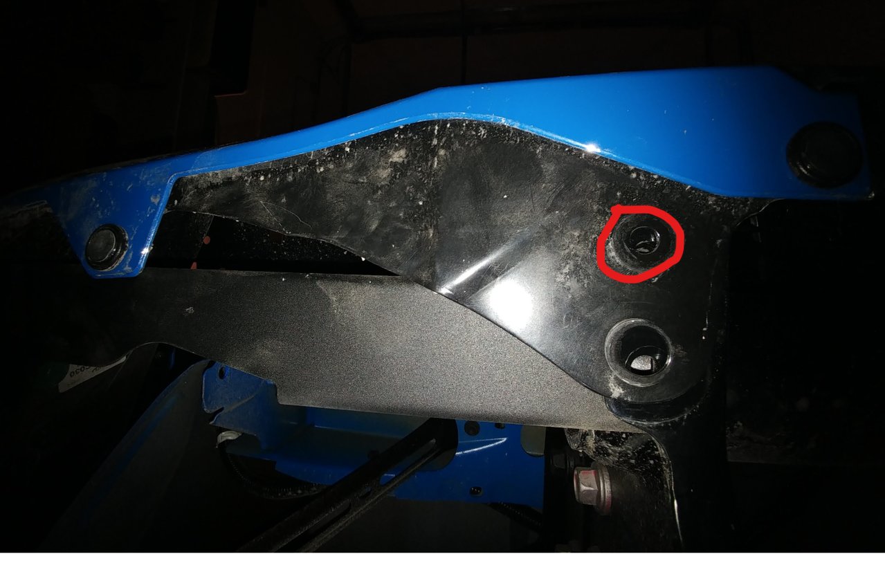

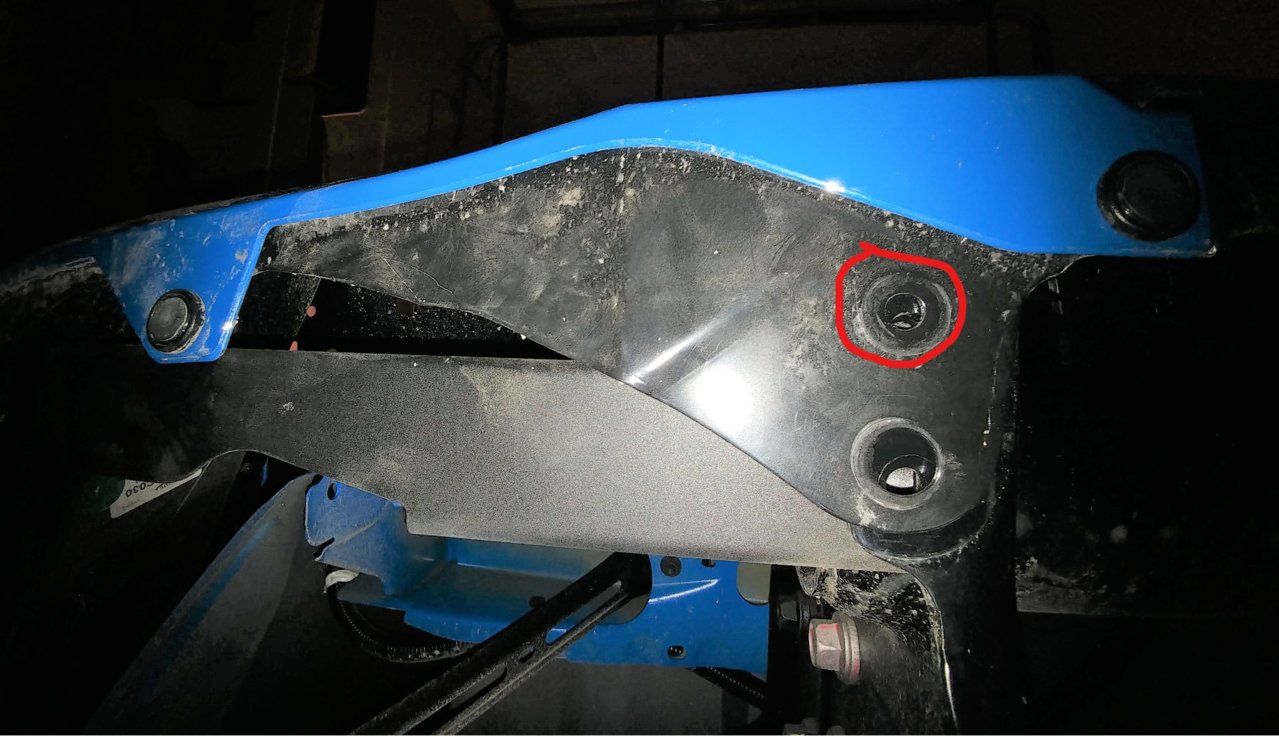

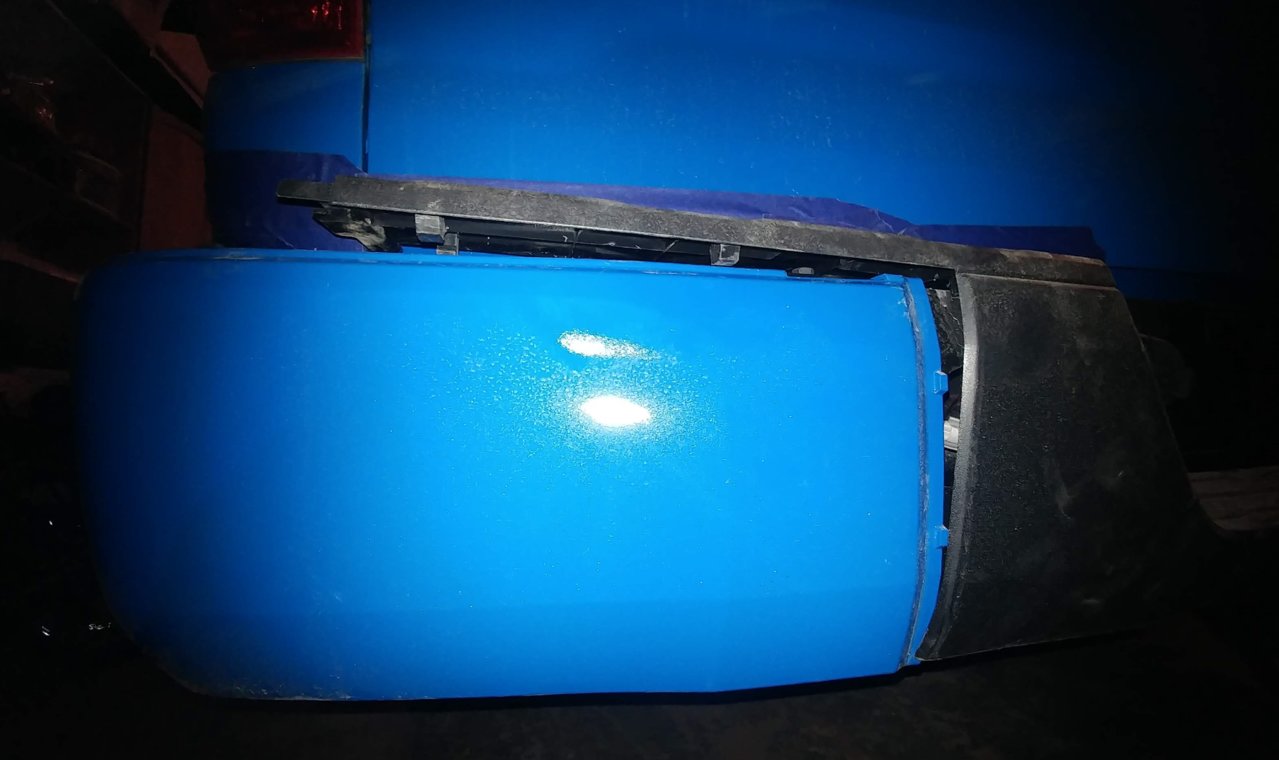

    > The above pic is with the step in place just before I torqued everything up. See the long, thin bracket top right of the pic?
    > The directions don’t tell you to remove that, but I did (only two bolts) and it made torquing the frame bolts that hold the step
    > on A LOT easier to tighten. Then just re-install.
    Definitely do that.
    Three more tips to make the install a bit easier.
    1) The instructions say to remove the corner bumper cap. Yes, you need to do that. What it doesn't say is that there are two fasteners you need to squeeze the tabs inwards from the underside. Don't just pry the cap up with a screwdriver.
    2) The instructions also say to remove the whole rear bumper cap. That is a royal pain. Lots more of those pesky fasteners to squeeze from under the car. I took a short cut, and did just enough of them so I could lift up the bumper cap and stick a 12mm ratchet wrench under it. See below picture.
    3) Getting the stock bumper bracket actually out, after you have removed the three bolts, isn't easy. It is a really tight fit. I only managed by removing a fourth bolt, so that I could move the metal bumper frame just enough to get the bracket out. The extra bolt I removed is the one circled in red. This picture was taken after I put the replacement bracket in, show with the red arrow.
    Hope that helps!
