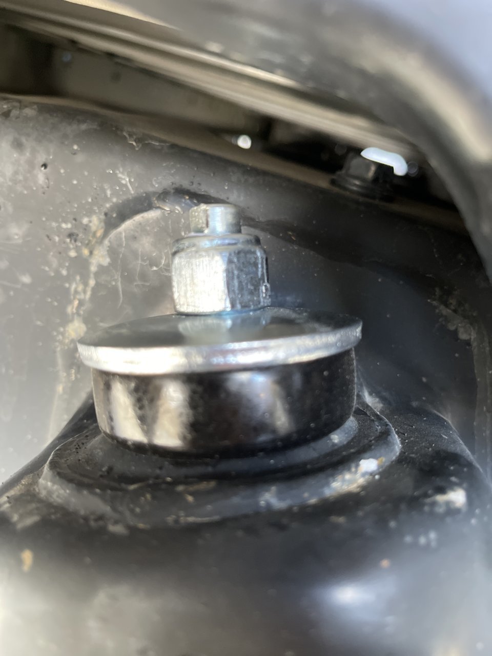

    Thanks, didn't even think to try a small wrench....I'll give it a shot! Based on your photo I have the nut higher than yours...no threads showing....

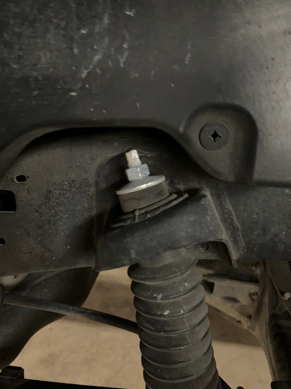

    image.jpg I’ve gotten it as tight as it will go…any wrench just slips off the top and I don’t want to mess up the top. Seems tight to me but I’m not sure it isn’t just the nylon not getting past the thread

    You need 2 wrenchs. One on the nut another on the square portion of the shaft up top

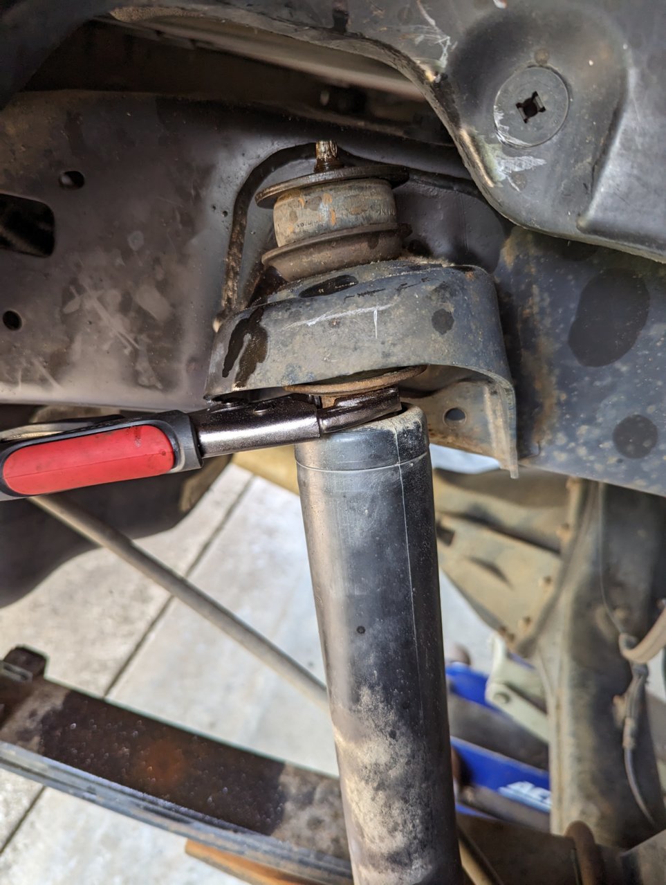

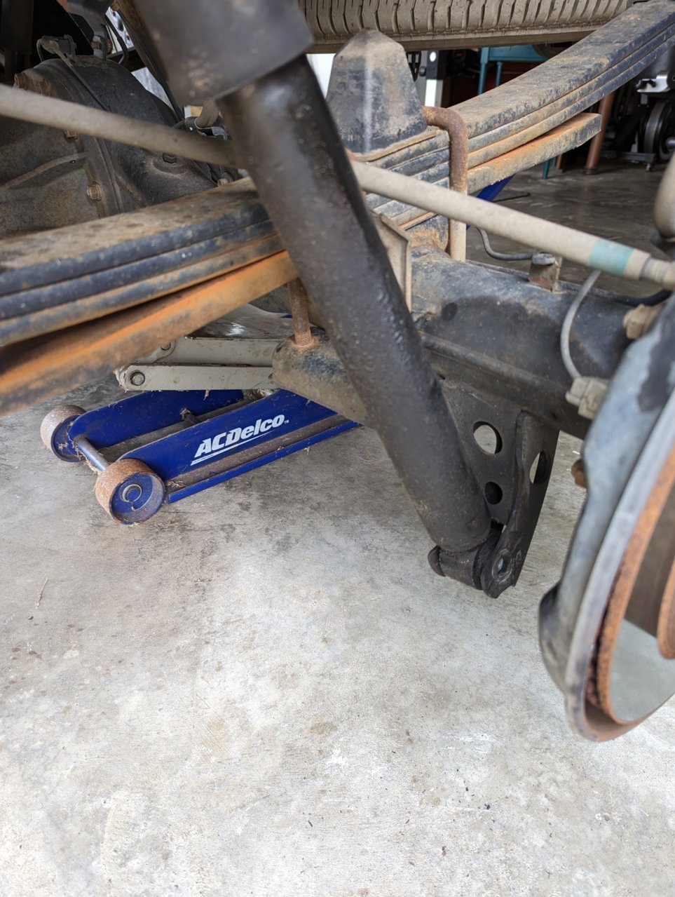

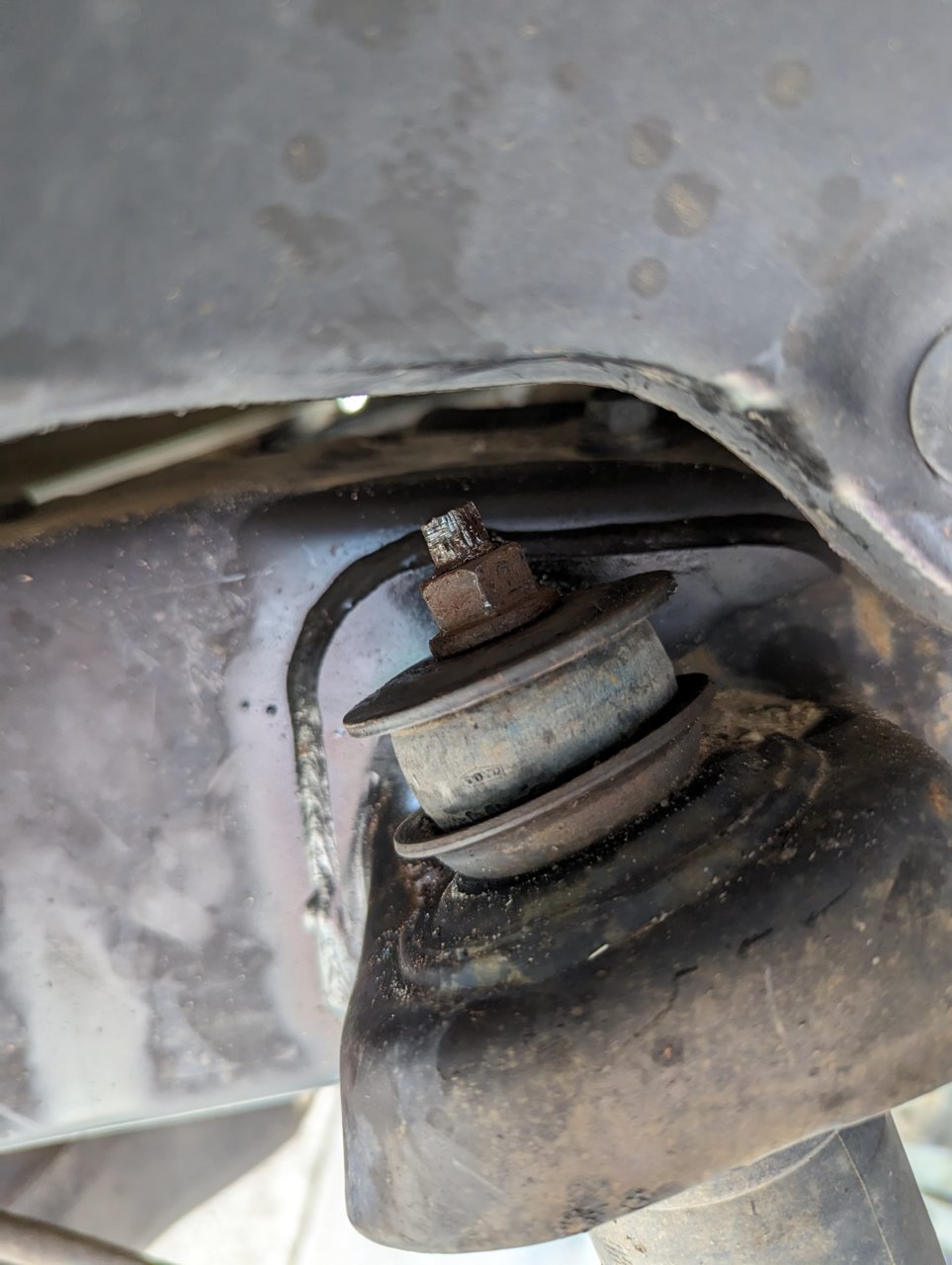

    Bump for similar question. Trying to remove old shock for a Bilstein 5160 install. I have lower bolt fully unseated and bottom is hanging free. I've been able to loosen top and have gotten this far in doing so but now can't get it off further without spinning the entire unit. I'm using a vice grip to hold the top, but as you can see I'm beginning to strip it because the nut is being so stubborn (I was careful not to clamp on the threading so as not to strip that). I used some PB rust blaster before starting the job but still stuck at this step.
    Am I missing something?

    Got it. For any future forum searchers:
    Highly recommend grabbing at this position rather than at the top. At first, this part wasn't exposed as it was covered by the plastic shock cover. I applied some downward pressure to the plastic shock cover and it opened up to another section where I could use the vise grip. Also highly recommend that as you make some progress with the nut you backtrack and go left and right a couple of times to let the rust blaster seep into the threads and loosen everything up. Each time you make progress, backtrack a touch. Applying more spray as needed during the process.
