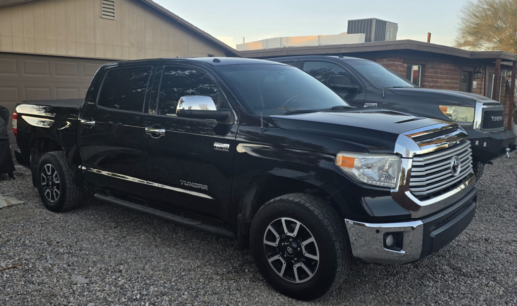

    BR73
    BR73 Tundra LIFE
    May 9, 2024
    #116620
    436
    Rick
    Talladega,Al
    2020 SR5 Barcelona Red Tundra
    L/S Grab Handle GCS AT Cooler Kit 295/70 18's TOYO Open Country AT III Bilstein 6112 / 5100 Coachbuilder Shackles 12Volt systems remote start Dasaita Android 13 CF trim / chrome delete Redline shifter boot Stillen CAI

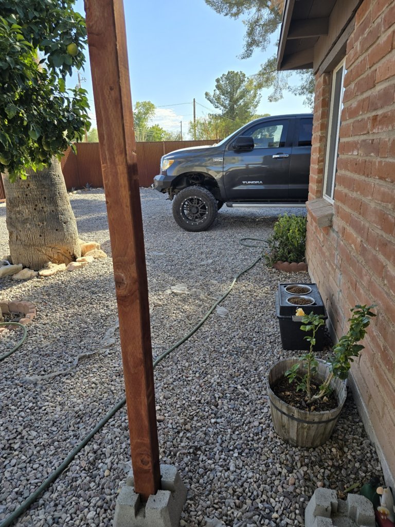

    Bought my 2020 Tundra in May and it has 295/70R 18's with a spacer and a small lift.Im not sure what all has been done to the suspension but it rides and looks nice IMO.IMG_20240504_072612981_HDR.jpg

  13. Jul 16, 2024 at 8:42 AM

    Really clean truck btw, got any pictures?

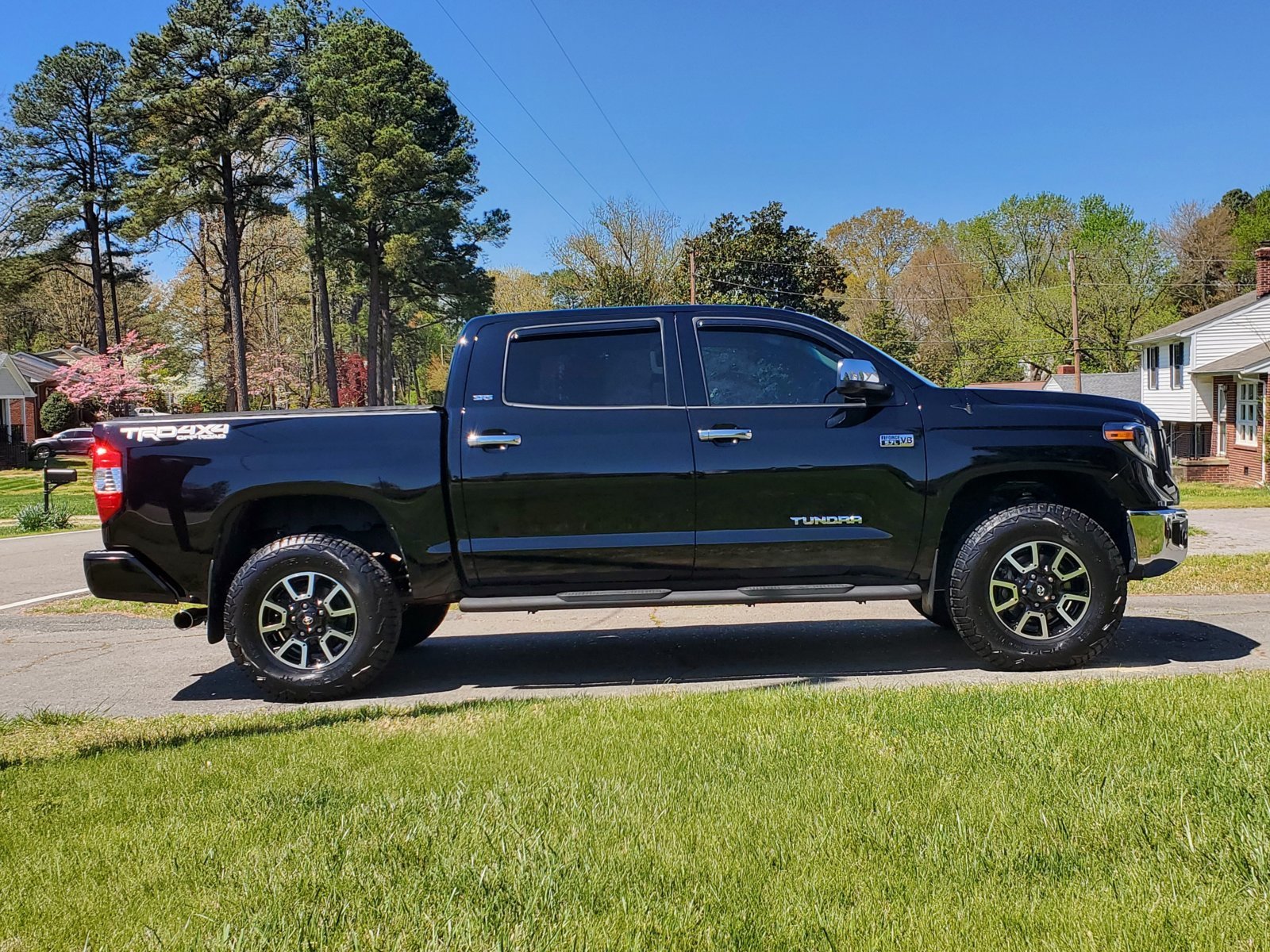

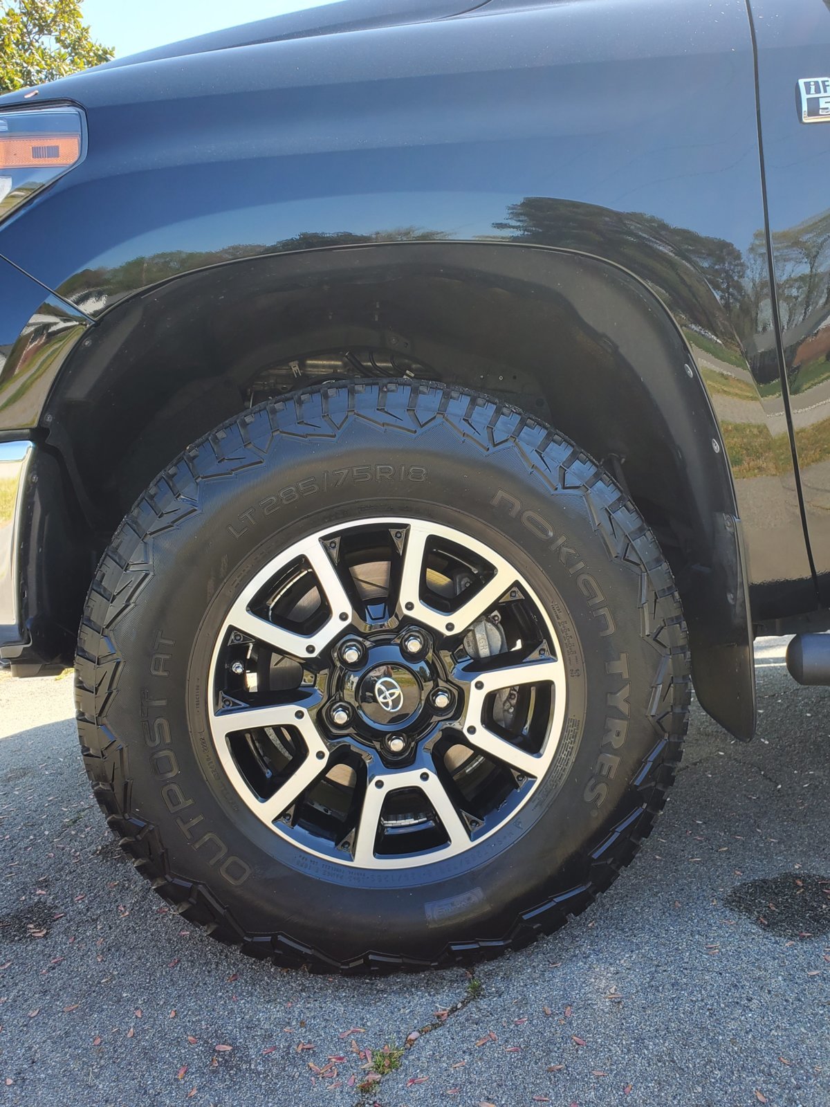

  15. Jul 16, 2024 at 9:38 AM

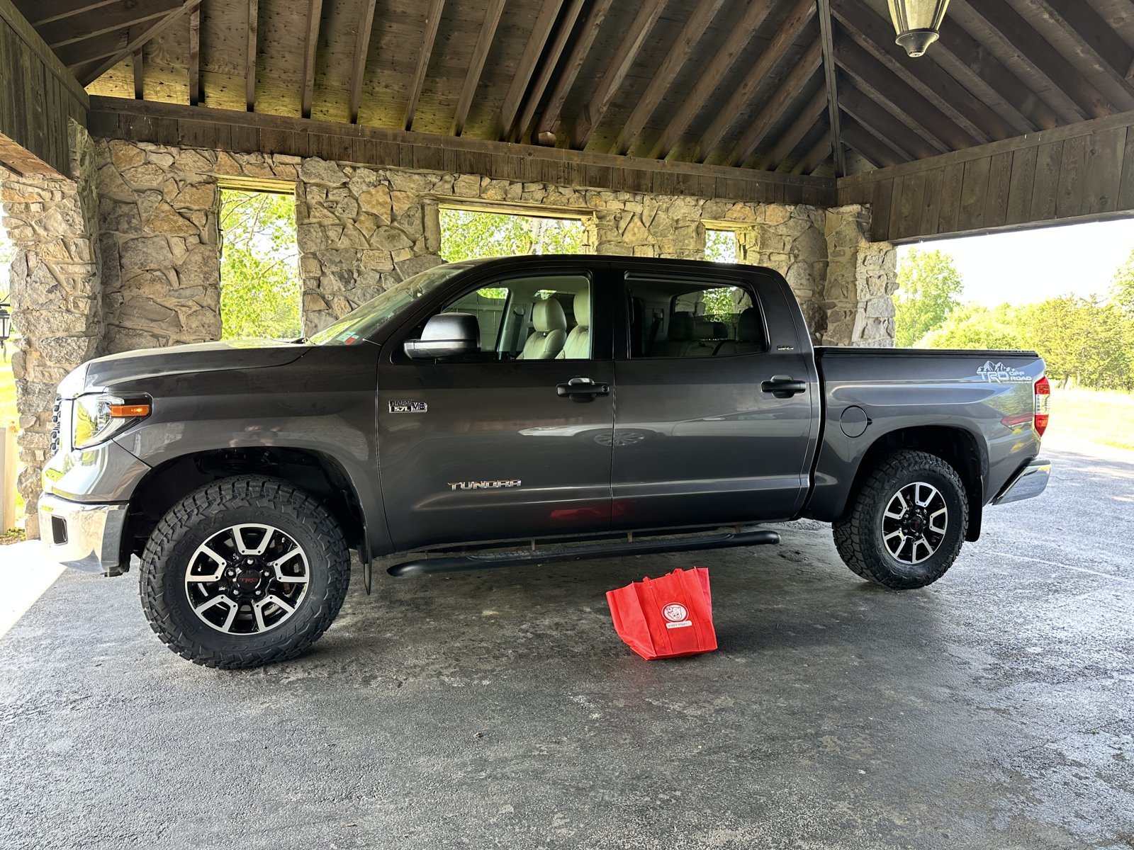

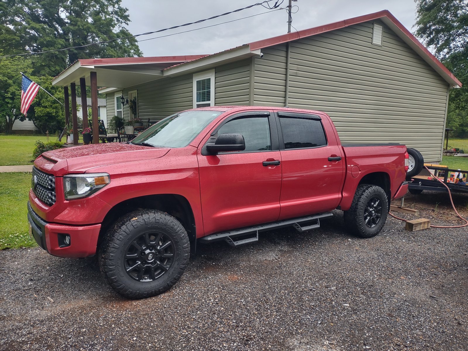

    frichco228
    frichco228 Valued Member
    Jan 9, 2020
    #40952
    5,090
    Frank
    Virginia
    2016 Crewmax 4WD, TRD Offroad
    Thanks. I try and keep her looking as good as I can for an everyday driver that I also use as a truck!
    Here are a couple of the current setup.
    2 inch lift up front, 1 in back. RAS, TRD rear sway, 285/75-18s
    PermaFrostTRD likes this.

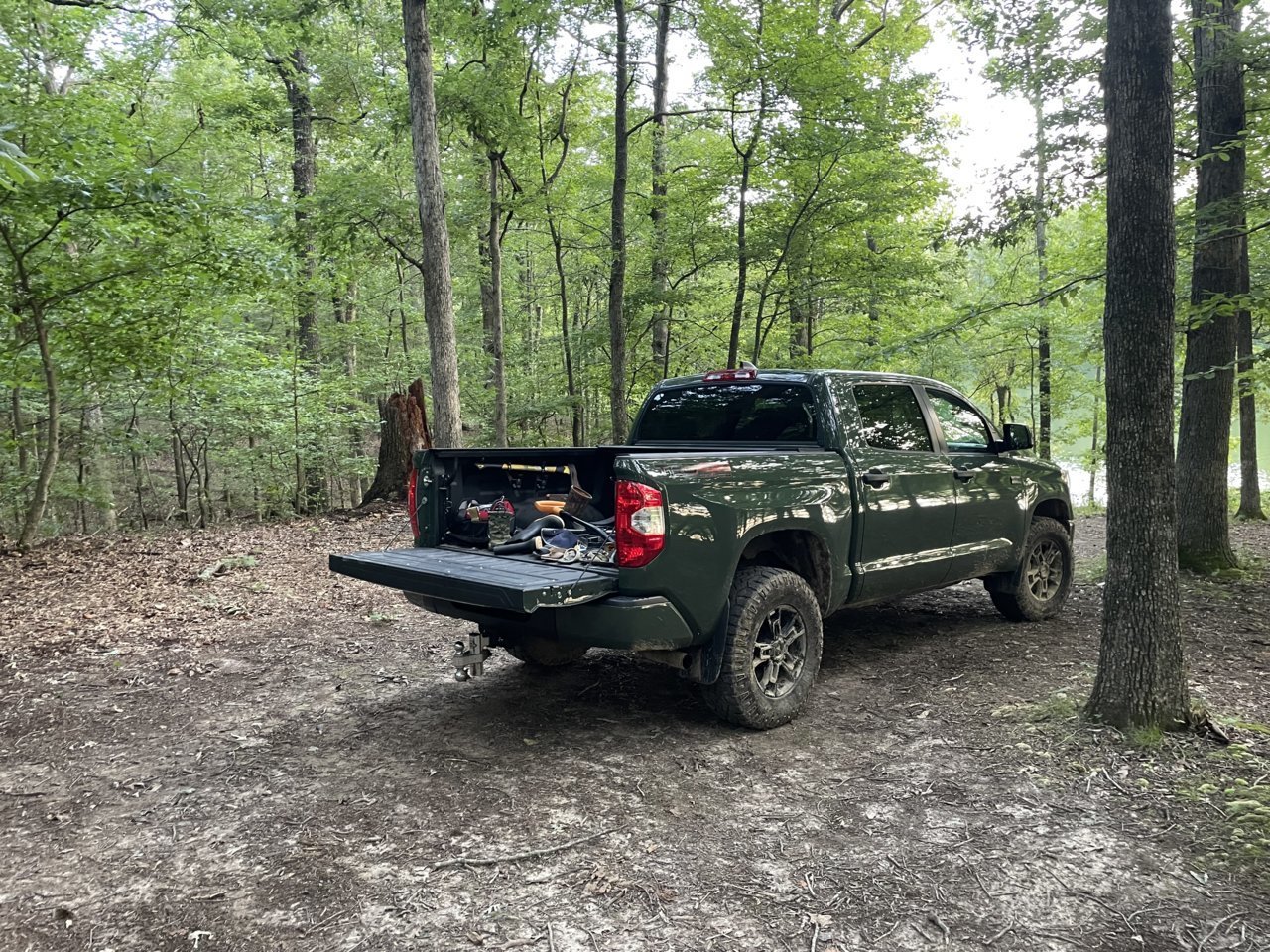

  16. Jul 16, 2024 at 10:11 AM
    Terndrerrr
    Terndrerrr 925000 miles to go
    Jul 8, 2019
    #32965
    6,123
    Music City
    6UR-FE

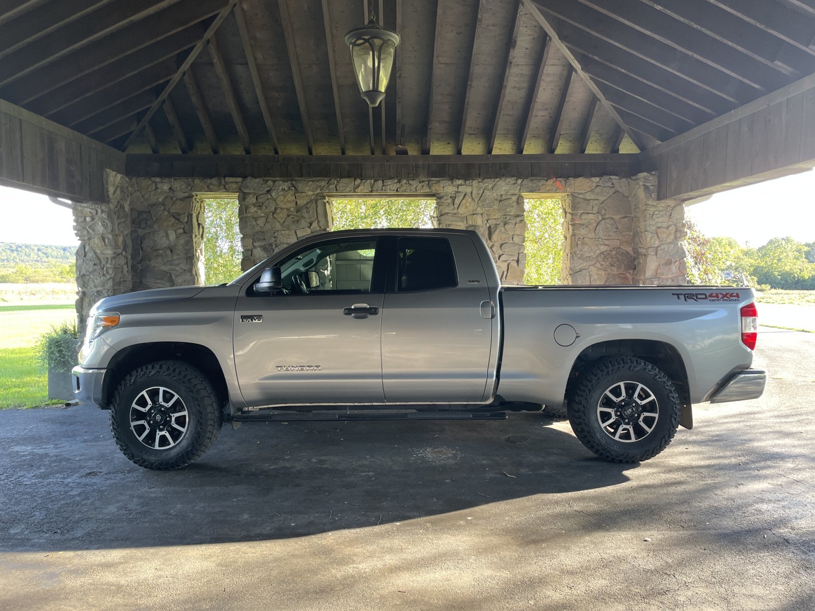

    Another vote for 285/75R18. 2" lift up front here; 1" in the rear from RAS:

    2014 DC 2” (leveled) up front, no change to rear. 295/70r18 on stock wheels no spacers. UCA was TIGHT.
    2019 crewmax 1” lift up front. No change to rear. 285/70r18. Much more comfortable with the UCAs

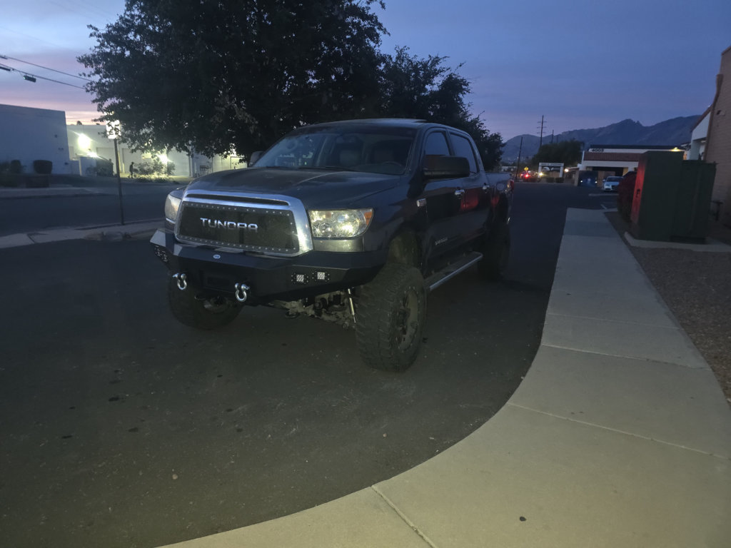

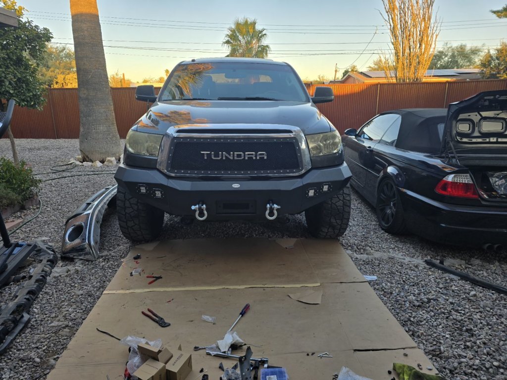

    bw1943
    bw1943 New Member
    Dec 9, 2024
    #127129
    B
    2011 Tundra Platinum
    6" Rough Country Lift 35" Mickey Thompson Baja ATZ P3's DV8 Front Bumper
    I ran spacers on my 2011 CM with a 6" lift, and 35x12.50r20 pro comp with Mickey Thompson Bajas. I like the look. People usually stop around me and wait until I move in parking lots.. sits quite a bit higher than my 2017 now...lol
