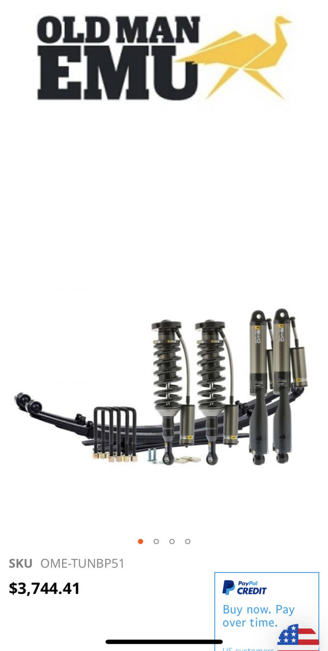

  25. Jan 5, 2021 at 11:01 AM
    #25
    Mill72
    Mill72 New Member
    Dec 20, 2020
    #56445
    92
    California
    2021 Tundra DC 4x4 TRD
    snivilous and MTRock like this.
  26. Jan 5, 2021 at 11:41 AM
    #26
    HingleMcringleberry
    HingleMcringleberry New Member
    Nov 19, 2019
    #38851
    23
    Portland, OR
    2019 Tundra Dbl Cab SR5 Offroad
    BP51 Shocks, Dakar Leafs, Icon Delta Joint UCA's, Falken WP 315/70 R17 w/ Method 703's.
    Second this. I have the BP-51's + Dakar leafs and although not cheap, they are worth the money. They also look fantastic in the wheel well of the truck on all four corners.
    Hightide and MTRock[QUOTED] like this.
  27. Jan 5, 2021 at 3:28 PM
    #27
    TundraLaw
    TundraLaw New Member
    Oct 24, 2017
    #10505
    1,222
    Northern Nevada
    24 GMC Sierra At4x AEV
    Not sure what this means.
