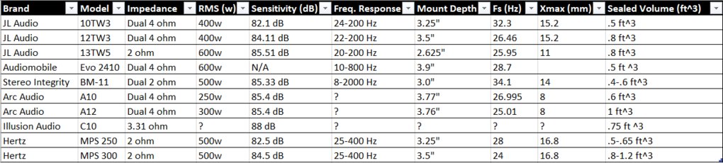

    Looking for input on the "best" shallow sub. Currently running a JL 8w7 but need to find something shallow to mount behind the rear seats of my '21 crewmax. Will build my own sealed box for mounting. Future expansion includes DSP for all drivers.
    After doing some research, it looks like a couple of the top contenders have gone under, namely the Illusion Audio Carbon line (C10/C12) and the Audiomobile Evo 2410. In a head to head I saw the Audiomobile Evo 2410 outperformed the JL Audio TW3, however the box size wasn't ideal for the JL.
    In any case, for what's currently offered, I've narrowed it down to the JL Audio 10TW3, 12TW3, 13TW5, Stereo Integrity BM-11, and the Arc Audio A10, A12.Looking to hear from anyone who's tried one or more of these subs and has thoughts.
    Overall goal is the best performer as far as accuracy/reproduction goes. I know the JL TW3's have held the crown for awhile, and for the price of one TW5 you can (almost) buy a pair of TW3's. The TW3's have around the same xmax as the BM-11, whereas the TW5 has considerably less xmax but more cone area, but from my lamens understanding xmax>cone area when it comes to reproduction. I'm open to running a pair however I don't feel I'd need the added output of a pair. Compiled the specs below even though I know specs are a mediocre indicator of sound. Any/all recommendations are welcome and appreciated.
    Edit: Originally wrote that Audiomobile subs were not available as I’d read they were having issues and didn’t see them available from many places. Looks like they’re back now, not sure what was going on.

    Added the Hertz MPS 250/300 to my table, the 250 looks like a better TW3 on paper, 100w more power handling, near equal sensitivity, response range, mounting depth, and box size with a lower resonant frequency and more xmax. The MPS 300 looks nearly identical across the board to the 12TW3.
    The most intriguing spec on the table is in the Stereo Integrity BM-11 being able to play as low as 8 Hz which seems crazy, combined with it's relatively high sensitivity.
