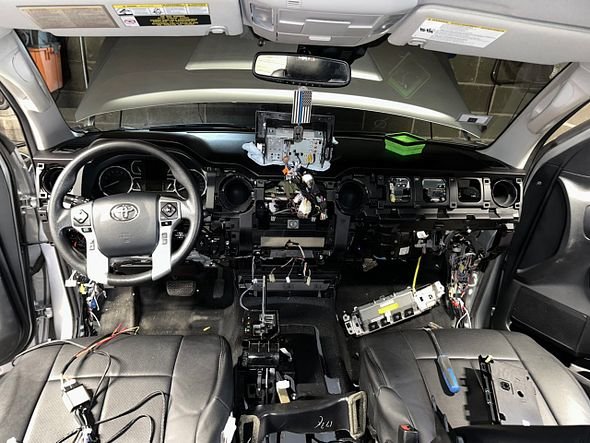

    The best way is to pull the silver surround out, but that requires this.....
    I didn't go that route.
    It took some time to 3 pair back, behind, and around the climate control years ago, but it can be done..
    There isn't much room though.
    Another way, if they are long enough, is to run them down around the heater vents and tuck them up under the console..
    You'll find a 3' HVAC duct tie-down it is perfect for fishing cable though the dash..
    [​IMG][​IMG]
